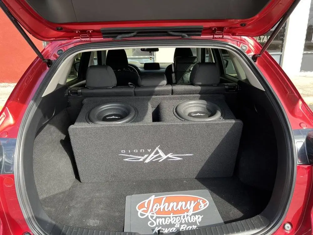

So I've recently installed 2 12" Skars and a 1200w amp (1200RMS, 1600peak). I am on stock electrical. Everything is running great right now, but I'm sure it's putting stress on the stock electrical. I also plan to add a 4 channel amp and better door speakers in the very near future, and likely 2 more 12's and up the amp to a 3500w rms.

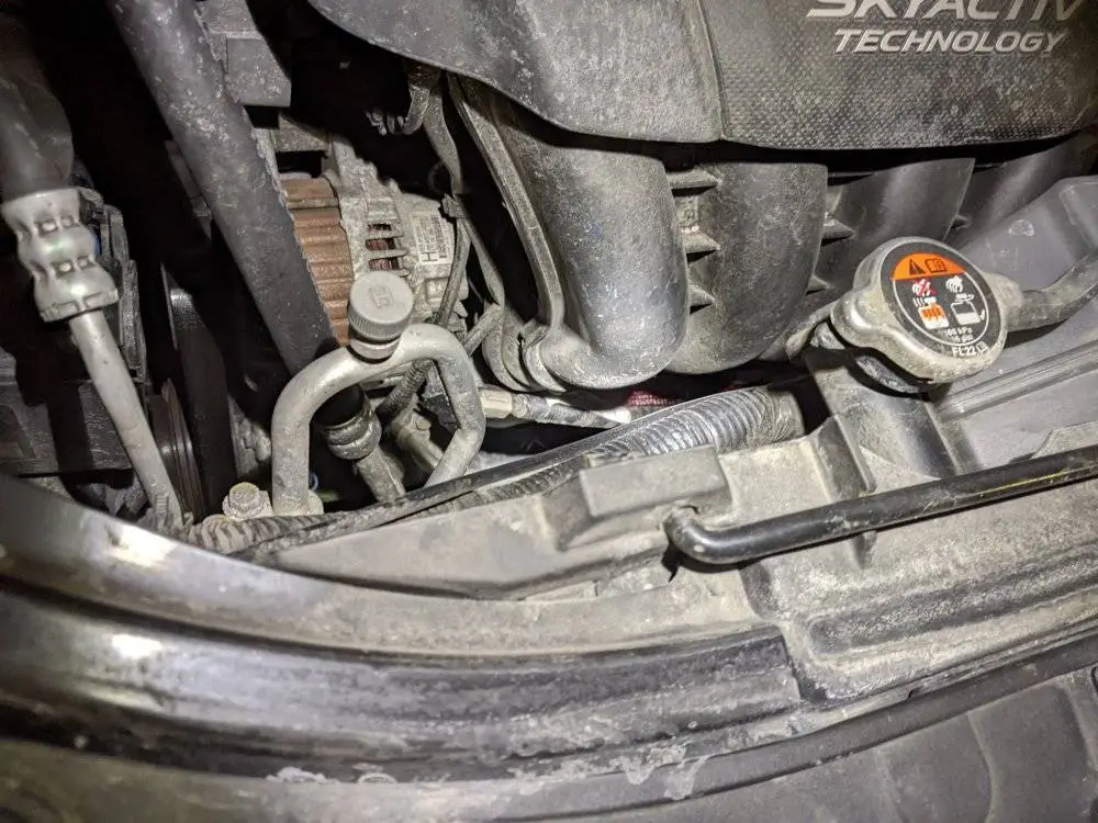

@floridaplur I just upgraded my setup on my 17' Sport. I did The Big 3, ran new power and ground, and installed KnuKoncepts Ultimate Battery Terminals. I went ahead and just did everything 0/1 AWG wire. I haven't noticed much of a strain yet, I do have a 4 Farad Capacitor on my system already, planning on adding a 2nd battery. Like you I'm planning on doing a 4 channel amp and upgrading my speakers as well. Currently running a Skar 1200.1RP amp and one 10" DDX-2 subwoofer at 1 Ohm. From what I've read and heard from my Service Tech at Mazda, the ECU is hard coded to pretty much give you the finger if you put a High Output Alternator in. Apparently it regulates the output HARD. I've read about running a 2nd alternator that isn't connected to the ECU, so, that may be an option as well.

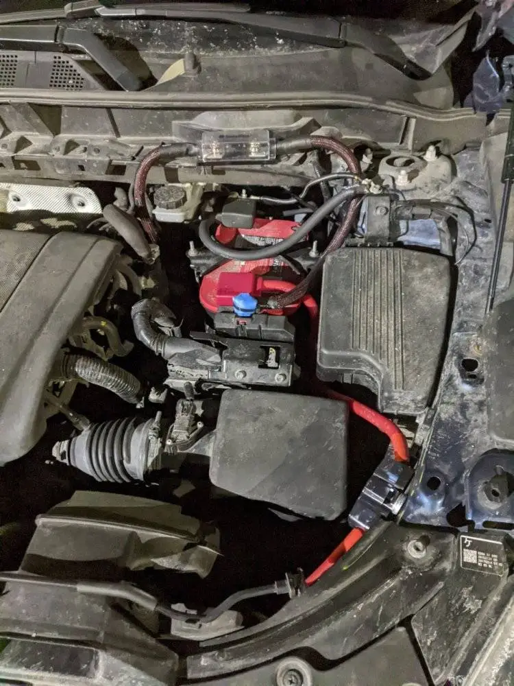

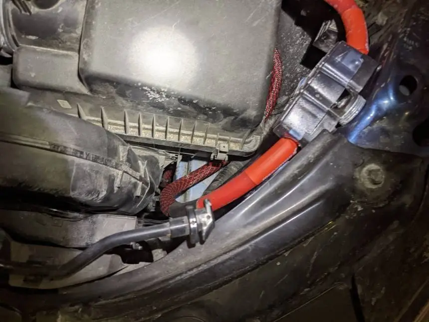

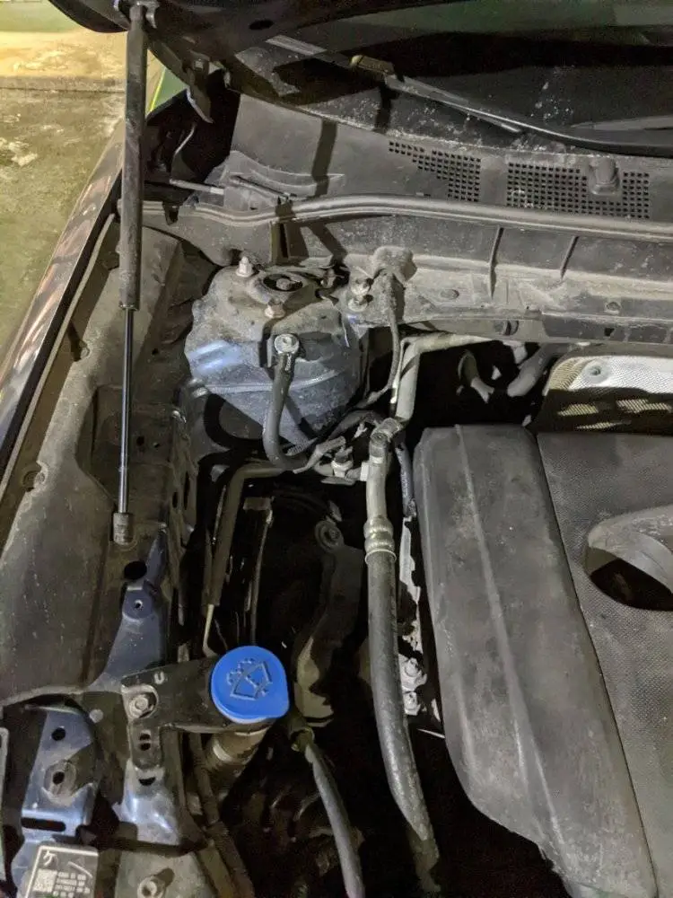

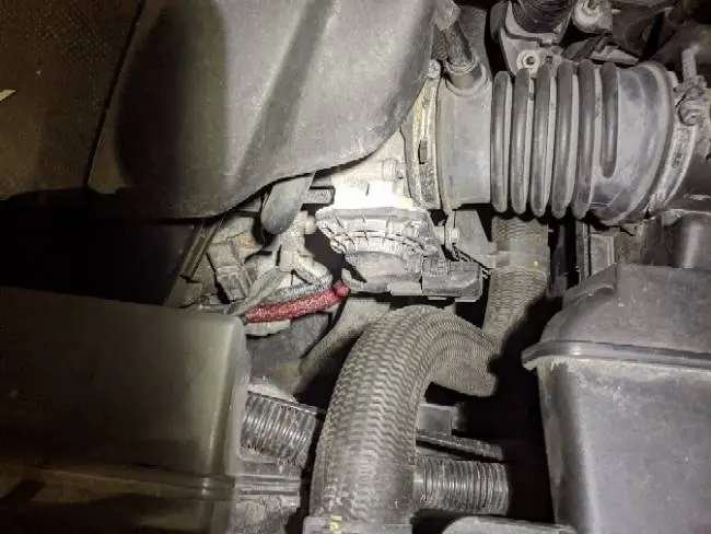

Can you post pics of where/what you accessed for the Big 3? I plan on getting 5-point grounding kit myself.
I’m also curious to see his work. I plan on doing it, but open to seeing how others have done it to see if it looks cleaner than my plan.
well, the majority of it is hidden, I honestly ran everything where the stock wires were. The Alternator wire goes to a fuse then under the air box to the battery, Ground wires are in the exact same place as stock. I put about 600 bucks into my sound system this time around between as far as Wire, Subwoofer, Amp and miscellaneous parts. So, I wanted to try to do the cleanest install I could.

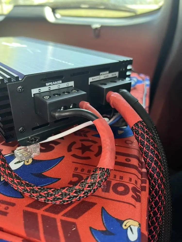

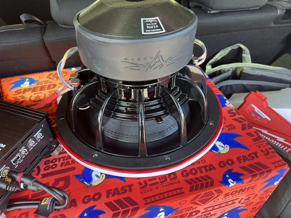

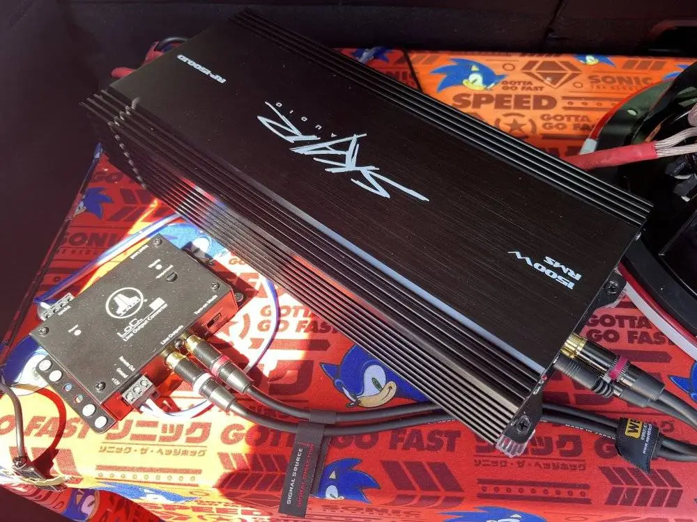

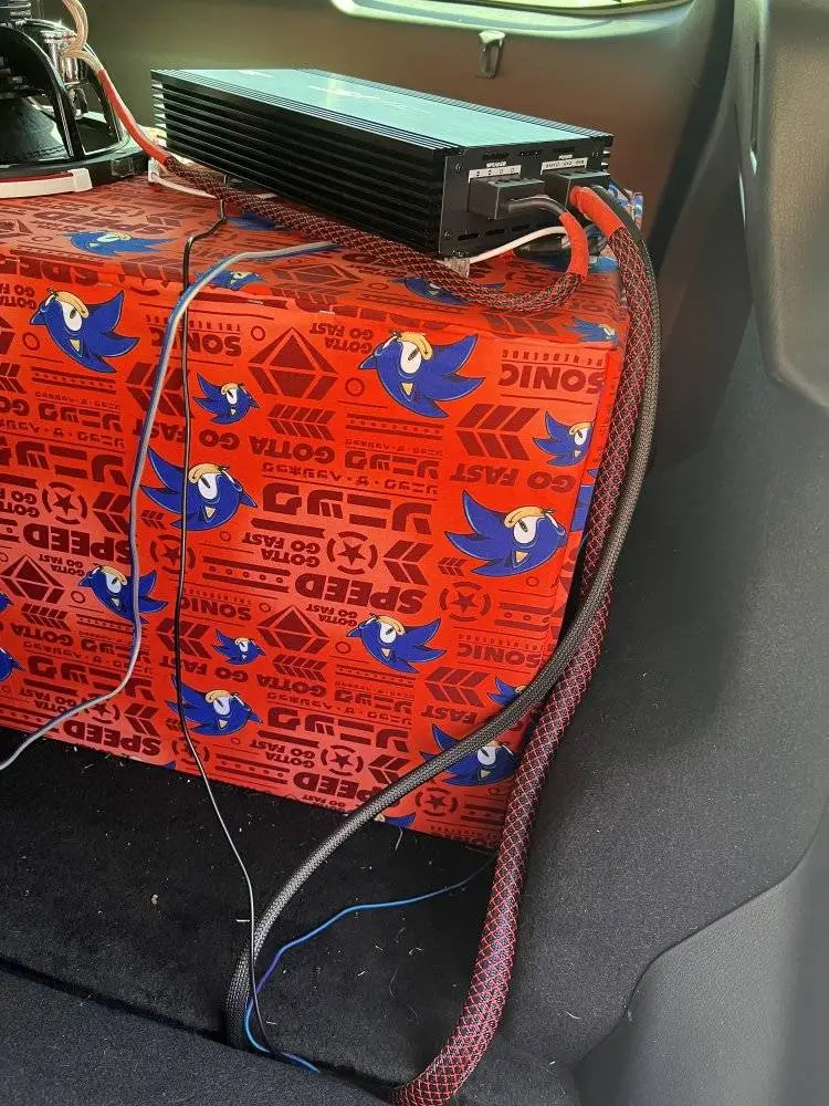

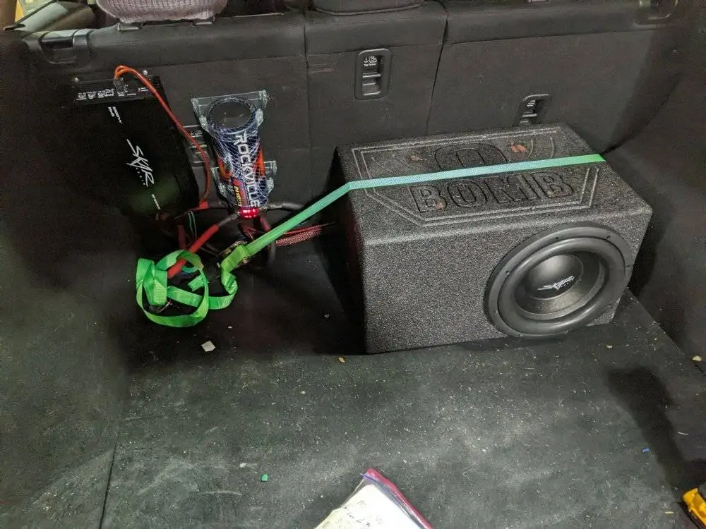

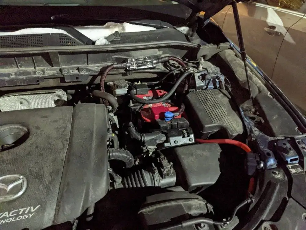

The install has actually been done for awhile now. Everything was done correctly and stock electrical actually takes it much better than I expected. Everything is tuned properly, and at its hardest hitting moments I’m dropping to about 12.6V with a standard around 13.2V now. 13.6V with stereo turned down. I’m actually planning to go bigger now, so will be doing the Big 4, as well as a second run of power and ground wire, as well as an AGM under the hood and a small lithium bank in back. Plan is for 2 15”s of this same sub on a Taramps Smart3 (true 3000 rms).
I guess you ignored the "Do not mount amplifier to the subwoofer box" sticker.
