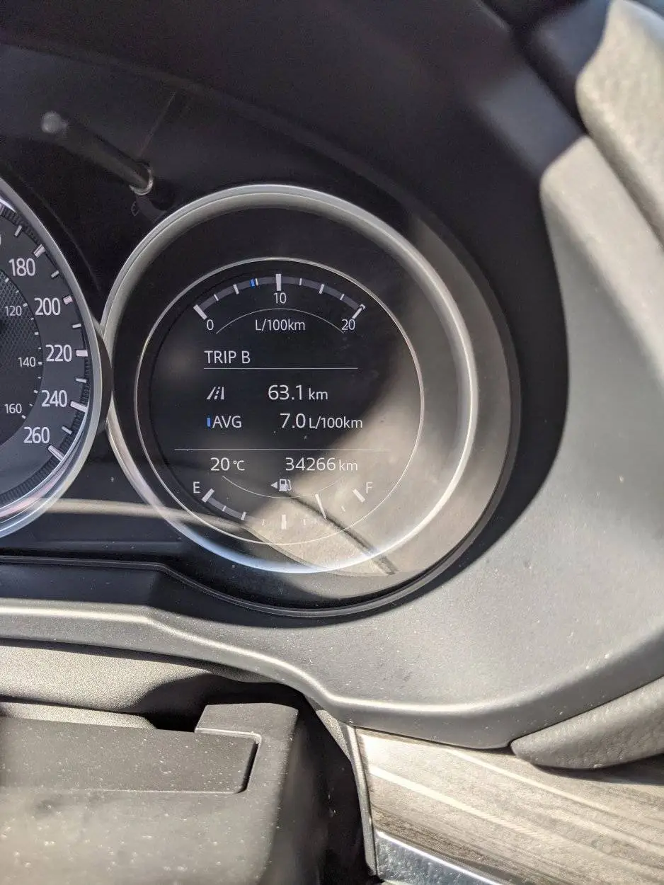

With my 2018 GT AWD (2.5 L NA engine), I get between 9.0 to 9.5 L/100 km (26.1 to 24.8 mpg) and I drive 85% city.
On a recent road trip I hit 7.0 L/100 km (33.6 mpg). This was on a windy highway, called the sea to sky Highway in BC, Canada and I didn't use cruise control at all.
