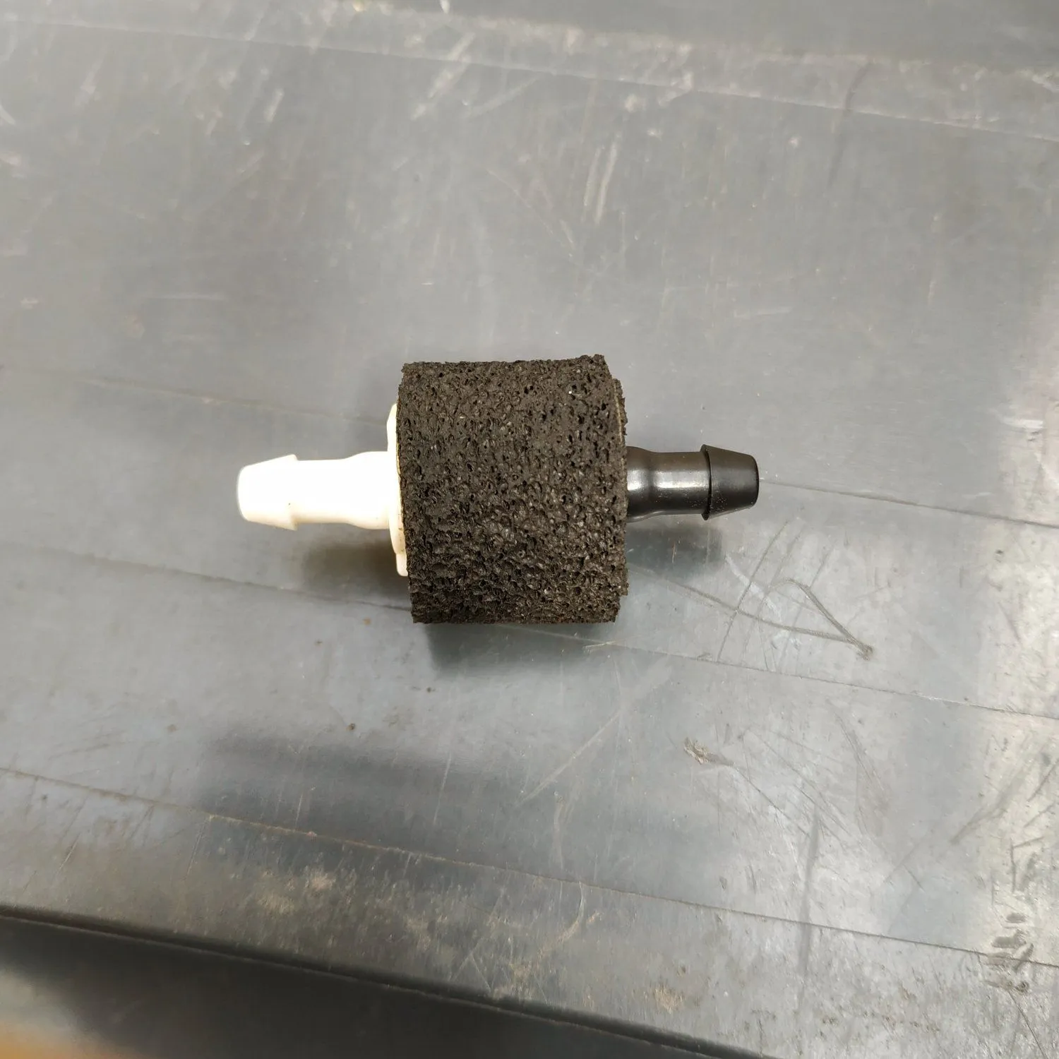

This is the old one, wrapped in protective foam.

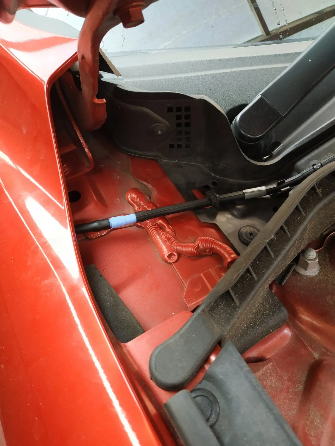

This is the replacement (in blue). It's not a Mazda part, just a generic one I find by searching eBay. 'screenwash no return valve 4/5mm pipe'.
Also, I don't think it controls front/rear, as it's right by the front windscreen, not long before the jets.
Yes, it’s not the valve I thought it’d be. And thanks for posting pictures!
