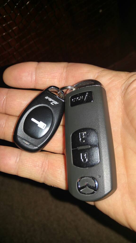

This is my aftermarket remote.
Sent from my VS990 using Tapatalk
I opted to purchase the idatastart HC2 and got it professionally installed. Smaller remote than OEM and has takeover mode so the engine does not shut off when the door is opened. If the key is not with you once you put your foot on the brake, it will shut the engine off. The only downside is rear defroster cannot be enabled from the remote. My installer was really surprised that this product worked so well. I paid ~$200 for the hardware and $200 for labor, overall really pleased with this remote starter system.
