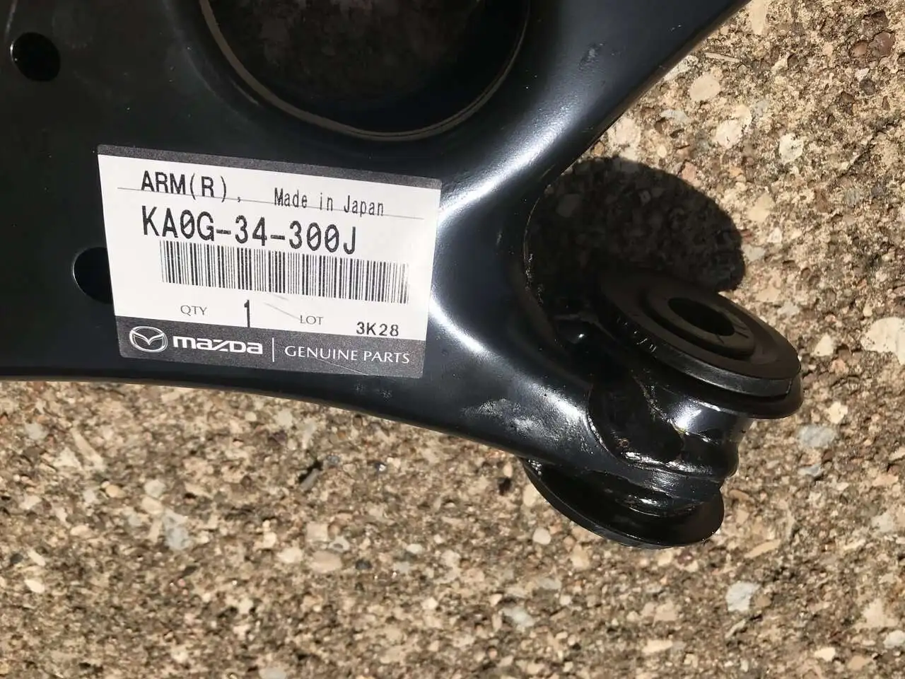

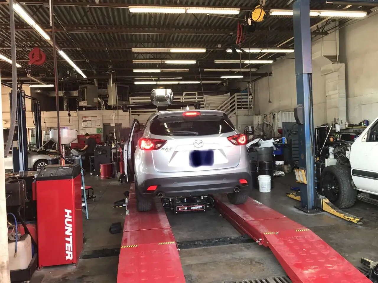

I went to Brakes Plus to replace the right front LCA which got bent by a hard hit to the curb. As mentioned I paid $285.22 for an OEM LCA from my Mazda dealer with 20% off from MSRP. Took it to the shop and they suggested to install a front camber adjustment bolt just in case and it costs $50. The labor to install the LCA is $250. The 4-wheel alignment is $89 (it was $69 last time when I put on the new Radar Dimax AS-8 tires in Sep. 2021). Yeh labor rates are going through the roof if you want to pay for something done!

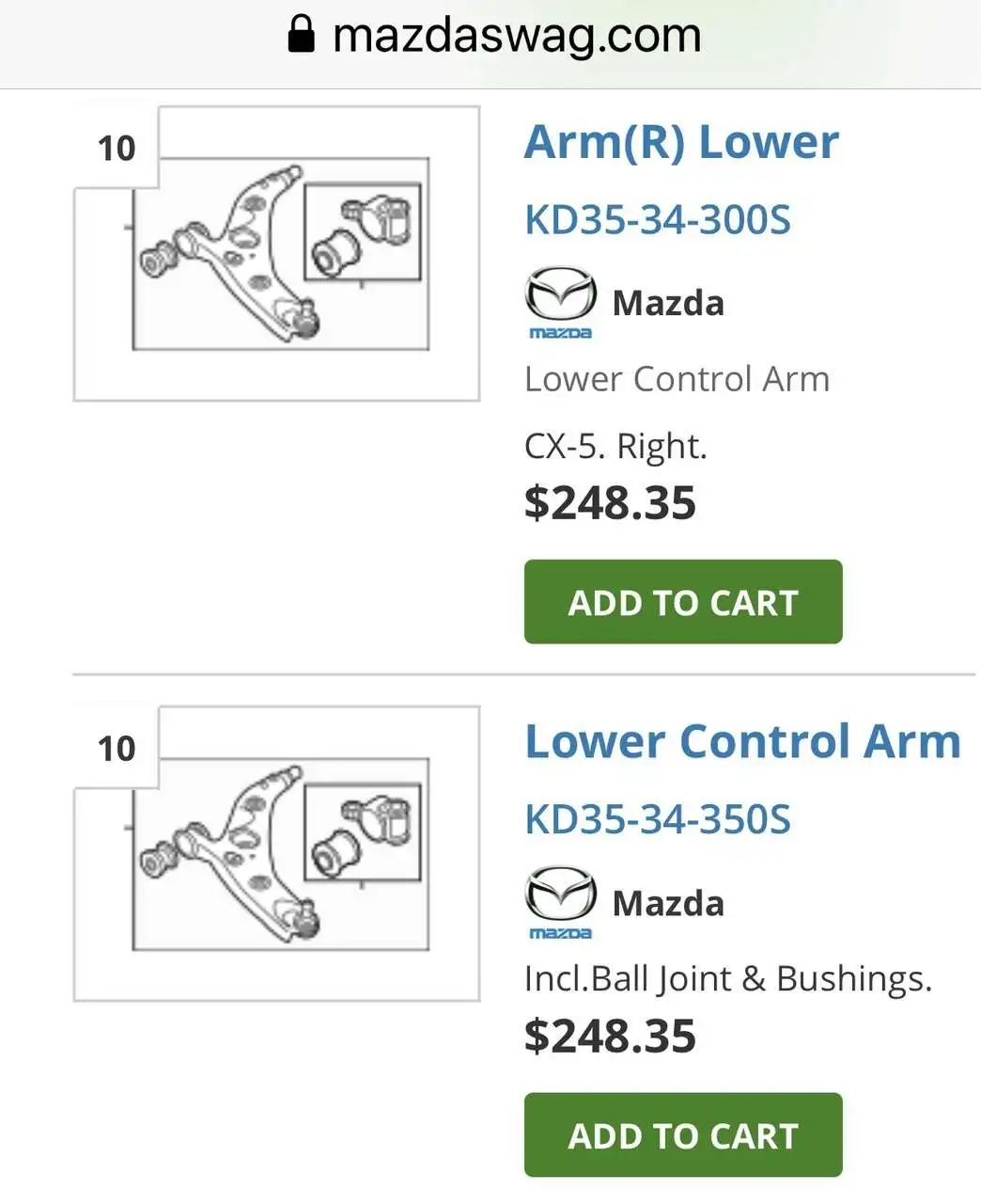

Apparently Mazda uses different front LCAs for your 2014 CX-5 and @madar‘s 2016.5 and my 2016 CX-5. The part numbers on your front LCAs are KD35-34-350S / KD35-34-300S and ours are KA0G-34-350J / KA0G-34-300J L / R.
For the price, I paid $285.23 for a right LCA which is 20% off from current MSRP $356.52 and it’s the same as @madar’s. You paid $165.15 each on 9/2/2022 from MazdaSwag and look at now how much higher they are from the same seller:

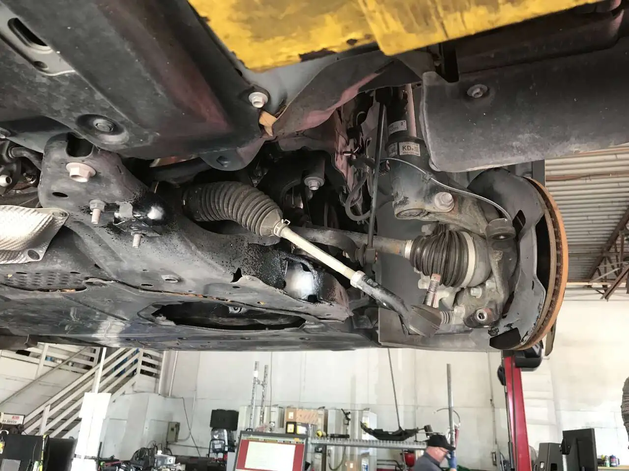

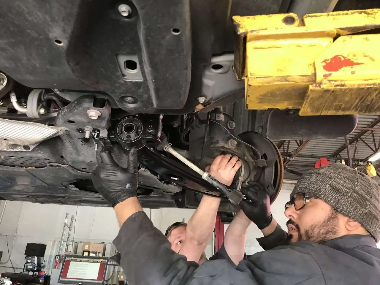

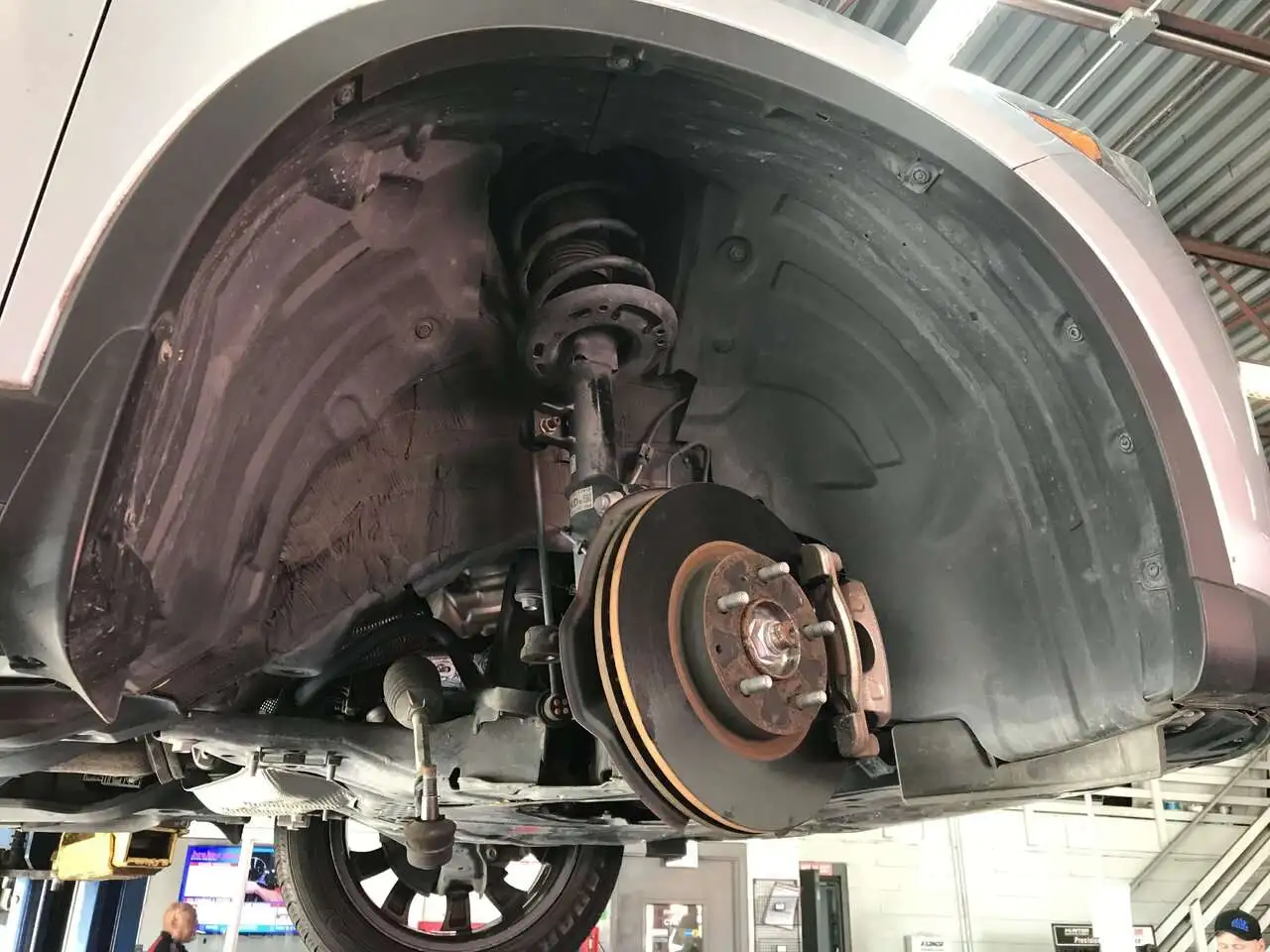

Wow, I just had a similar accident several weeks ago on my 2016 CX-5 GT AWD hitting the curb hard and bent the passenger side LCA at the ball joint area and damaged the ball joint too. Luckily the CV axle seemed fine. I got an OEM right side LCA and had the Brakes Plus to do the replacement and 4 wheel alignment. Usually I’d like to DIY for such task (not the alignment of course), but after I read @RedBaron‘s write-up replacing the LCA and decided to let the professional do it fast (they finished the whole job in 3 hours after I got the OEM LCA from my Mazda dealer, whereas it’d take me may be a couple of days only to replace the LCA) and wife can drive the CX-5 ASAP.
Wow thanks for the great pics .. seeing it up off the ground like that is really helpful...
Im trying to work my way through the issues the impact caused ... I changed the wheel bearing hoping it would solve the problem , (wasnt really that difficult )and have been driving , it is better than it was but really think Im going to have to change the axle also (tight turns I can hear a popping sound )
I assume you had also changed the LCA since it was bent? What is the condition on your CV axle after it got ”taken out” other than the popping sound on tight turns?

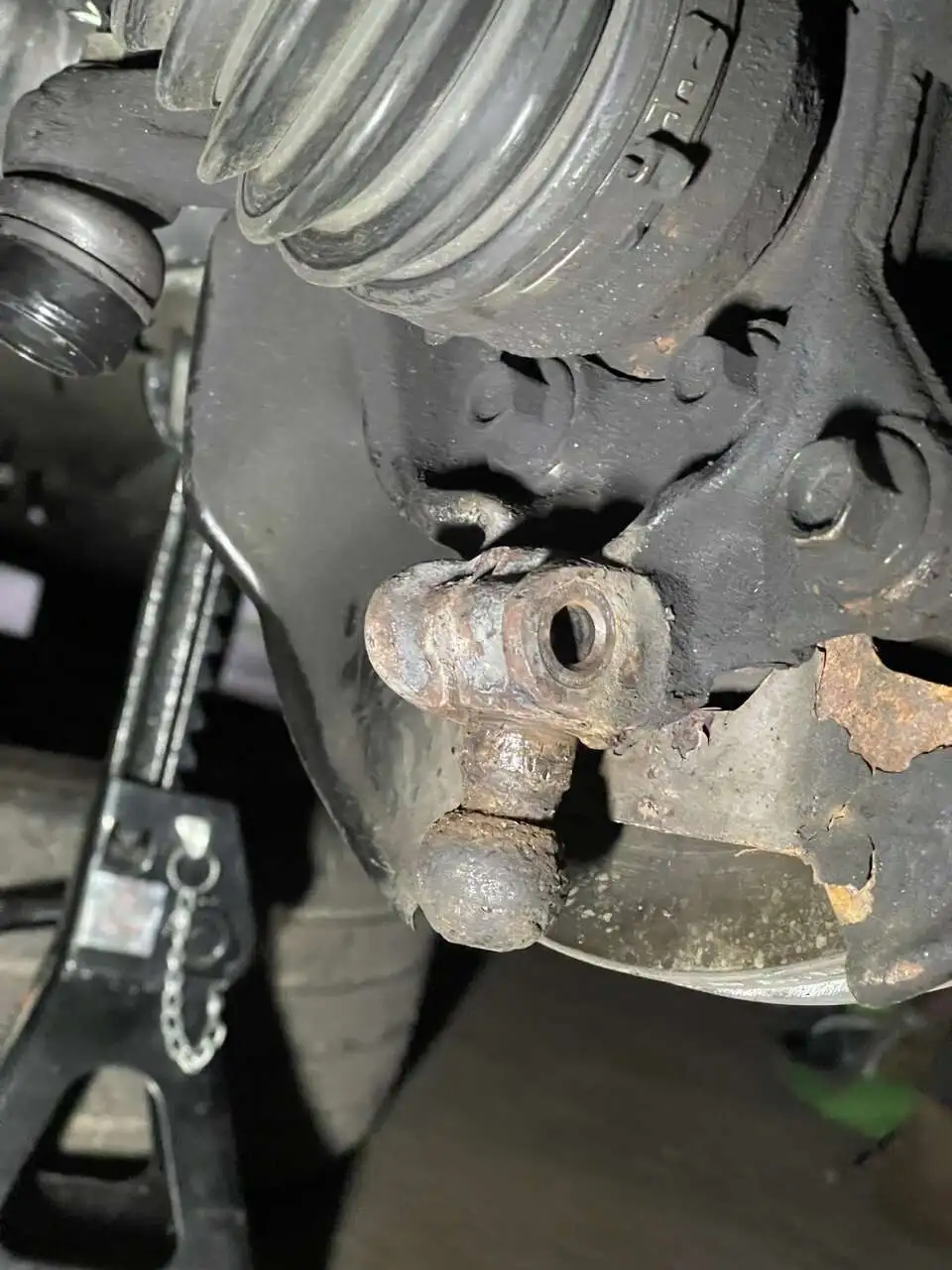

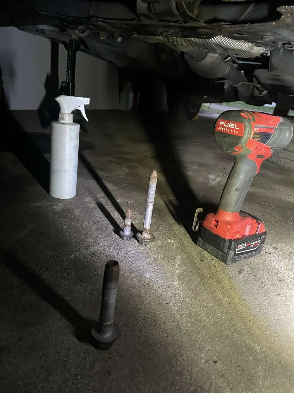

I took on the job. If you live in the rust area… prepare for a fight. Def need a torch.
Took about 6.5 hours to take it all apart over two days.
The driver side control arm with the bolt near the transmission was something. Need a shallow socket and a breaker bar and lots of 1 click turns if you’re on jack stands as there is not a lot of room. But doable. My 1/2 in M18 Milwaukee with swivel socket and extension did nothing. Breaker bar did it.
For anyone looking for reference:
Two end bolts are 14 x 1.5
Front bolt is 16 x 1.5
Bolts looked like there was red loctite but can’t find info. Does anyone know?
And if you get ball joints out of socket like I did and rusted in there … prepare for some cooking, banging and punching. Ball joint separator is helpful. So is various punch sizes.
Pinch bolts (both) were seized and threads looked gnarly so I’m glad I bought new.
I used evaporust bath + thread dies to clean the control arm bolts.
Cheers

⋯ Bolts looked like there was red loctite but can’t find info. Does anyone know?
I’ve seen many new OEM bolts pre-coated with reddish Loctite used on critical locations.
Cheers
