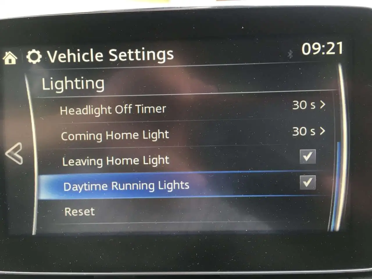

Yes I wish Mazda can use the infotainment version they put on the Toyota Yaris iA which is a Mazda2 in disguise to set the DRLs on and off easily:
But there’re a couple of other ways to turn the DRLs off on US Mazda CX-5’s but they’re more complicated.
My '24 MX-5 has that. Tested it yesterday, and it doesn't work. No change whether checked/unchecked.
Yeah, my CX-50 has the setting too. If you disable DRLs it turns them off if you're stopped, but as soon as you start driving, it turns them back on. Really Mazda? Why have a setting if it's ignored?
That’s really strange. If I uncheck the “Daytime Running Lights” selection on my 2018 Toyota Yaris iA, the DRLs will be off, and the selection keeps unchecked forever until I recheck it again and turn the DRLs on. Mazda definitely has this version of MAZDA CONNECT Infotainment system like my Yaris iA and they should use this version for all Mazda’s to keep it simple controlling DRLs.
