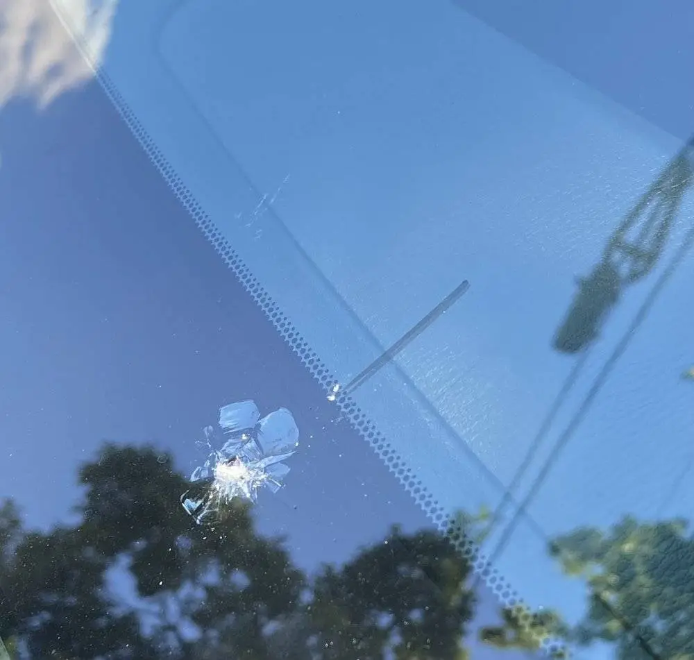

Our lovely highways in MA are full of debris and #$% all around. Coming down on I95 Southbound an outta nowhere stone rested on the windshield. Went to Safelite and the OEM it's covered with deductible. Do you guys trust Safelite? I know once you replace Mazda windshield a lot of stuff gotta be recalibrated so I wonder.. Do they own those Mazda codes or do I need to stop by the dealership to re-calibrate once installed?
Here's the #$%

seems 2x hit. is this a crack at the upper part?
otherwise if no crack its usually repairable. I got the same one like the one at the bottom and fixed it easily.

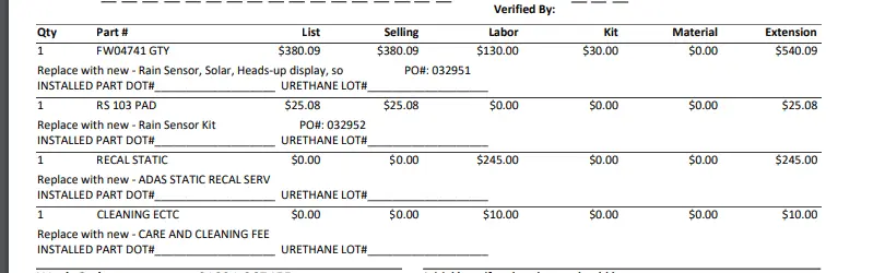

I'd like to understand better the difference between OEM and aftermarket replacement. I have very similar damage, but then a crack propagated 7 or 8 inches from it to another edge.
I have an appointment with Safelite tomorrow morning. I just realized I could download my invoice. Looks like aftermarket:

It's on the lower driver side right a little above the vin number. Btw they just called me saying Progressive can't honor the OEM because I don't have the OEM Endorsement!?!? lmao!.
I went in to check if it could be repairable but the person said the damage was too deep into the layers and indeed the OEM part was really good as to contain the damage. He told he they would fix it but just the hit itself was deep enough, plus the subsequent crack.
non oem especially with the HUD is big hit and miss. The oem with HUD and heated wipers is in the range of 800$. (not accounting for discounts which can go up to 40%). I wouldnt do it with non oem if it was me.
The thing is you wouldnt know before they change it then its too late.

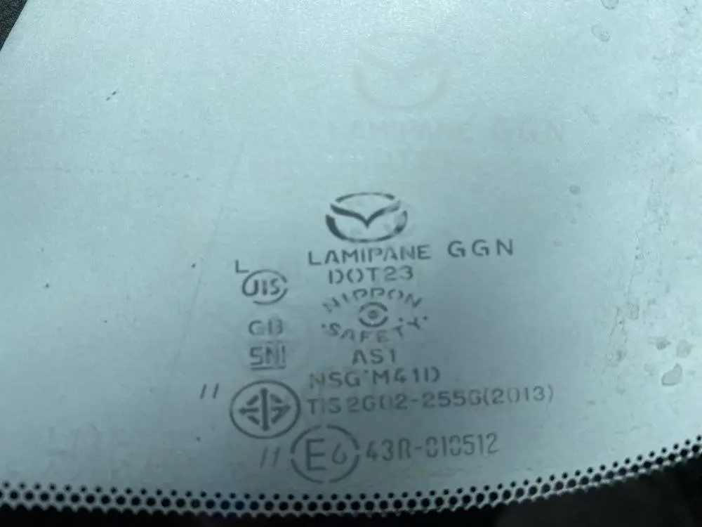

I got aftermarket glass today. Everything seems to work so far. There is a bracket for the rain/light sensor. The only issue I had was that silicone pad surrounding it didn't seal very well, had a bubble. He adjusted it while I was there. It was 100 degrees out.
There may be more internal reflection or glare, or I may be imagining it on a really hot, sunny day.
Thank you for the update.
I am curious what is the name of the manufacturer? Should be written at the drivers side, at the bottom of the windshield.

The windshield in the picture is Mazda OEM windshield made by Nippon Sheet Glass Co. Ltd., Osaka, Japan (DOT23). LAMIPANE GGN says it’s laminated.
The windshield in the picture is Mazda OEM windshield made by Nippon Sheet Glass Co. Ltd. (DOT23). LAMIPANE GGN says it’s laminated.
Yep. Thats the oem.
Assuming thats the one that has the chip on 'BushWickz' car.
