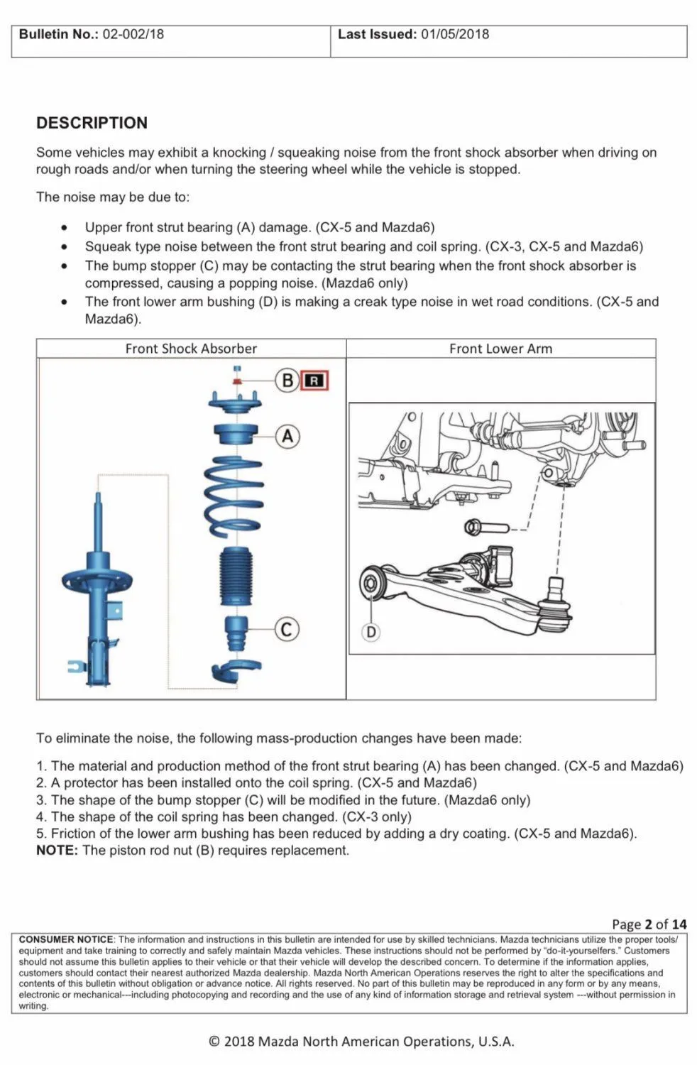

If you still have new car warranty, you should take your CX-5 to a Mazda dealer checking it out. The noise should be from suspension.
There’re multiple issues which may cause front suspension noises on gen-2 CX-5. Check out this thread and the TSB 02-002/18:
Click/ Clunk/ Knock sounds 2018 CX 5 AWD
Upvote 0
Thanks for the response! I will take it into the dealer. I am not sure it's the suspension though, that thread indicates that it only happens when going over bumps or corners, while my noise happens primarily when accelerating (not sure that would indicate the suspension).

Not much stuff under your seat which can make noise. Bring the TSB to show your dealer that should help them to find something.

Make sure to show the TSB to your Mazda dealer and ask them to check those items mentioned in the TSB.
