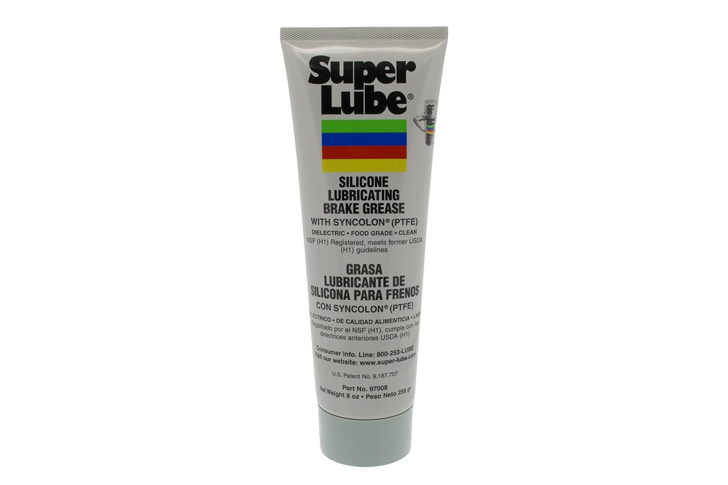

I‘ve been using AGS Sil-Glyde brake lubricant for caliper pins. But why this Super Lube is food grade and meets USDA guidelines? Is it edible?the service manual says to use a rubber grease for the caliper slide pins and a different grease for the pads. I used this for the pins

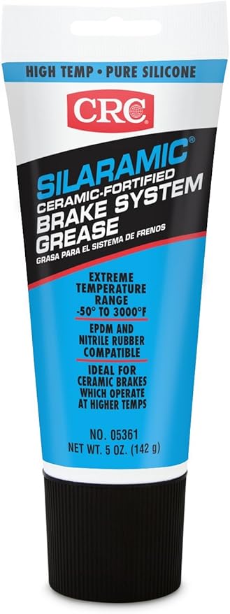

https://www.amazon.com/dp/ (commissions earned) doesn't appear to be silicone. The description says " A synthetic, dry-film, ceramic lubricant ".SuperLube and SilGlide are good with a 425 degree threshold. I still have a bottle myself. I highly recommend to switch to CRC Silaramic with a 3000 degree threhold. I got a bottle at Autozone.
Silicone Grease like above = lubing the caliper pins. Why? So calipers can move freely in and out squeezing and releasing pressure of pads unto rotors. Cause of issue = that grease is either too minimal or burnt off (hence why I recommend higher heat threshold). Why silicone? Because silicone is safe on rubber o-rings and other rubber parts on the pins. Other types of grease WILL wear out the rubber parts and cause them to expand.

Sounds like an impressive product. I have a lifetime supply of brake job lubrication materials, but still may need to buy this next time.CRC SILARAMIC is formulated with pure silicone and a blend of ceramic and proprietary lubricants, and contains the latest corrosion, extreme pressure and oxidation additives. It dramatically reduces brake noise, prevents disc brake squealing and chattering, and silences calipers. SILARAMIC has an extremely wide temperature range of -50 degrees F to over 3000 degrees F (-46 degrees C to +1649 degrees C) which makes it ideal for all types of brake materials, including ceramic brakes which operate at extremely high temperatures. It offers unsurpassed protection in both wet and dry conditions and will not melt or run off onto the friction pads or rotors.
Compatible with Brake System Rubber and Plastics, Including Nitrile
Its a high temp silicone grease (so safe for rubber) intended for ceramic brake pads. Why should you use this when using ceramic brake pads? Ceramic brake pads get really hot AND don't absorb that heat like metallic pads. Therefore that heat transfer to the rotors and other brake components........like the pins in calipers.
Plus it even says pure silicone on the bottle's top.
CRC Silaramic brake grease should be a good product as a “rubber grease” for caliper pins / guides. I use Sil-Glyde like many others which should be similar to CRC Silaramic.Sounds like an impressive product. I have a lifetime supply of brake job lubrication materials, but still may need to buy this next time.
But I object to the marketing on the tube. They shouldn't be able to say "Pure Silicone" unless the tube contains 100% silicone.
What is that supposed to mean. One of the ingredients is silicone and that silicone is unadulterated, until we add other stuff and blend and process it?
