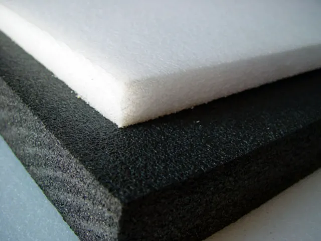

I bought some of this and cut a piece to cover the entire rear and cargo area with the seats down.
I use a small piece of thin plywood to extend from the seatback forward. It slides out from under the mattress which gives it support.
The link doesn't show the selection but I got a 108 x 48 " charcoal.
