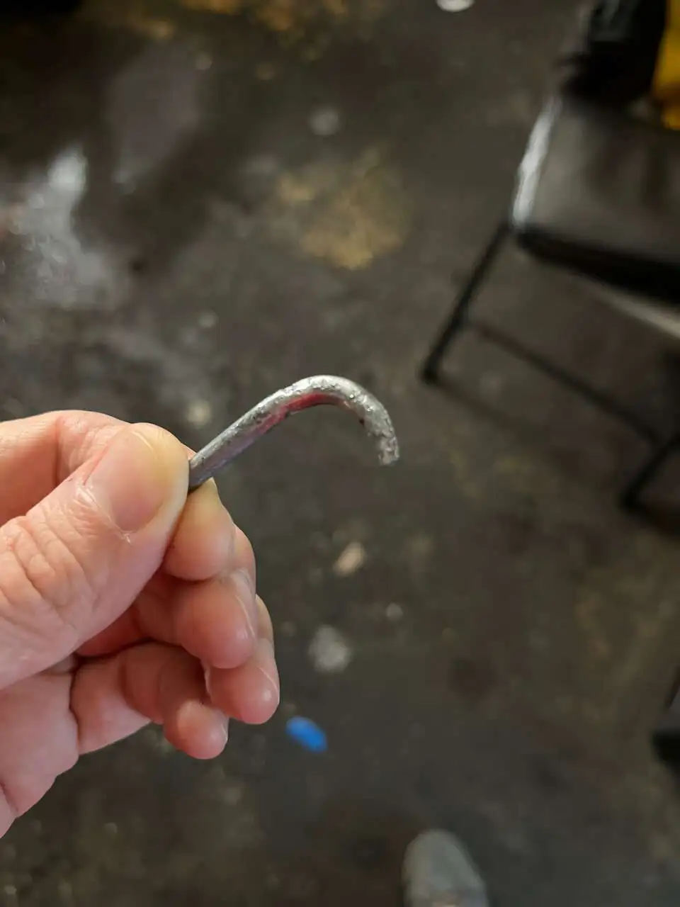

In about 10 minutes I got tire pressure sensor warning, checked the tires and the front passenger one was leaking pretty bad, had to inflate it a couple of times just to make it to the tire shop where they pulled out a pretty big nail.
I'm not sure if the nail was in the tire at the time this happened or not, but regardless of the reason why the front wheel(s) started to skid, is it really the way an AWD car is expected to behave?

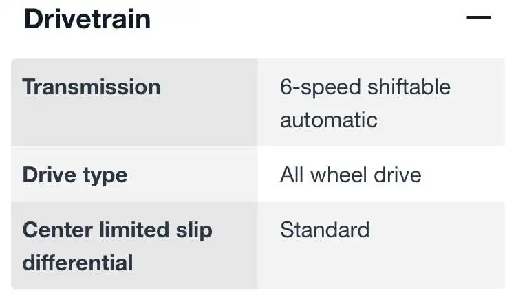

I dont know about 2021- but 2023 CX5s are only AWD and have a CLSD - transmission - The Subies used to have a viscous LSD prior to the CVT debacle - now who knows --- But the 2023 CX5 NA with center LSD handles pretty damn good for a suv - Ive been thru all kinds of ice and snow patches in shaded steep fwy turns - no issues whatsoever -- other vehicles following usually drop way back in these conditions

I think the nail must've played a role, it's the biggest nail I've ever had in a tire, and I suspect it still didn't fully penetrate when I was pushing the gas.
"LSD" forces both REAR wheels to rotate at the same speed. It has nothing to do with the center diff.
See last image , courtesy Mazda North America​
Mazda describes it as a Center Limited Slip Differential - on AWD systems for CX5 ( 2022-24)​
