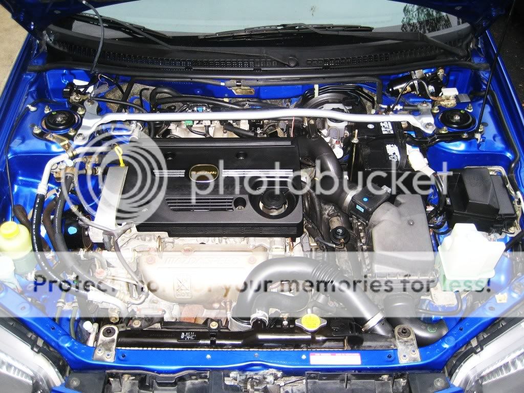

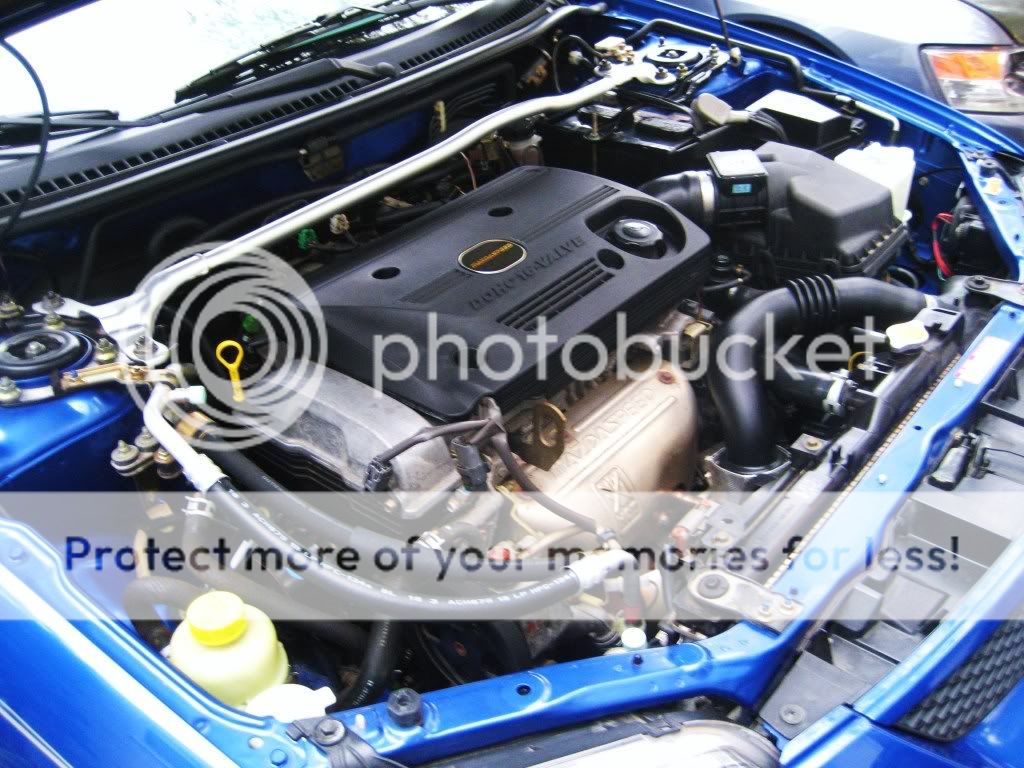

Bone Stock
Bone Stock Engine Bay Pix i just cleaned it....im gettin a bunch of stuff polished (heatsheild,rad holders,battery hold down,etc...) Cant wait to make even prettier

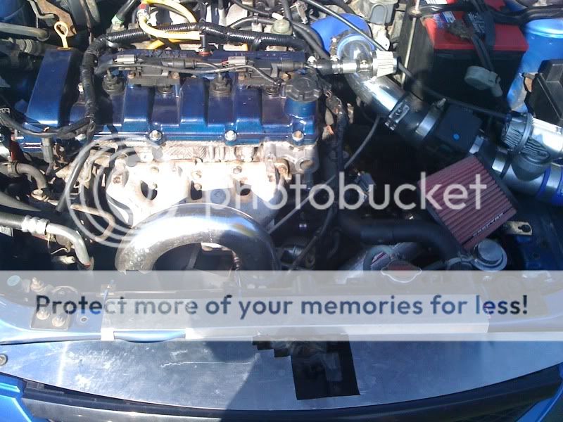

The latest...
I'm going to get more worm gears soon to clean up the ghetto zip-tie look. Then I think I'm going to paint the purple hat of the type-s black.
In spring I'll re-do the covers a gunmetal type color and do a nice stencil of my forum name.
But this is it for now.

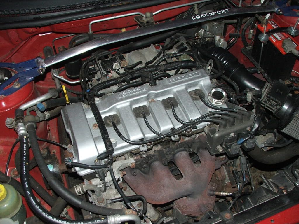

Decided to take a pic today. Miss my very clean 1.6l engine bay, but this one will be better in a couple months *cough* look in sig *cough*
Things to note: CC removed, all sensors removed from the passenger strut tower, Odyssey battery and cut stock tray, AEM filter. That's all for now folks

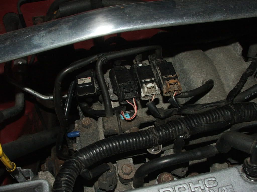

where did you move the sensors to?

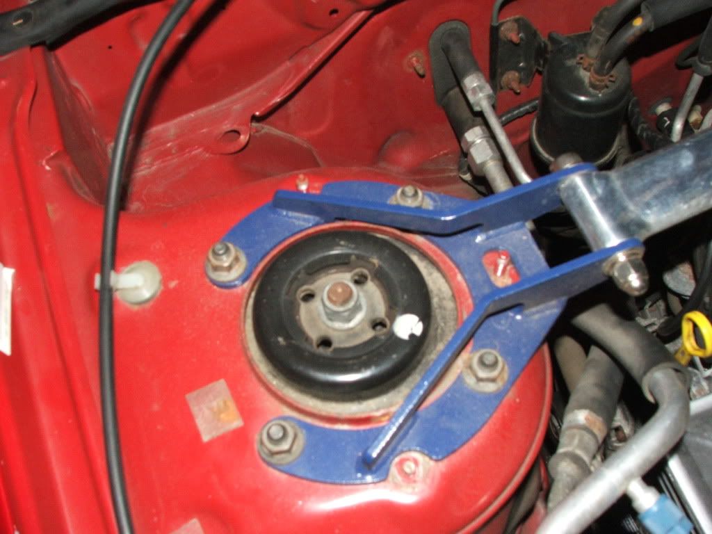

On the top of my manifold there were two solenoids/sensors with vacuum hoses already there, I moved the one that the MAP sensor is attached to to a location right next to the two existing sensors, also there was a 10mm bolt there, and that's where I relocated the MAP sensor. Also, Moved the A/C Line bracket from the strut tower and attached it to the same bolt as one of the P/S Lines
The left solenoid/sensor and the sensor to the left of that(the MAP/Baro Sensor) is what I was talking about.
Clean Strut Tower:
