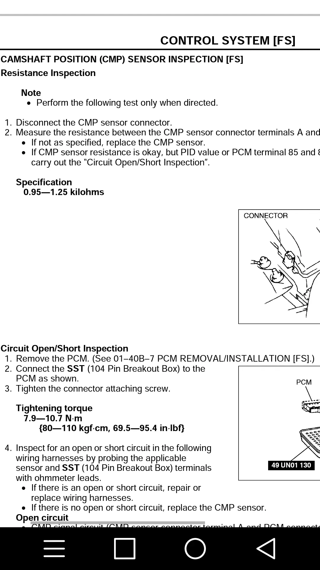

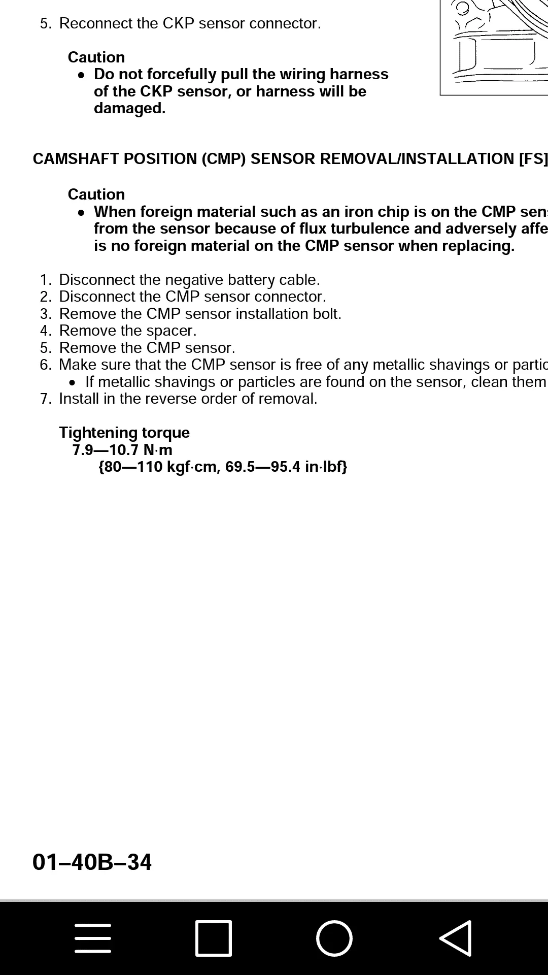

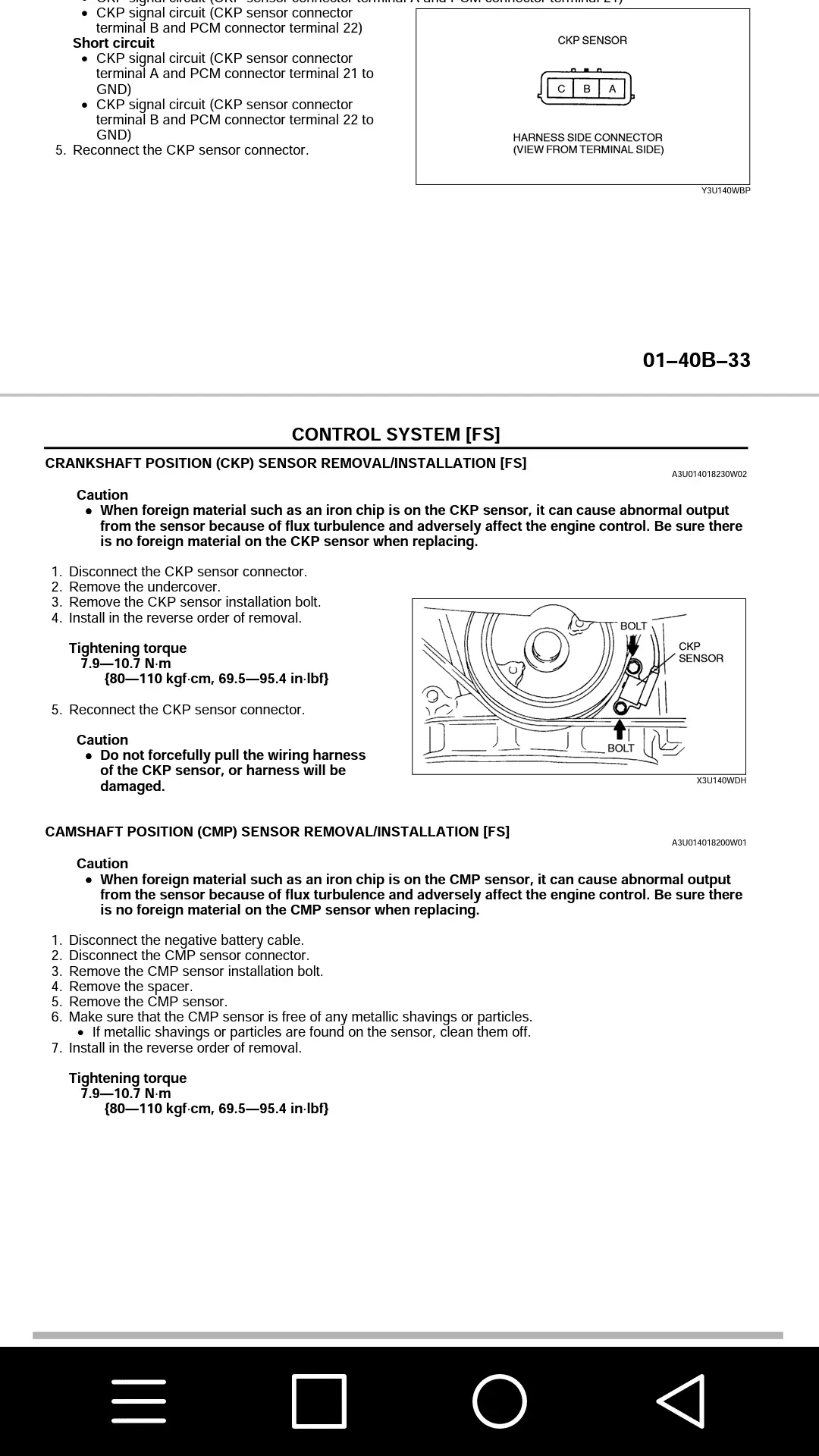

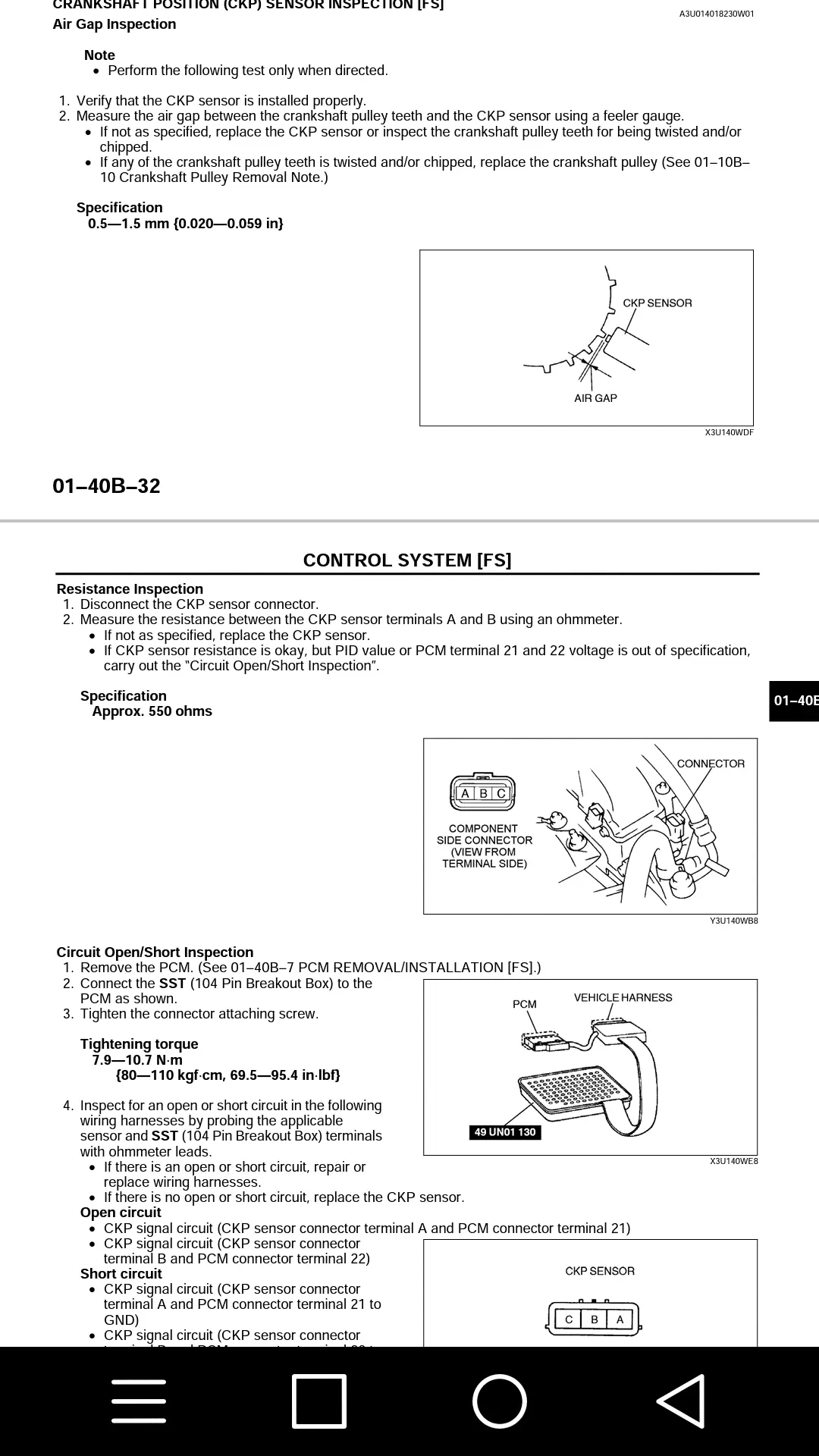

Replaced cam sensor and crank sensor. Still no spark and no fuel. Crank sensor was pretty chewed up. Timing gear looks OK although mechanic says it is the thinnest gear he's ever seen.
