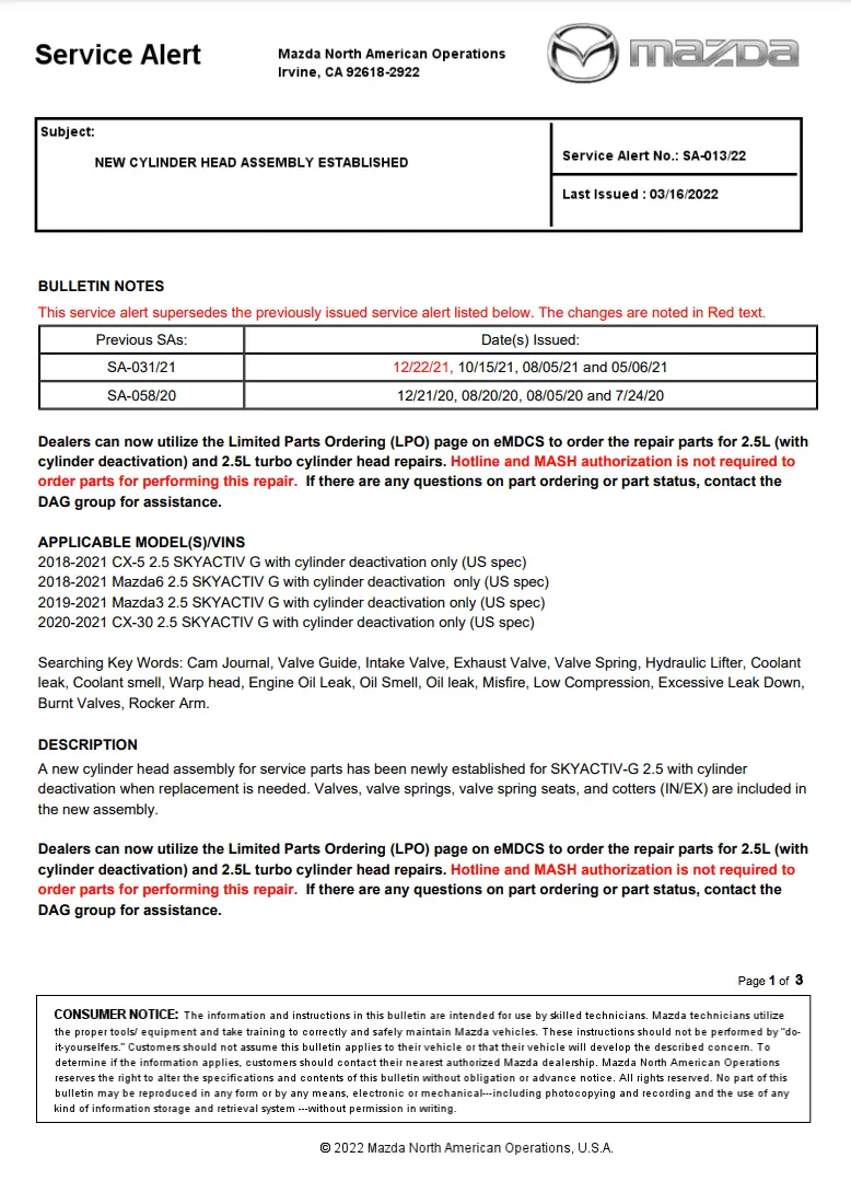

Per that TSB on the other page. It appears the cylinder head problem began in 2018+ with the new cylinder deactivation system Mazda introduced in 2018.
indeed and its worth mentioning that all the TSBs for the non-turbo model dont seem to mention cracked cylinder head.
All those TSBs started showing around the time of the CD recall in 2019 and till 2021. There were cars that had fallen rocker arms, noisy lifters, etc.
May be Mazda redesigned the cyl head with all the internals inside (thats what the TSB is about) but never officially said anything about cracked heads. If it is indeed a more widespread issue ..it was kind of swept under the rug

The TSB is basically an informative whats wrong and how to fix. You are clearly within 5 year period but whether they will fix for free depends on how many miles over warranty you are, and their goodwill feeling. Based on other forum members posts, you can try to see if Mazda will goodwill. Some have been lucky and had partial or fully covered. Others not so lucky having to pay full repair cost. You can also file a report with the NHTSA which if enough are recieved may force a recall and/or reimbursement.

Whoops. In US there's a 3 year bumper to bumper whole car warranty and a 5 year engine /transmission warranty. Even though your on Europe, check and make sure you may have a 5 year powertrain warranty on the engine.
