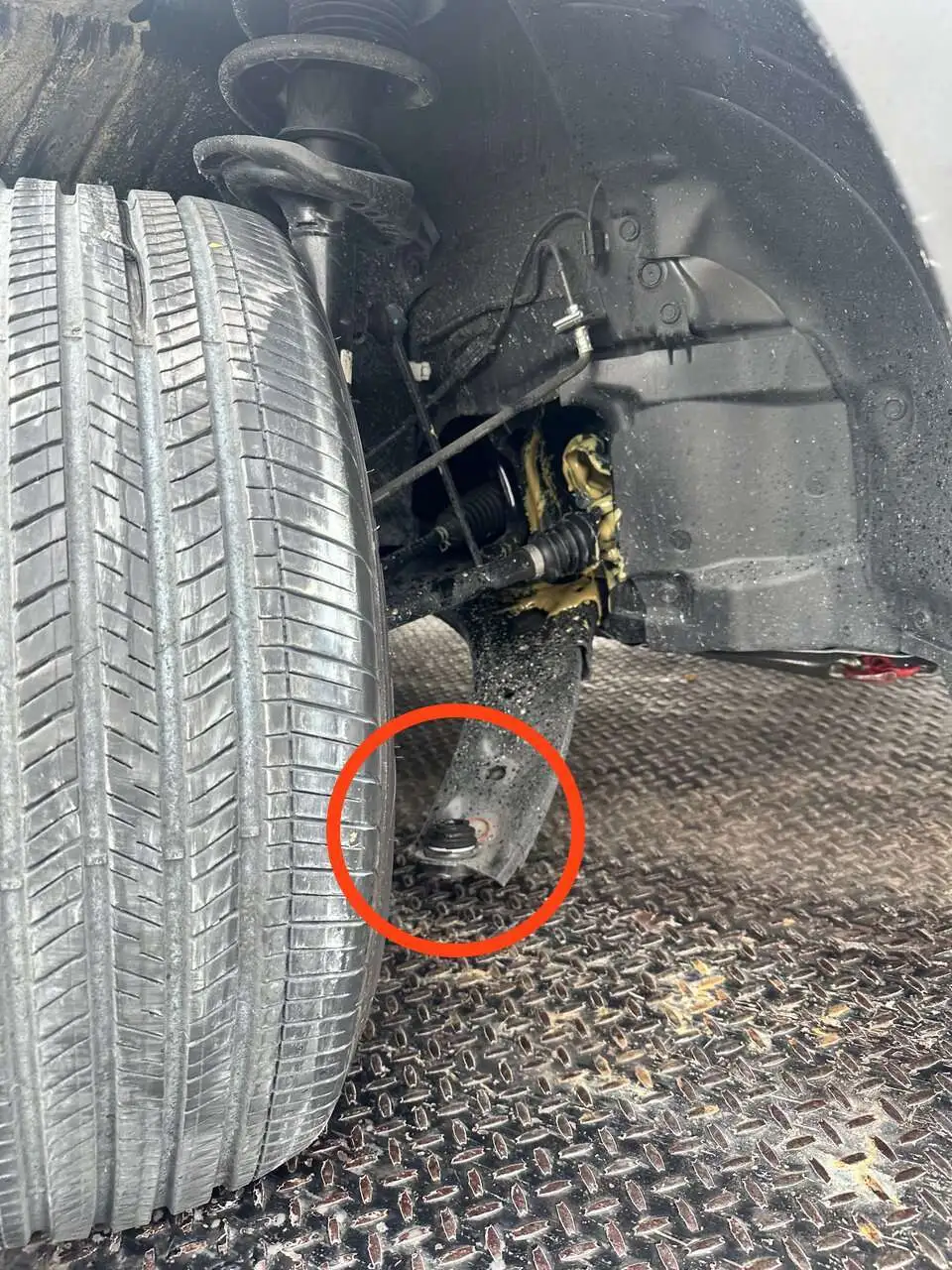

Control Arm Shears off on a 2023 CX-50 with 2k miles

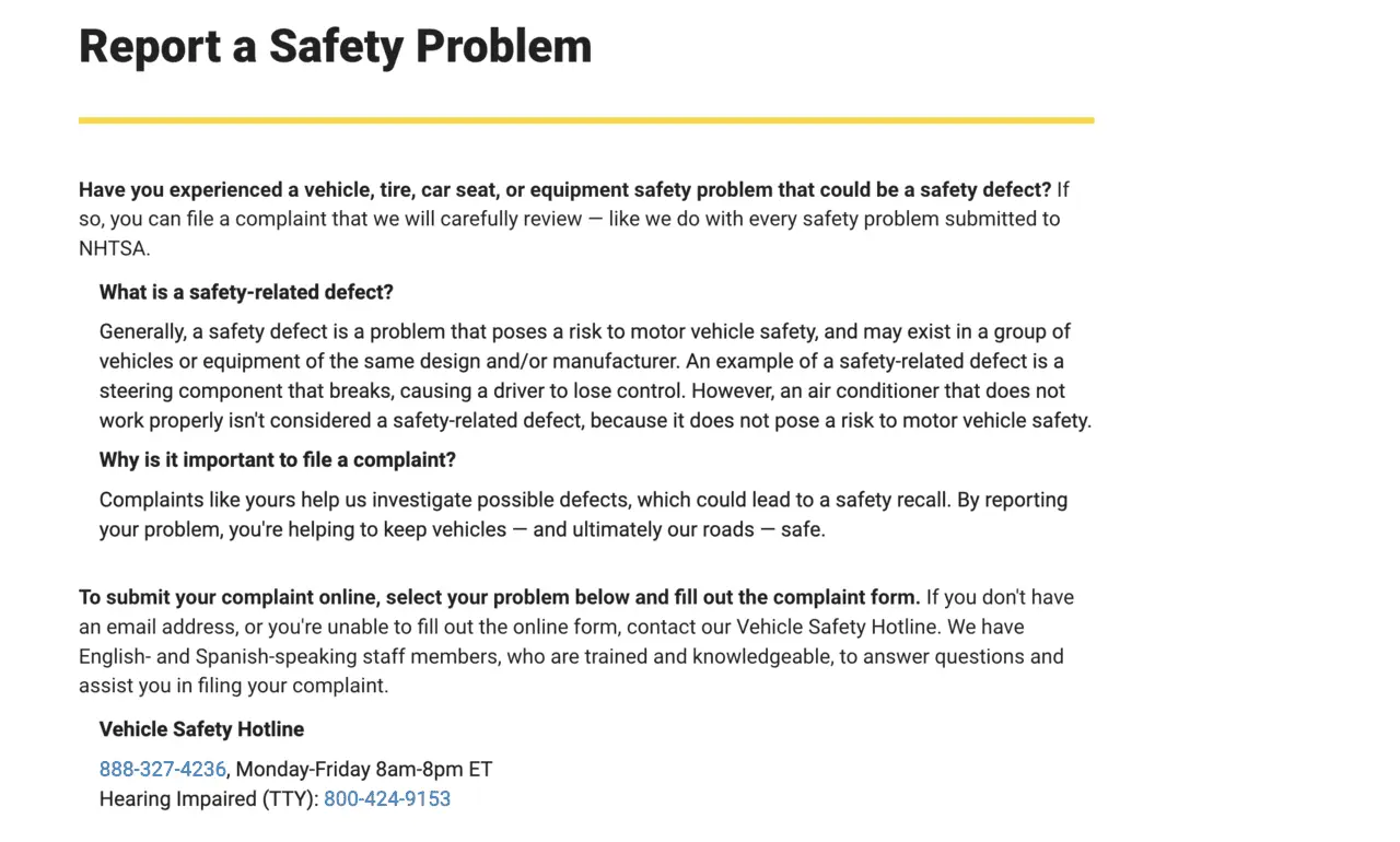

My opinion still stands
If this occurred to me I would be reporting to NHTSA

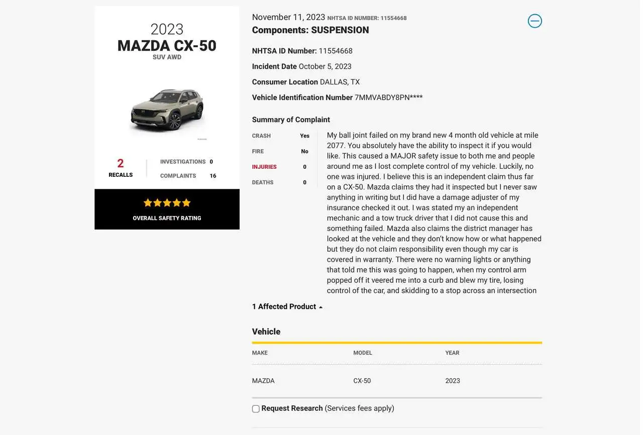

Yeah front wheels are folding in off New Mazdas left and right -- Mazda said it hit something , the Insurance wont pay and the dealer wont either .....yeah sounds totally plausible-
The OP did NOT say the insurance won't pay. You are really inflating this Beyond Belief. Just let it go.
When she again contacts her insurance adjuster regarding this, the advice is to let insurance pay so she can get her vehicle back, insurance will legally go after Mazda to get their payout reimbursed but unfortunately, she will most likely be out of the deductible that she has to pay.
Looks too thick and the wrong color to be gear oil.
It looks like gear oil with water mixed in it? Really weird. I dunno. The more I think about it a wheel assy can take a hell of a hit and show no rim or tire deformation. Depends on what it hits. If its blunt, it can sustain no damage and also transfer an incredible amount of force thru that knuckle to the attach points. Which are only the two bolts on the strut and the ball joint. I have had a few situations on motocross bikes where landing hard on a factory laced wheel has pulled out the spokes from the hub with zero damage to the rim. And just last month my girlfriend t-boned a tree head on with her fat tire ebike. Only damage was the forks bent straight back. Rim/tire/wheel were perfect. I am leaning towards it hitting something stright on. My 2 cents
Was thinking the same, although I don't know where the water would come from, unless it's antifreeze or something...Doesn't look like it rained or anything.

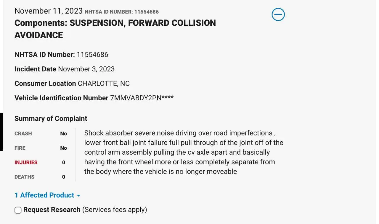

WTF?? The way the NC incident reads the ball joint didnt break. It pulled thru the LCA and remained in the knuckle?? Thats absolutely nutz. I pictured the ball joint shearing in half. Jesus.
The ball joint sits in a nylon casing in the LCA, so if the nylon is cracked/impacted/worn/damaged, it can come out. That's what happened to my son's 2014, though it had over 200K miles on it, so not too surprised.
20220604_2002592-jpg.310521
Yeah, most failed ball joint incidents I’ve read and this CX-50 by OP are the ball joint stud got pulled out of its socket, like @RedBaron‘s picture shown.
OP’s CX-50:
