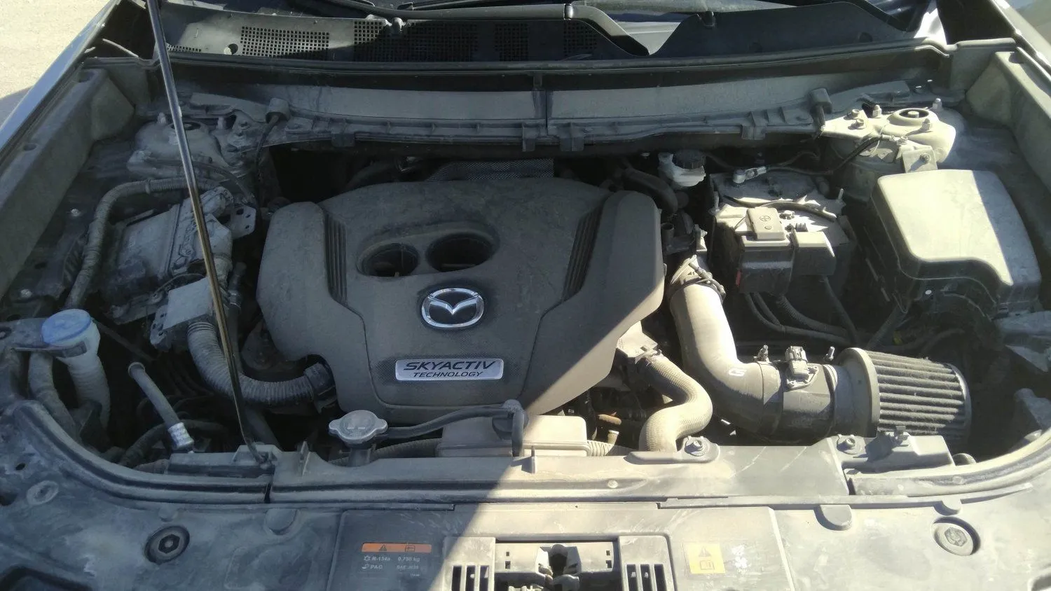

I personally have had the Corksport intake installed for just over 22000 kms (about 13600 miles) now. It's been through a couple of heavy rainstorms (see video below), some hot days (40c) and some really, really cold days (-50c). I've been lazy with cleaning the engine bay.. I have yet to clean it since taking delivery in 2018 😬 lol. Pic posted below the video to show the current state of my engine bay..
At the 1:35 mark, the wind blows some water that the car is kicking up back onto the windshield and I lose visibility for a few seconds. I am going about 15km/h below the posted speed limit, so if it looks like I'm speeding, its just because everyone else is going really slow. If I was stomping on the gas, the risk of hydrolocking the engine is a little higher, but with light to moderate throttle there were no issues.

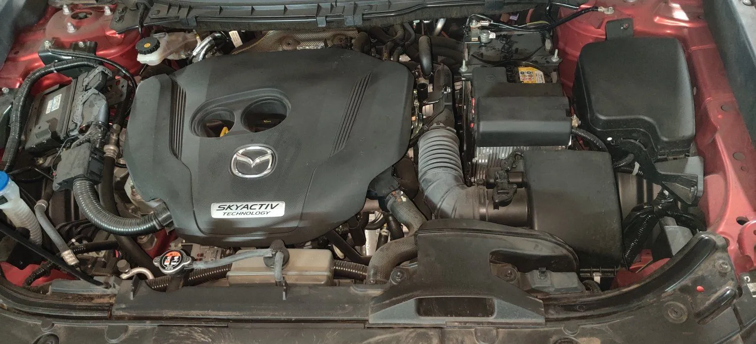

Here is a photo of my 2017 CX-9 Engine bay. The only difference is the location of the brake fluid reservoir location. Mine is on the right compared to photos posted by @SnowflakeS @sm1ke and @ntdouglas. I am guessing it is because of mine is Right Hand Side driving compared. In US, its Left Hand Side driving as far as I know.

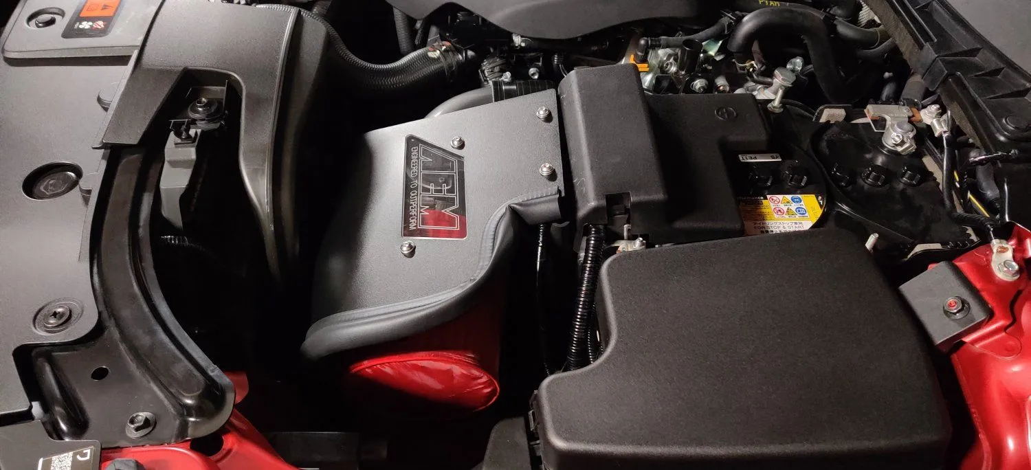

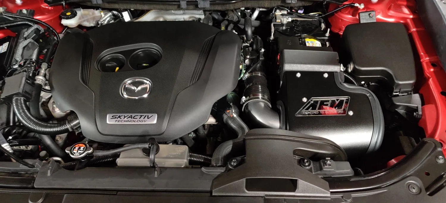

Thanks all. I read the thread, and took the plunge. Looks factory, but better! Improved acoustics for sure, can actually tell there is a turbo in there somewhere now lol

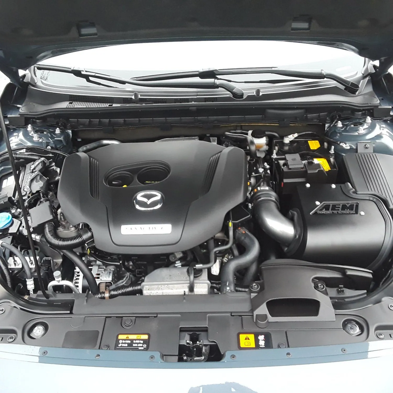

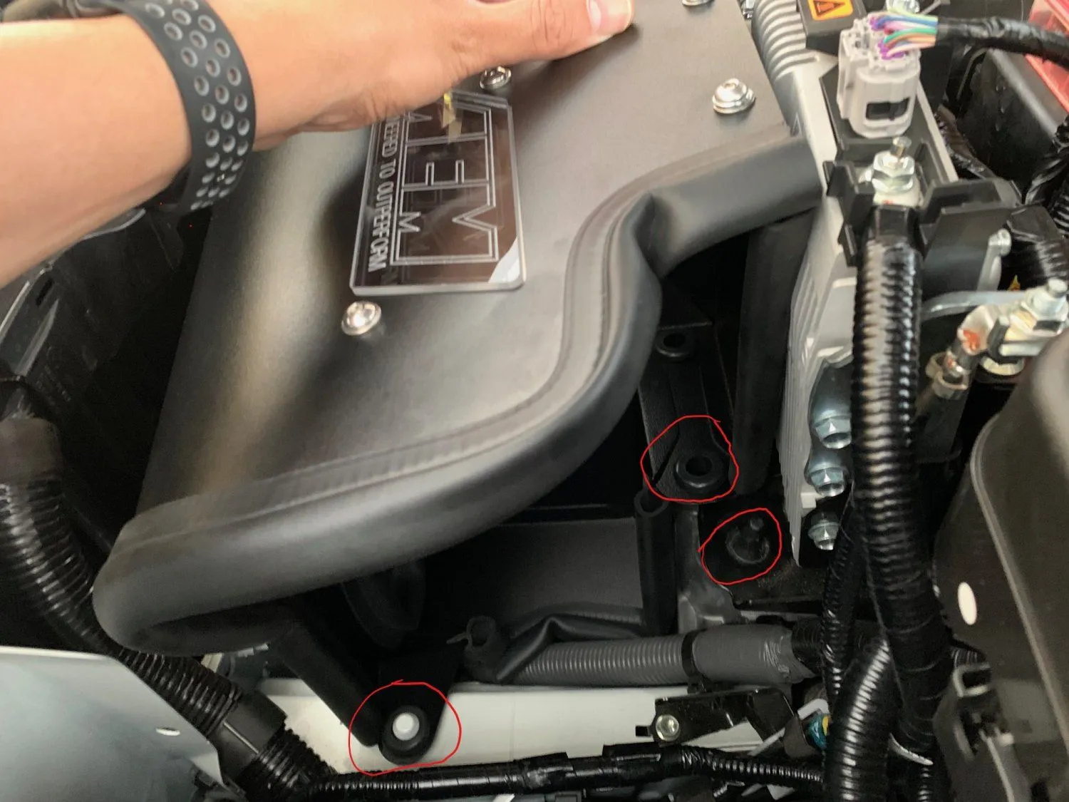

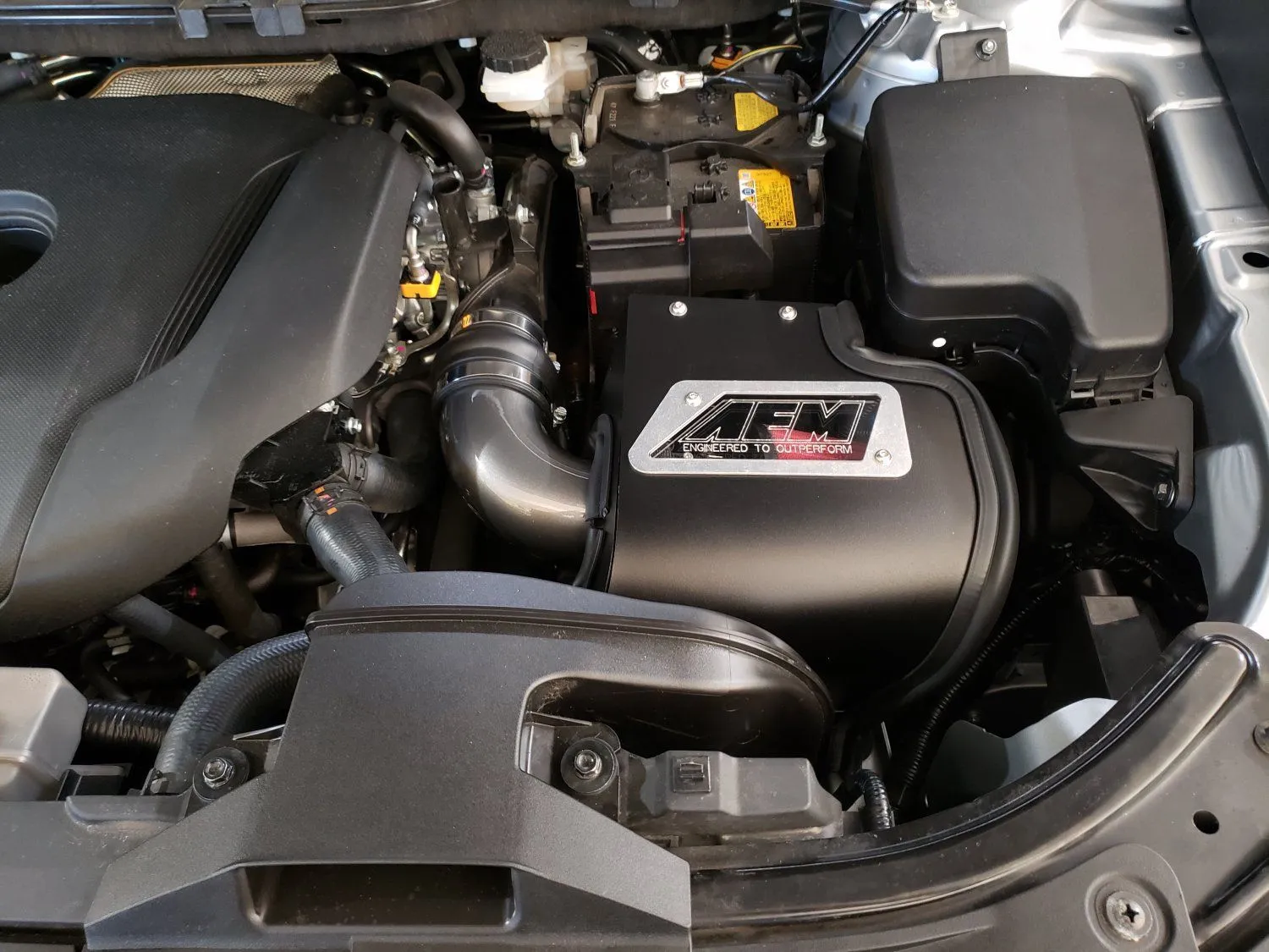

@OzzyDroid sad to say mate, the AEM intake will not fit in your CX9. I have the 2019 Azami and thought it will fit too but unfortunately mine has this device beside the battery (not really sure what it is) which you also have in yours and it doesnt allow too fit the AEM intake heatshield. The US/Can versions doesnt appear to have this but when you try to fit the intake heatshield, the grommet locations will be atleast 5mm off to the stock pins.

@geh14 .. Mate, I didn't see your comment earlier. Thanks a bunch for letting me know 🙏. I just came in to post the same information here.

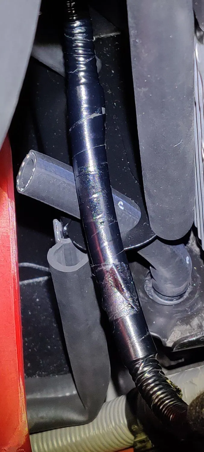

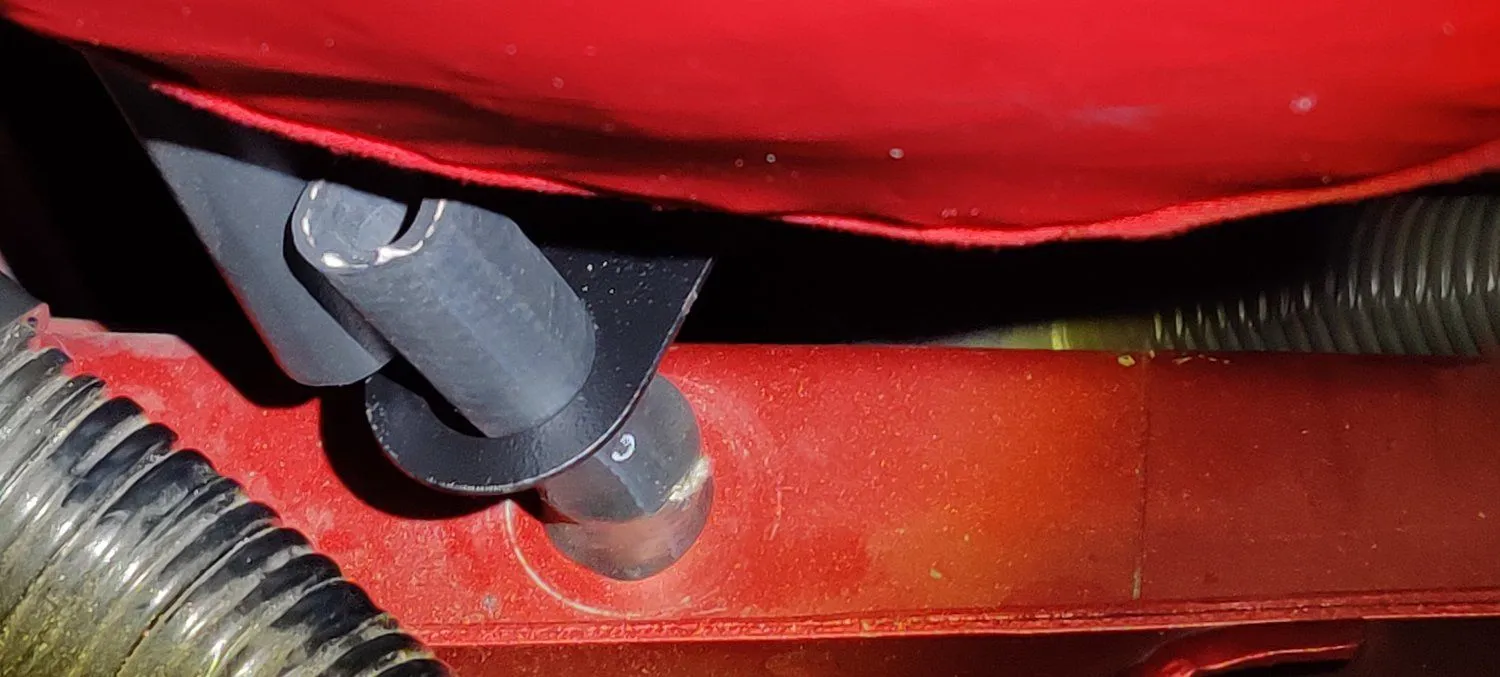

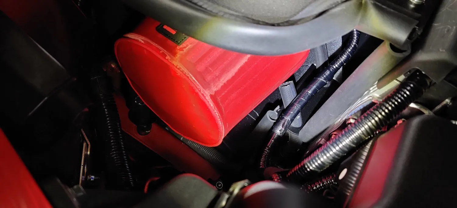

However, I still managed to install it by adding few simple mods. I didn't feel like giving up after waiting for months to get it imported from US. I used three 4 inch fuel line hose to extend those 3 pins. After installing the stock air scoop, the gap between the ECU looking thing that stands in the way between AEM heat shield and the battery is very slim. To avoid any grazing between the two, I pasted a little piece of 2-3mm insulation foam (like a sticker) on the surface of the AEM heat shield. Also, I replaced the AEM connecting hump (3inch to 2.5inch) reducer as the AEM hump is bit short. See images for the end result. 1 Win 💪for me 0 for Mazda 💩. I drove today after installing the intake and the induction noises sounds great 😌. Please let me know if you need further information. Happy to help.
However, I still managed to install it by adding few simple mods. I didn't feel like giving up after waiting for months to get it imported from US. I used three 4 inch fuel line tubes to extend those 3 pins. After installing the stock air scoop, the gap between the ECU looking thing that stands in the way between AEM heat shield and the battery is very slim. To avoid any grazing between the two, I pasted a little piece of 2-3mm insulation foam (like a sticker) on the surface of the AEM heat shield. Also, I replaced the AEM connecting hump (3inch to 2.5inch) reducer as the AEM hump is bit short. See images for the end result. 1 Win 💪for me 0 for Mazda 💩. I drove today after installing the intake and the induction noises sounds great 😌. Please let me know if you need further information. Happy to help.

@geh14 sorry mate. I fixed the bad url on my earlier post. Click here. The heat shield is simply sitting on the fuel line extenders. I'll try to post a photo tomorrow. Remove those 3 rubber bushes from the heat shield. Let the fuel line extenders to come through the 3 holes (about 1.5 inches of it will come inside of the heat shield) of the heat shield. You can also fit the scoop. It's a bit of a wiggle...but can do. It will be a tight fit. Btw, which state, suburb you're from? DM me
