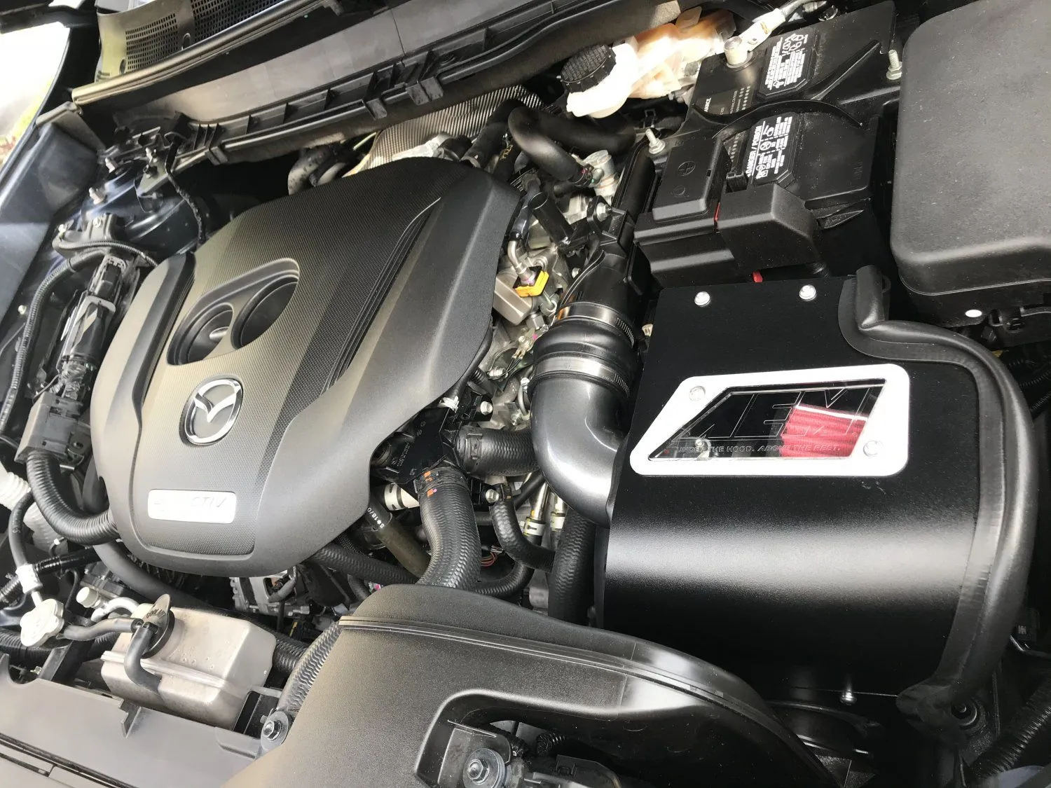

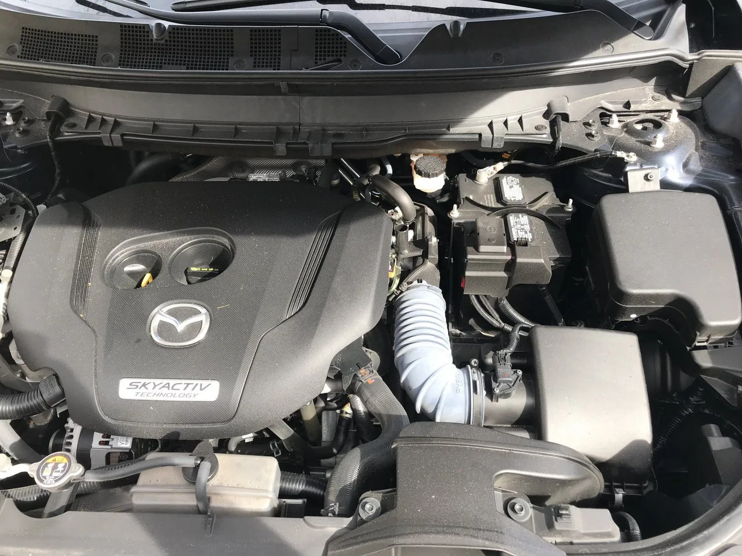

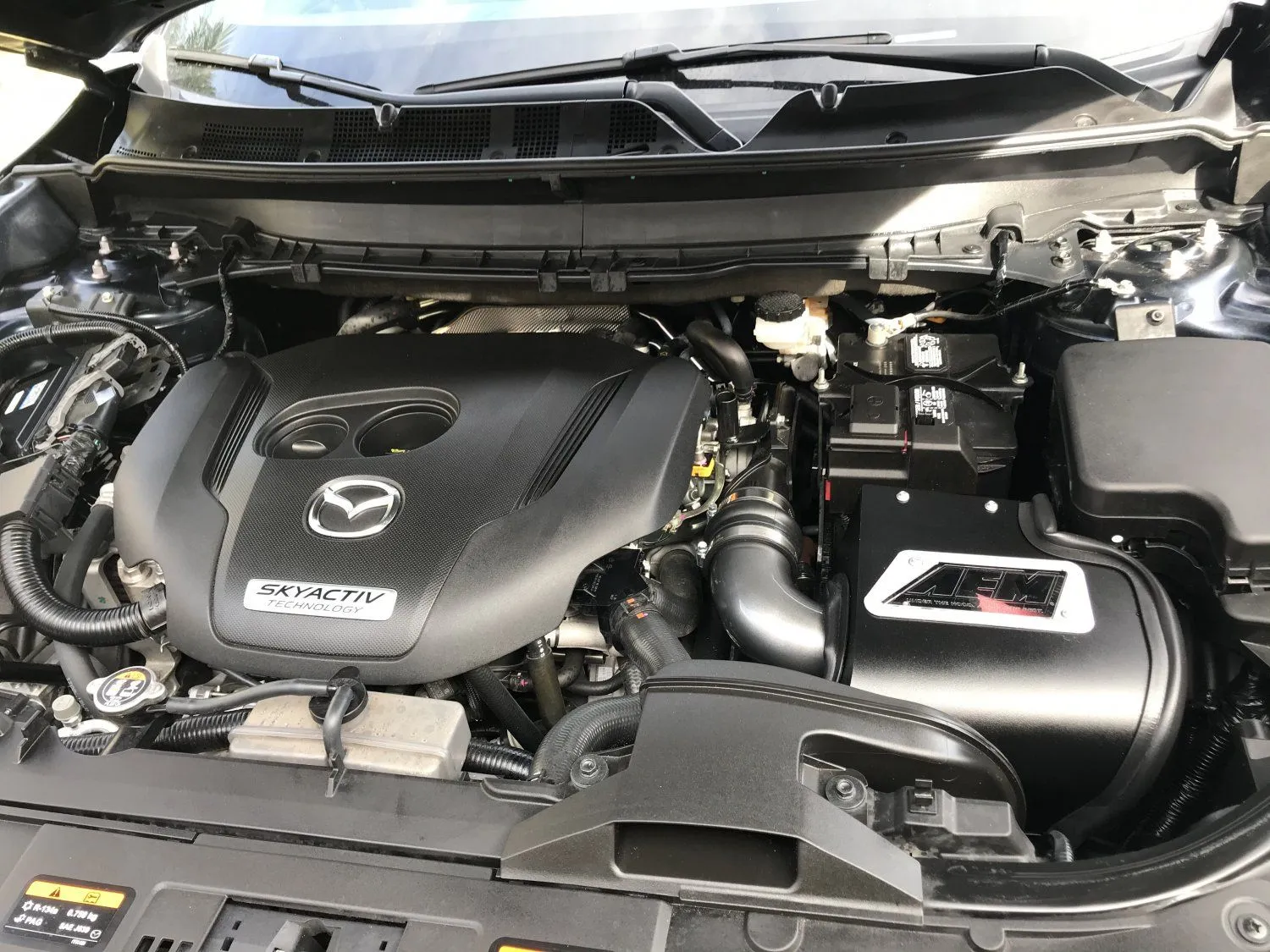

So I did it. Spent the extra money on the AEM. Extremely quick and easy instal. Still feel like the “box” isn’t sealed well enough to avoid warm air from the bay but definitely think it’s better than stock! Got my fun noises.

Mate, that aluminium plate goes behind the airbox (it's sandwiched between the airbox metal and the polycarbonate AEM plate) 😌. Looking good 👍
