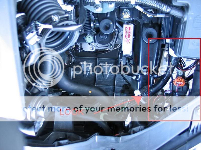

i actually already have a plan. box it and block everything off besides a 3" x 3" opening between the light, and chasis metal bracing. it will pull cold air directly from the fog light ducting, the fog light opening itself (because its pulled) and several deflectors that actually aim right around that corner.
very easy to make. Cardboard box mold. Cut sheet metal. Weld together. Add a mounting bracket somewhere, done.
I'm not quite sure why Cobb hasn't thought about where mine will be placed. It can pull much more air then a 3/4" slit and thin tubing in the front grill. You are talking about a complete, pretty big cu. ft. space to pull cold air from and its easily accessible. Not to mention, air moves pretty freely through that area and is recycled right our the front of the wheel well. maybe i'm just a genius. lol
EDIT: Here is a pic of the opening i am talking about. The picture actually cuts it off. It is bigger then that. That brightness behind the cables is the ground/wheel well !!!! The opening is HUGE !!!!!
isnt that blocked by the front bumper and the inside panels of the wheel well? looks like a good spot tho i can see the light coming in
nope, that is not blocked. its open right there. go check your own out.
Dave @ cobb stated they are no longer going with the slit design. They will be taking ambient air from somewhere else. probably the wheel well. atleast that is some good news.
