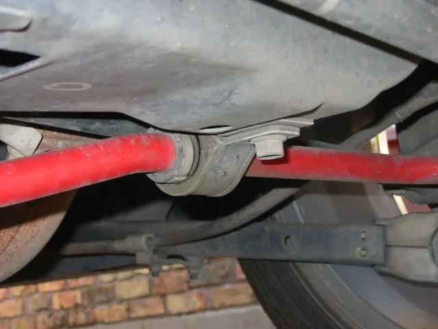

I just got my mp3 not too long ago so im just now learning about the clunk problem. Im starting to hear noises from my car but i dont think its the commen clunk problem. But just to check, i was wandering if someone could tell me if i have the 156E bushings or not (if these pics are even of the bushings because to be honest, I don't really know what they are).

Can't really tell by the pics. the E's have a teflon insert or something along those lines so you actually have to pull the bushing out to see.
