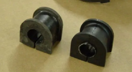

Finally got my bushings. looks like the only difference is some nylon, on the inside. Sounds nice now.
