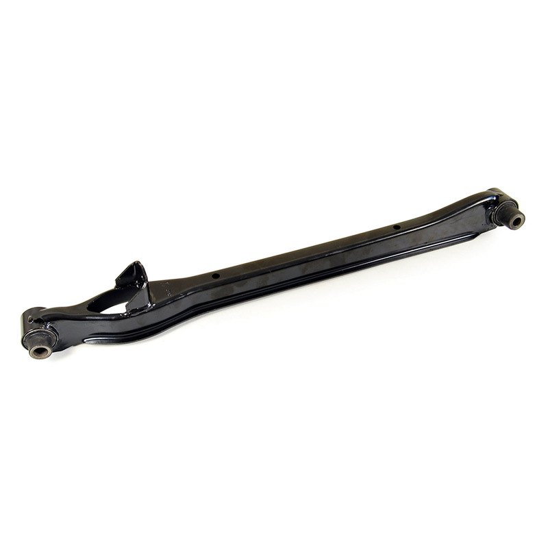

Lol Im probably going to look into trying to run the endlinks like the 626s have them. They have tiny endlinks run right to the control arm. Makes a ton more sense then trying to run it to the strut. As you can see in the picture (the little tab)

All good. I appreciate the share. This could work in the front, but the rear no so much. Would have to get a bracket made to bolt on to the lateral bars.
lol they have that in the back, so basically what you said. I remember OGP5, the yellow one with 16x8 xxrs ran a sleeve of some sort over his lateral arm bars that had the endlink tab on it. Said it worked pretty good...
