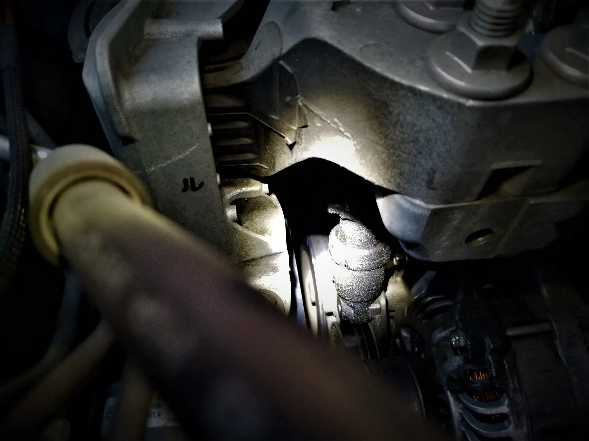

Chirping sound, when I touch the gas pedal
Absolutely this. Just replaced mine a few weeks ago and problem solved. Mine likewise chirped when I gassed it, but more often when I gassed it and then AC was also on.

Not sure. I paid a shop to do it as I wasn't comfortable messing around with that as a bit of a noobie.
I see on Rockauto, that they sell aftermarket ones. Anybody tried these? The factory one, doesn't look like, it lasts to long.
These tensioners are oil filled, they start leaking and they lose their tensioning ability? They don't have a spring in them?
I guess. Mine was completely covered in leaked oil. I'll be keeping an eye on it from now on.
I have looked at the tensioner, and is completely covered, with oil and dust.
Ordered a new one and a serpentine belt. Mazdaswag had the cheapest, $124.80 shipped.

As I wrote in the other thread, by replacing the belt tensioner and the serpentine belt, the birds are gone. (yes)
As I suspected at the beginning of this thread, loose belt by bad tensioner could be the culprit. ;)
