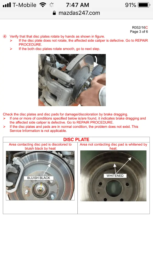

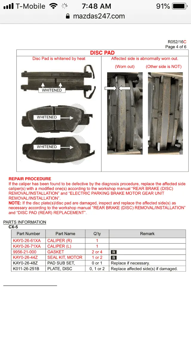

So have you even had newly revised rear calipers replacing your old ones based on the TSB I mentioned earlier?
I've never had my calipers replaced. Never had any symptoms that I noticed. Probably because I almost never used the EPB. Car is out of warranty now with 48k miles.
The easiest way to tell if your rear calipers are having problem is to compare the inner and outer disk pads on each side. If they are wearing at different speed, i.e. the outer one of your old pad is thinner than the inner one, this usually means your rear calipers have problem on EPB. But since you hardly use the EPB, you may not be able to see the difference.
the inner was pretty thin and the outer still had about 3/16 or so on it if i remember right. i didn't think that was out of the ordinary from what i've seen before on brake pads. the way the rotors were scored i was surprised i never heard any squeal out of them.
Diffetent thickness of old pads can also be an evidence of faulty caliper due to insufficient accuracy of the screw threads on EPB even if you didnt hear any squealing noise.

I did not have those symptoms and pads seemed to wear evenly. I guess the whitened color indicates a caliper is dragging the pads.

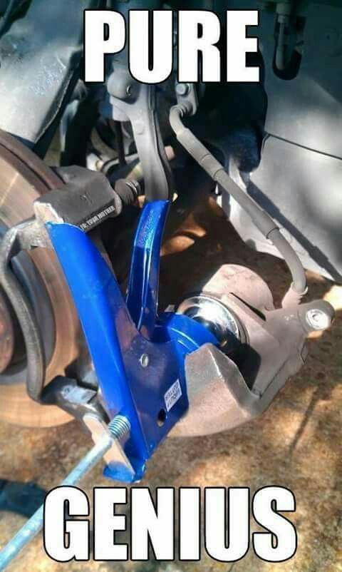

hey guys, I just saw this on Pinterest and thought I'd pass it along. Seems like a pretty solid idea. Haven't tried it though. BTW, I did my front brake pads today and it was easy-peasy. took me about a half hour to do both sides. So look at this piston compression tool. You might even have one already. looks like you have to saw off part of the caulking gun.
