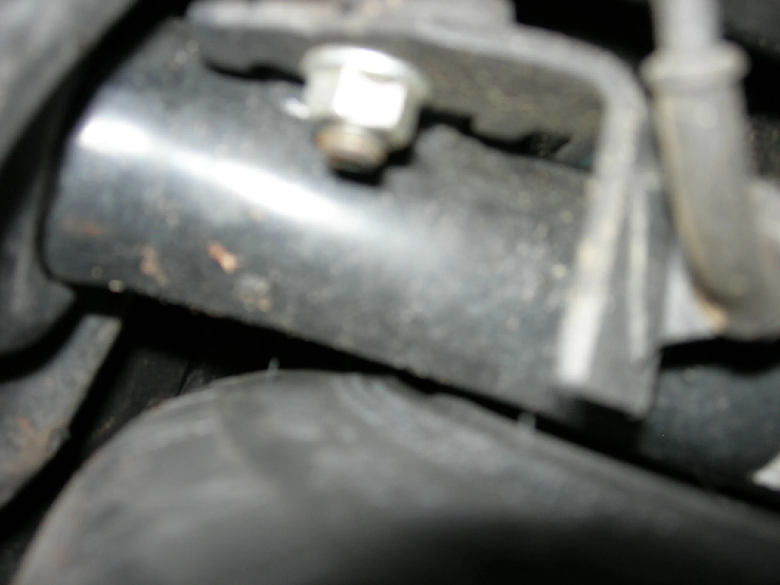

Hey man I have yet to prove one way or the other, next set of tires is going to be 245; I still have tons of room,(uhm) right? I wish I had odered 245, that gaps huge.:)

I meant rubbing on the outside, not that super-tight clearance on the inside. That will more be tire-dependent. Some tires have large rim protection beads, some don't. This will be more important then the tire size for you. But a 245 (which I hope DOES fit) may rub on the back end. A fender roll may be necessary.
