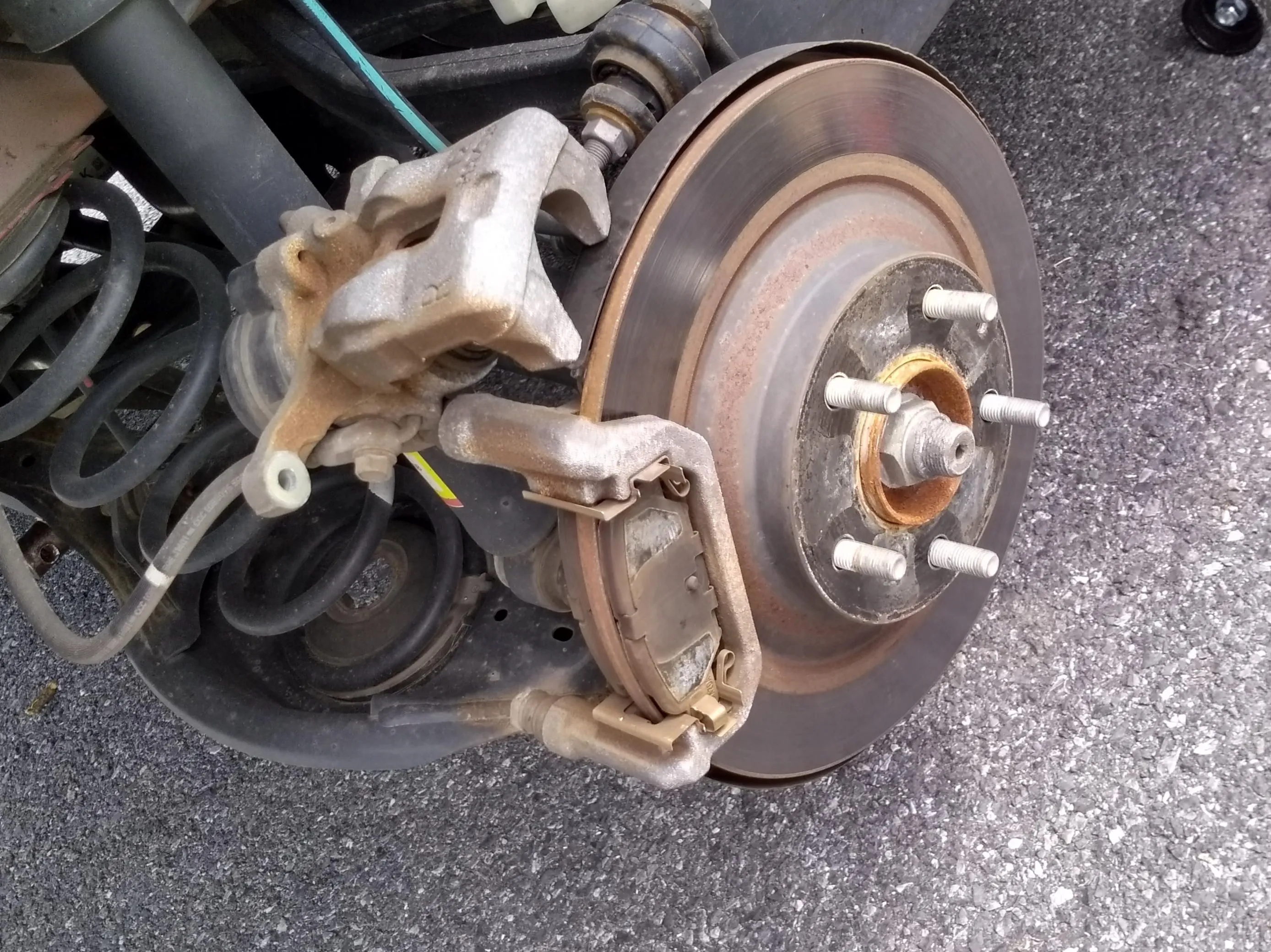

Yes. Just slide the caliper up a little and you're golden.
attachment.php
If you just want to lube the pins then you would not have to disassemble the brakes. You could just take off the the wheel. Then using a 14mm socket take out the bolts at the end of the slider pins. I would just remove one at a time. Then pivot the calliper enough to remove that pin. Lube and reinstall, and torque down 14 mm bolt to 20 to 25 lb-ft. then remove the other. pivot the other way, and repeat.
