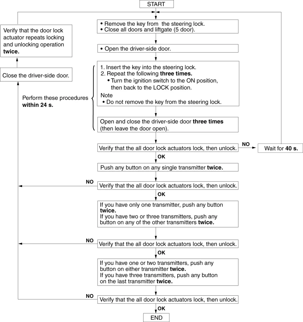

I do have a 2011 also, I have not used this procedure at all, but I found it on what seems to be the service manual. May be you would like to give it a try:
[table="width: 500, class: outer_border"]
[tr]
[td]2011 - CX-9 - Body and Accessories
TRANSMITTER ID CODE REGISTRATION [KEYLESS ENTRY SYSTEM]
NOTE:
When registering the ID code into a keyless control module, verify that other transmitters are not being operated in the vicinity.
After ID code registering, remove the key from the steering lock and verify that all doors lock/unlock normally using the transmitter.
MazdaCX9_2011-Keyless.webp[/td]
[/tr]
[/table]
Procedure for remote

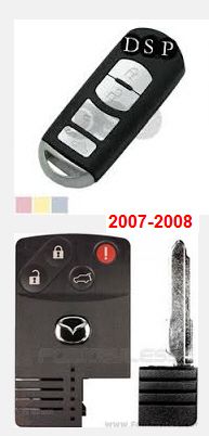

Does anyone have the procedure to program a Smart Key? I have done keyfobs for Acura's before and I know they aren't that hard to do. I am not sure what is needed for the Keyless Smart Key's. I have 2, but one is cracked so was going to pick up a spare. Please let me know if you have any information.
I am personally very confused about the procedure for key itself and for the keyless remote control. I have 2 keys and 2 remotes (flat remote for cx9 2009) but one quit working (it is not the battery). I am trying to get a new one and re-program the remote. The key is fine. Let me know if you have any clue and sorry I cannot help on you key issue. Thanks,

I have a 2007 CX-9 with the card style advanced keys. One of my keys stopped working last week (replaced battery, and double checked that the battery was good as it worked in the functioning key). The red light comes on when a button is pressed, but the vehicle does not respond. Is there any harm in attempting the reprogram sequence? Am I correct that I would skip step 4, and only press unlock on the currently functioning key?

Hmm, ya know, I'm not sure. There it's somewhat confusing as to when people are referring to the "smart key", "smartcard key", or the "advanced key". Post #65 and #69 mention the "advanced key", and differentiate between the 2007 and 2008. AFAIK, not much has changed with the vehicle since 2008. I guess you could try it and report back, if you plan on getting the third key anyway?
I just read through this entire thread and as someone just recently said -- it's very confusing regarding the terms used by various posters over the course of 7 years.
My question is -- I have 2 working FOBs and the silver part that connects the key to the keyring broke off of one of them. I purchased a new blank from eBay (that said it did NOT come with the chip) but I thought that was fine since I figured the chip must just be inside the FOB, not the key that slides out. Is that wrong? Is there a chip inside the black part that the keyblade attaches to as well? I'm beginning to think it is... and that my best option would be to buy a new key blank from the dealership and have them cut it for me. Or can I just have someone cut the key blank and all will be well? I do have 2 working fobs, and both original key blanks, but the one is kinda worthless if you want to attach a keyring to it.
Here is a picture of what I have -- the fob and key sliding out of it (without the grey cap to attach the key ring to it) and the new blank I ordered from eBay.
