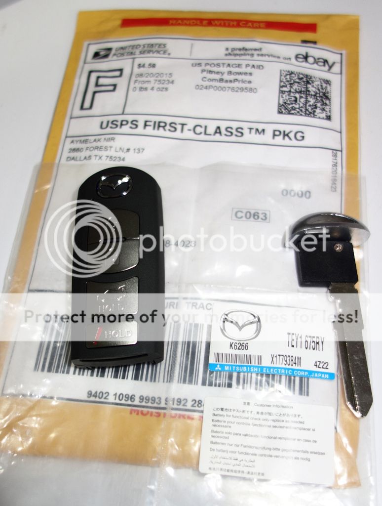

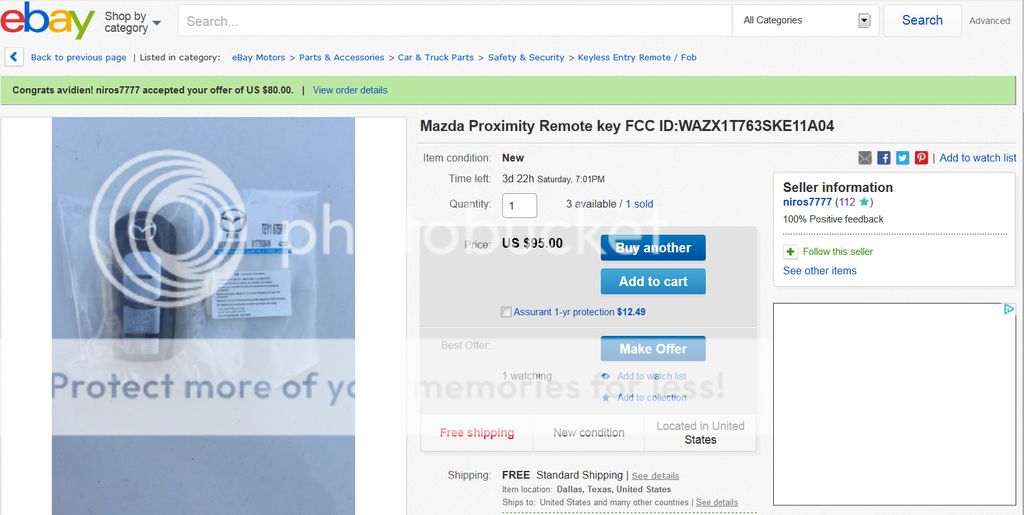

I took a risk and bought from this seller on eBay, he's asking for $95 but I offered $80 and he accepted,
I received the item today and was pleasantly surprised that it was a BRAND NEW KEY WITH UNCUT BLADE INCLUDED (note: seller only has 3 sets left)
eBay link : http://www.ebay.com/itm/Mazda-Proximity-Remote-key-FCC-ID-WAZX1T763SKE11A04-/281762016423?hash=item419a532ca7&vxp=mtr
screw the stealership and their outrageous $400 charge for an extra key
this is what came in the mail today:

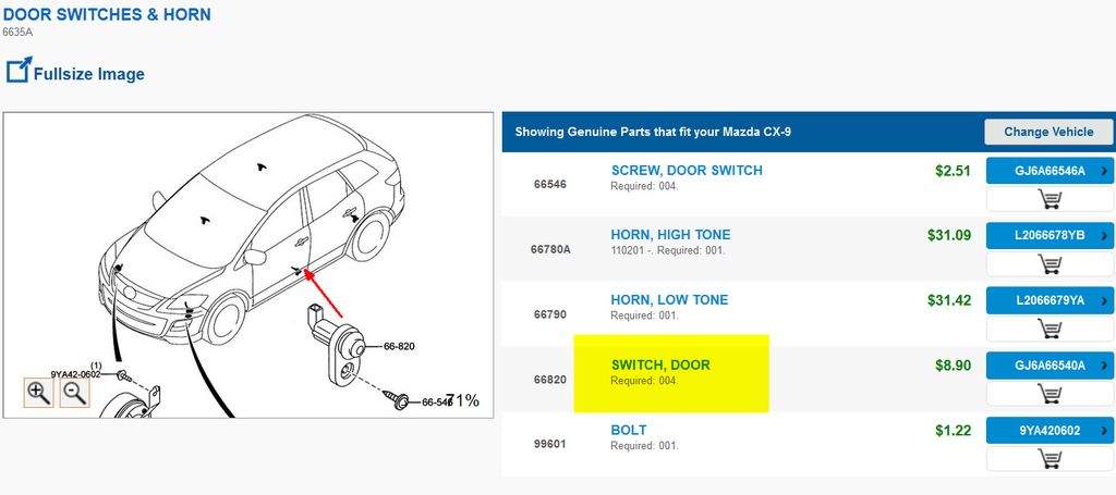

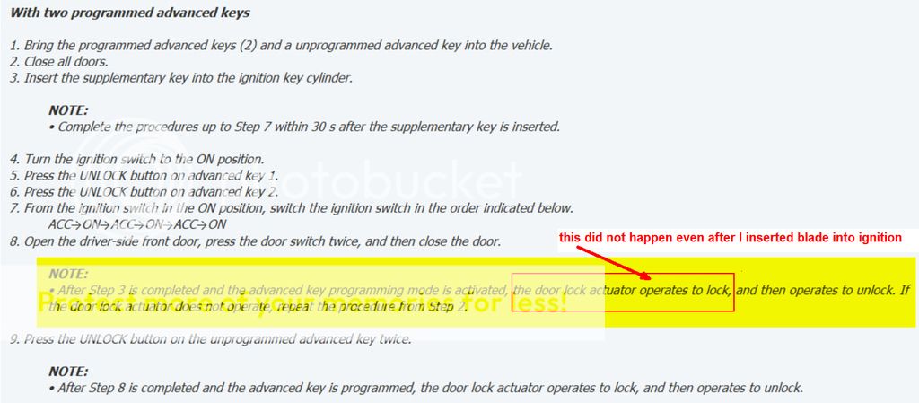

I can confirm the instructions below indeed works for 2013-2015 CX-9's, except the NOTE: After Step 3, the door lock actuators did not operate even after I inserted the blade into the ignition key cylinder. Anyway, I ignored it and kept going and low and behold the third key was programmed BUT that was after an hour after I decided to click in the blade for the third key ???!!! Prior to that I thought the blade was just a piece of metal without a chip so I left it inside the house and for a whole hour the key will not program at all which makes me believe there's more to that blade key than one would think!!
(sidenote, just FYI, the "door switch" is the rubber plunger thing mounted to the left of driver on the door pillar used to indicate door is ajar, can either push that switch manually twice during programming or just open and shut the door twice to trigger the switch.

From the ignition switch in the ON position, switch the ignition switch in the order indicated below.
― ACC→ON→ACC→ON→ACC→ON
For my mazda with a push button start (I have a 2011 manual transmission mazdaspeed 3) if the car is in the "ON" mode, if I push the start button again then it just goes to off. As far as I can tell from my research there is no way to go from "ON" directly to "ACC". I have to go from "ON" to "OFF" and then to "ACC". I tried doing this for this particular step of the instructions and never got the lock to actuate to lock and unlock to indicate programming mode is active so I am assuming it did not work. (i have not yet purchased a 3rd key but I wanted to make sure I could get this procedure to work first)
Another bit of confusion: for step 3 when it says "Insert the supplementary key into the ignition key cylinder." Is this supposed to be one of the 2 already programmed keys or the new key that you want to program (in which case I guess you would have to get it cut first)?
