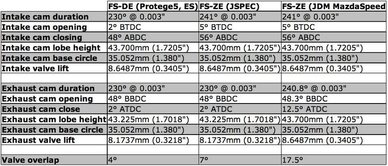

For turbo the best camshaft is FS-ZE (JSPEC) ?
but for this CAM gear; i will put on intake or exhaust ???
Special Thanks, CulRidr for picture
I use SR Motorsports cam-gears, but I had to have them machine-shopped to work on the exhaust side. That's way easier than trying to make those work on the exhaust side, as it would require complete re-fabrication of the part. I have a thread here about SR Motorsports Cam Gears... just search for it. I initially thought the cam-gear in the pic would interfere with the sensor... but it looks like it won't. I'm just not sure it'll fit properly.
As for the best camshafts... the most aggressive stock you can get are the FS-ZEs... but the bestwould either be the "Twiggy" cams or the Integral Stage I or Stage II "Turbos"... if you spend the extra $$$ for the Integrals, don't mess up and get the "N/A" cams, since those have way too much overlap for a turbo motor.
