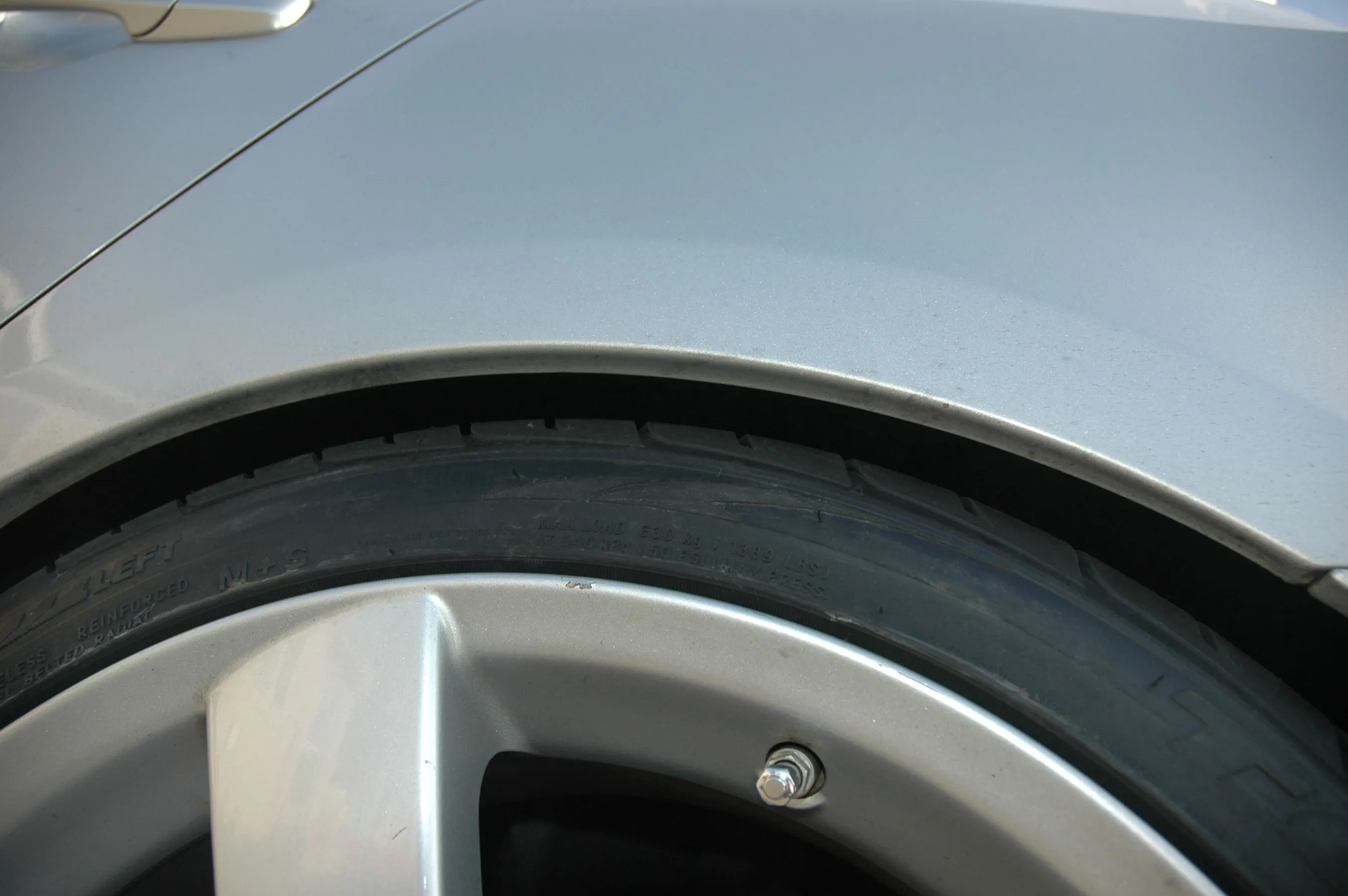

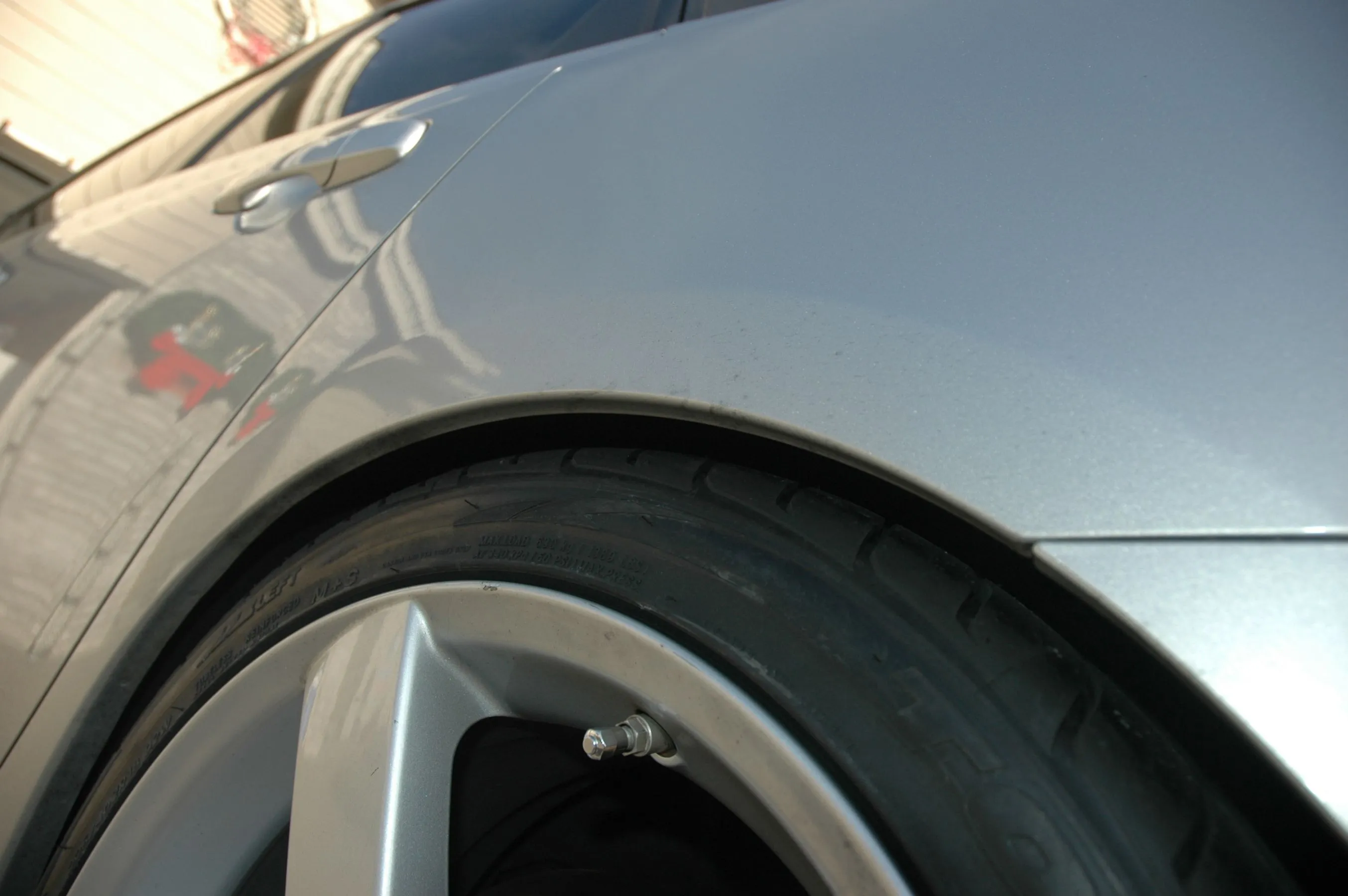

Sorry for the dirt. Let me know if you can ascertain anything from these photos. You can kind of use the valve stem cap as a comparative...

Oops...didn't see the file too big errors! :)

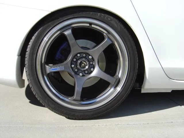

nice, so you say you are at -2 now? Cuz I really think I am an incredibly severe case. I would not be surprised if it was worse than -6. That is one of the first things people tell me when they see my car is how bad my camber is (except they usually say "your tires lean a lot").
your tires look smaller than mine but your sig says they are 225/40r18....that still true? I know you said you got new tires

Yep...got the same exact tires to replace the shredded ones. 225/40ZR18
How wide are your wheels? What's the offset. Both these values can make the same size tire appear differently in reference to the fender gap.
tphskab said:
thats true. I have 18x7.5 wheels and 47 offset
I've got 18x8 with a +50mm offset. Another .5" to stretch the same size tire across. My +50mm offset actually gives me an advantage on the tuck factor.
I think the .5 is making the tires look smaller. mine look a lot more squared off than yours
