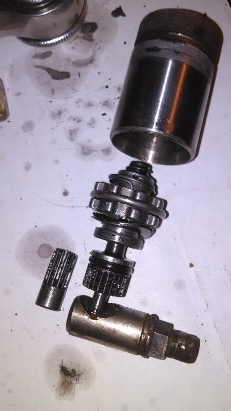

There's these parts inside which aren't included in the rebuild kit.
You can't put a new seal on a sloppy worn out part.

Here's a link to my brake thread where I took apart my rear caliper.
(the pictures got reposted at the end after Photobucket shut me down)
https://www.mazdas247.com/forum/showthread.php?123863018-Rear-caliper-dissection&highlight=

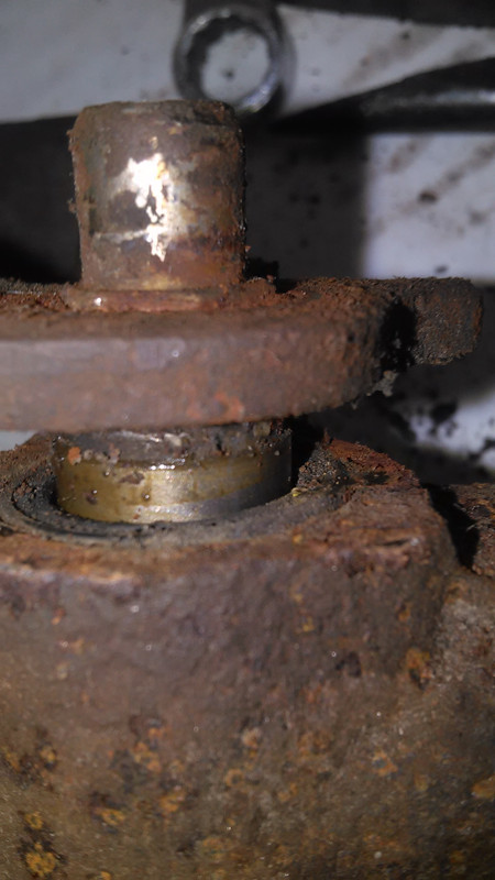

This was my rear brake piston a couple of years ago.
I sanded off the rust and greased it and pushed it back in.
It's still working with no seizures or leaks !!
