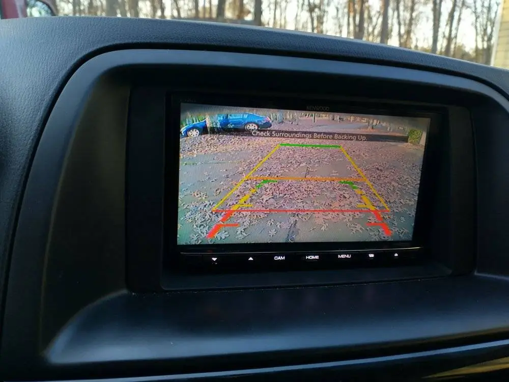

I tried to go down this road. Once you price everything out, you're going to find that it's going to be far cheaper (and better!) to get a good aftermarket deck that has CarPlay or Android Auto. I run a Kenwood, but Alpine, Sony, Pioneer, and JVC also make good quality decks.
Plus, with the aftermarket deck, you can easily add a backup camera, and if you choose a deck that is compatible with the iDataLink Maestro RR, you'll even get full gauges, right on the headunit!
