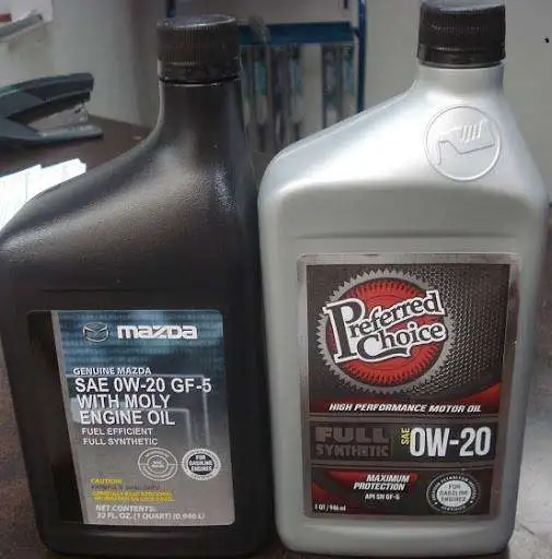

My 2016 CX-5 2.5L NA with 55,000 miles is consistently using ½ ~ ⅔ quart of oil in each oil change. I use Flexible oil change schedule and it’s about 5,000 ~ 6,200 miles for that kind of oil consumption since new, including the first oil change at 5,000 miles.
And I use Mazda Moly 0W-20 oil exclusively.

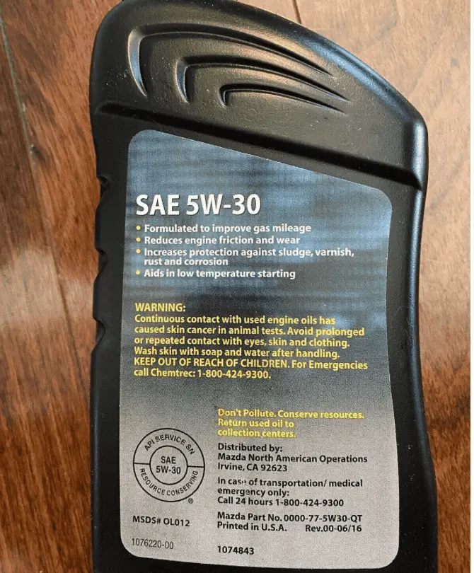

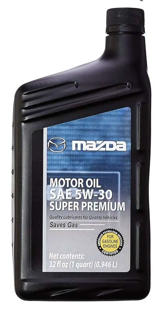

I think the Mazda 5w-30 is a regular mineral based oil, not synthetic.
Indeed. According to the parts guy from my Mazda dealer who has worked there all his life, Mazda OEM 5W-30 oil sold in the US is rebranded Castrol GTX conventional oil.
However, the factory 5W-30 oil used in the 2.5T from Japan could be anything. It definitely isn’t Mazda Moly oil as its molybdenum content is very low based on many UOA reports.

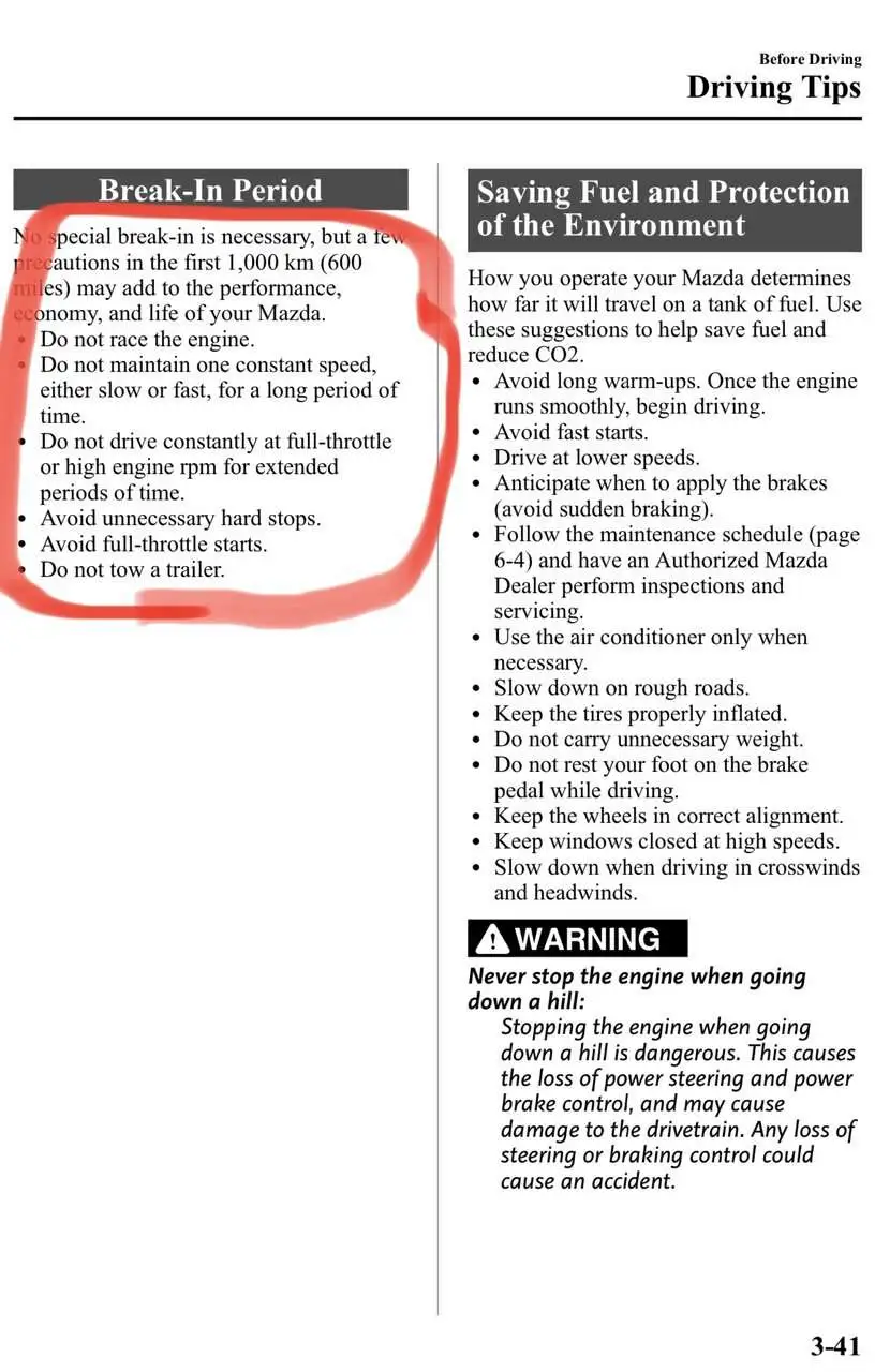

From our Mazda:

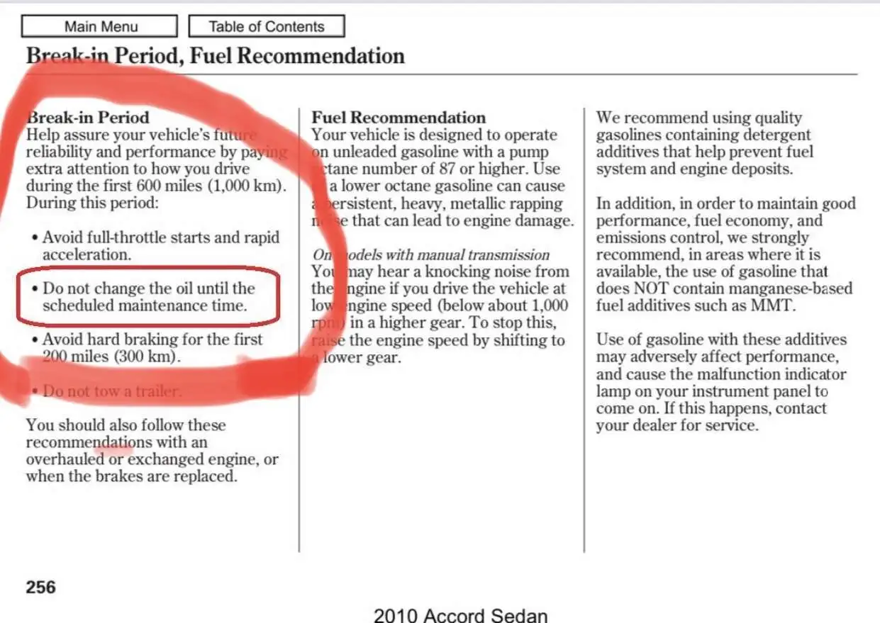

From Honda:
When it comes to the official recommendations on engine break-in, especially the bit about not changing the oil early, you can chuck that in the bin and watch this:
The message: don't wait to change the oil. Clean oil reduces wear during a time when the engine is experiencing more wear than any other time in its life.

When it comes to the official recommendations on engine break-in, especially the bit about not changing the oil early, you can chuck that in the bin.
Agreed. At the very least, change the oil filter after the 5000km break in process. There will be some metal shavings in there.
if you run the msds sheet it comes back made by Conoco oil company.
