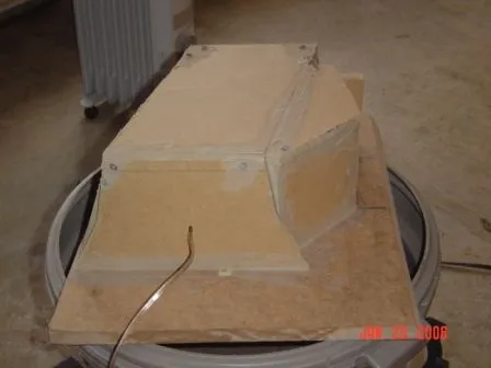

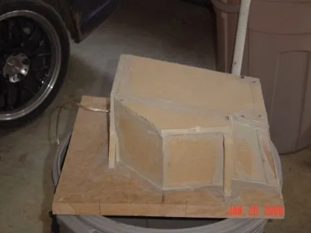

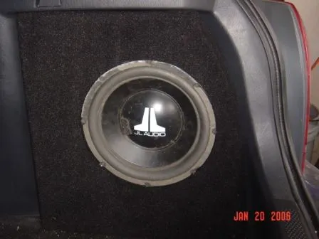

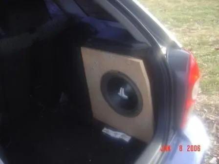

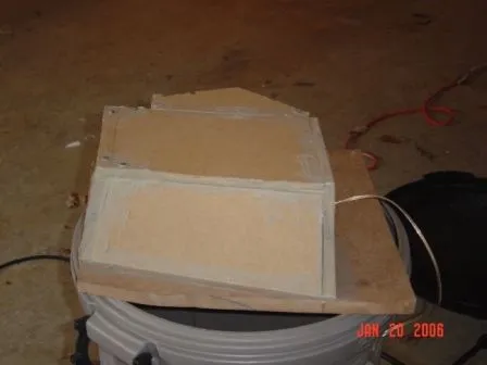

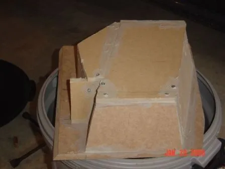

Ok so I built this box for my P5 a few weeks ago. Finally got around to tossing some carpet on it today. A few different people asked for pics of the box so here they are... keep in mind this was a first attempt I could make it alot cleaner if I did it again. But it sounds awesome so no need to rebuild it.

You get an A+ for your woodworking skills. Many people have made similar enclosures using fiberglass to maximize airspace but this is the first all wood (or MDF rather) box I've seen.
The airspace looks kind of small. Do you know how big it is (cuft)?
Thanks... it was a challenge, but I have much more experience with wood than fiberglass... Liquid Nails will make anything work. My airspace is about .4~.5cuft... So its almost perfect for an old 10W6.
A little on the small side (I thing most JL 10"s need .6-.8) but if you send it plenty of power it will hit real hard.
You are correct, but I polyfilled the box (I poly fill every box I build tricks the sub by cancelling the internal sound waves) and it sounds great. I just got an old Zapco 100x2 1ohm stable amp. Too bad I am only running 3ohms... That thing is a beast.

ya, nice job...i'd like to do something like that too! i've got a box i did, but it takes up so much room...i was concerned about the sir space...did you cut out the plastic behind the box?
No if I take out the box I can put the cover back and its just like stock... thats why it looks as bad as it does in the pics.. But it actually sounds better than I expected.
