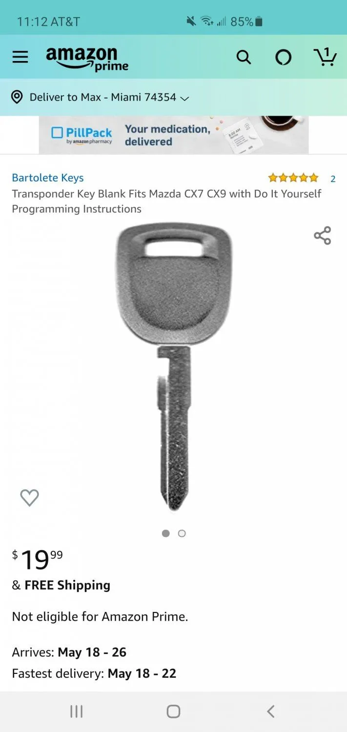

Nope, no insert in the bottom right corner. Its missing, had I known what I know now I would have got the price down even more when I bought it. So when you say smart key, do you mean a key with a transponder chip in it? One that I can get cut and programmed to the car? My car still has a traditional ignition but just has the plastic cover over it i can remove and insert a key. My question is, if I get a key with only a chip not a whole keyfob have it cut and programmed, will it start the car. I was told be the dealership I need one that is $345, $125 to program, and $74 for the key blade insert. Attached a photo so you can understand better, I'm wondering if I can get a uncut like the photo that says it fits the 08 cx9 have it cut and programmed. I'm beginning to think I'm losing my mind, there is too much info out there that conflicts, I just want a key that will start the engine and manually unlock the doors. Lol

My car still has a traditional ignition but just has the plastic cover over it i can remove and insert a key. My question is, if I get a key with only a chip not a whole keyfob have it cut and programmed, will it start the car. I was told be the dealership I need one that is $345, $125 to program, and $74 for the key blade insert. Attached a photo so you can understand better, I'm wondering if I can get a uncut like the photo that says it fits the 08 cx9 have it cut and programmed. I'm beginning to think I'm losing my mind, there is too much info out there that conflicts, I just want a key that will start the engine and manually unlock the doors. LolView attachment 224555 key
That dealer pricing makes sense for whole new smart-key, programmed and cut. Yes you can do as you say and just get a key cut. You will have a light or two lit up on the dash as the car will keep telling you that it doesn't see a smart-key and there is a security issue, but sounds like you don't care about that.
