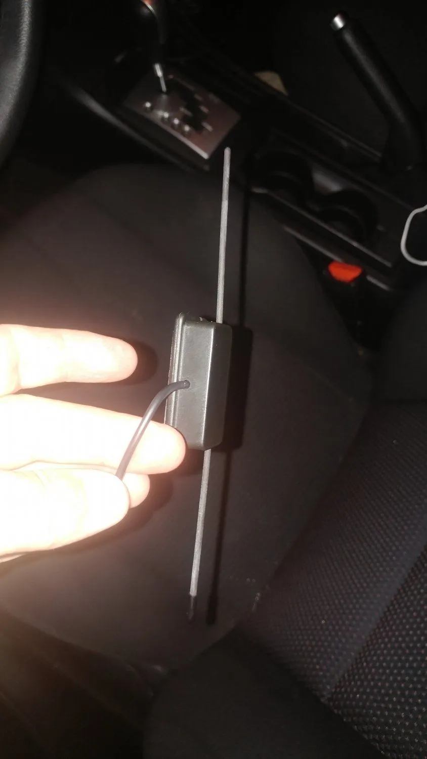

Found this...it looks aftermarket to me....not sure what it is for, but internet sluething says most likely remote start.
And yet another twist. So, my daughter claimed there was nothing in the glove box...but of course, I checked to be sure...and found the MAZDA Remote Start/Security Accessory manual.
So maybe that antenna box is OEM?
I would also need a special remote start Key Fob?
I'm hoping the plain 3 button ones I ordered will work. We don't care about the remote start or anti-theft.
Yep, found the full install manual on-line and it has that antenna box pictured in it. So I guess it is OEM afterall.
