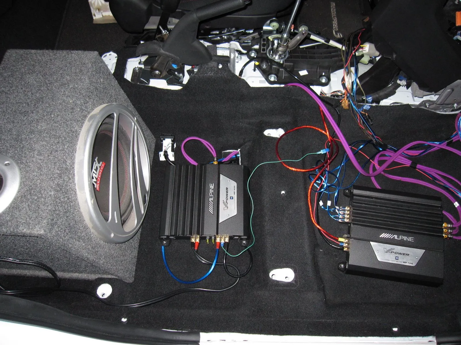

I don't have ground loop issues, I was just trying to figure out the best signals to get out from the Bose HU. And figured out I did, lol. Since the signals from the Bose HU are already line level, albeit "balanced" line level, I simply cut off one end of RCAs and tap them into the HU signal wires. And it worked beautifully, signal was clean and strong. I did a full hook up test, it sounded so awesome.
