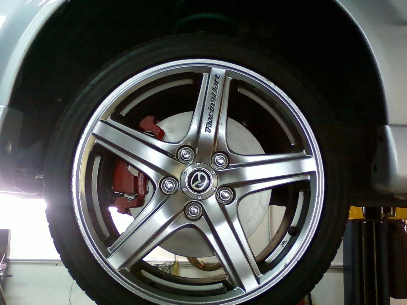

i got 07 mazda 6 brakes and i got new downpipe pics

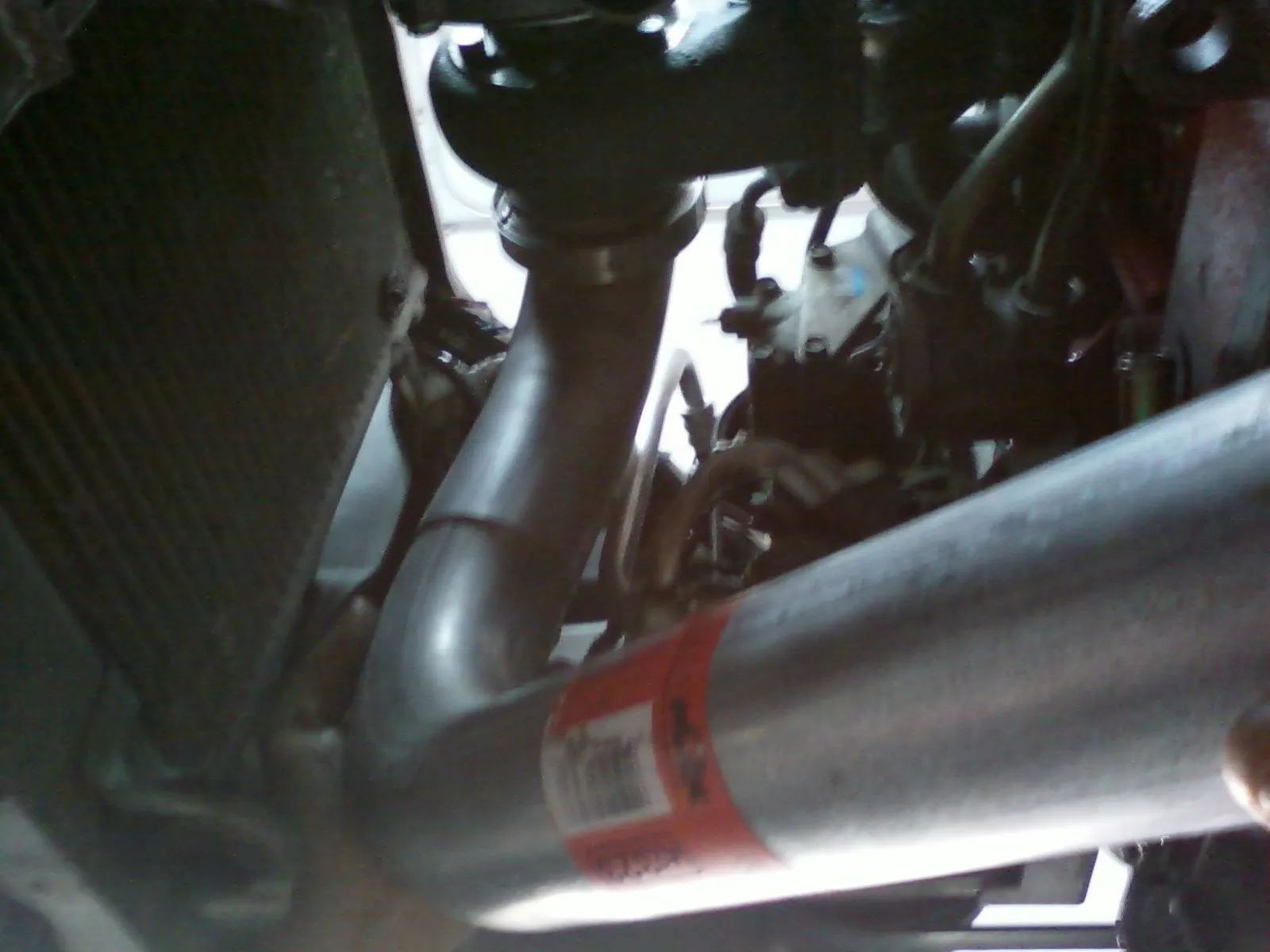

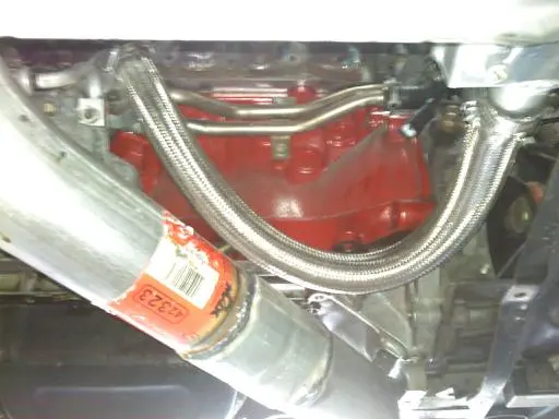

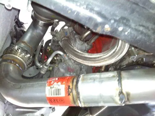

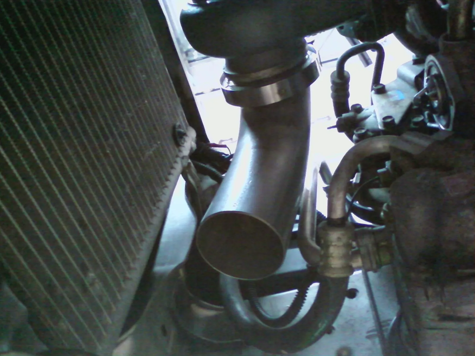

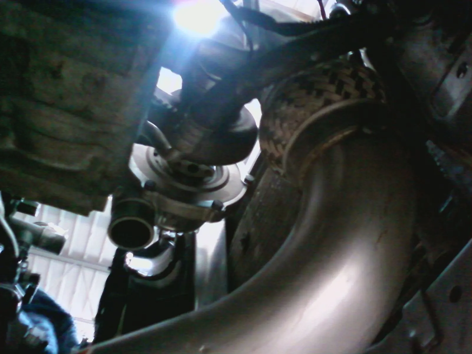

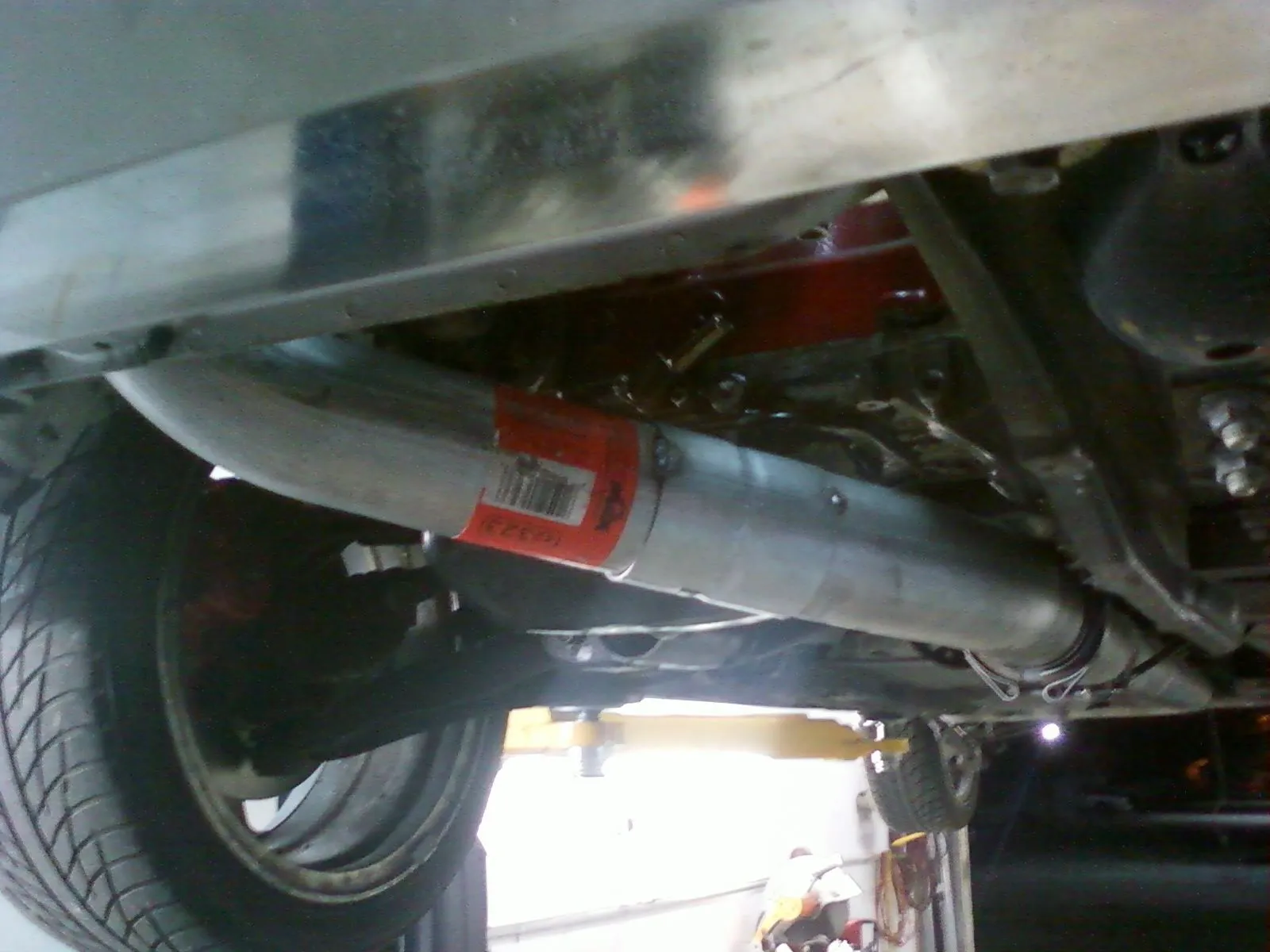

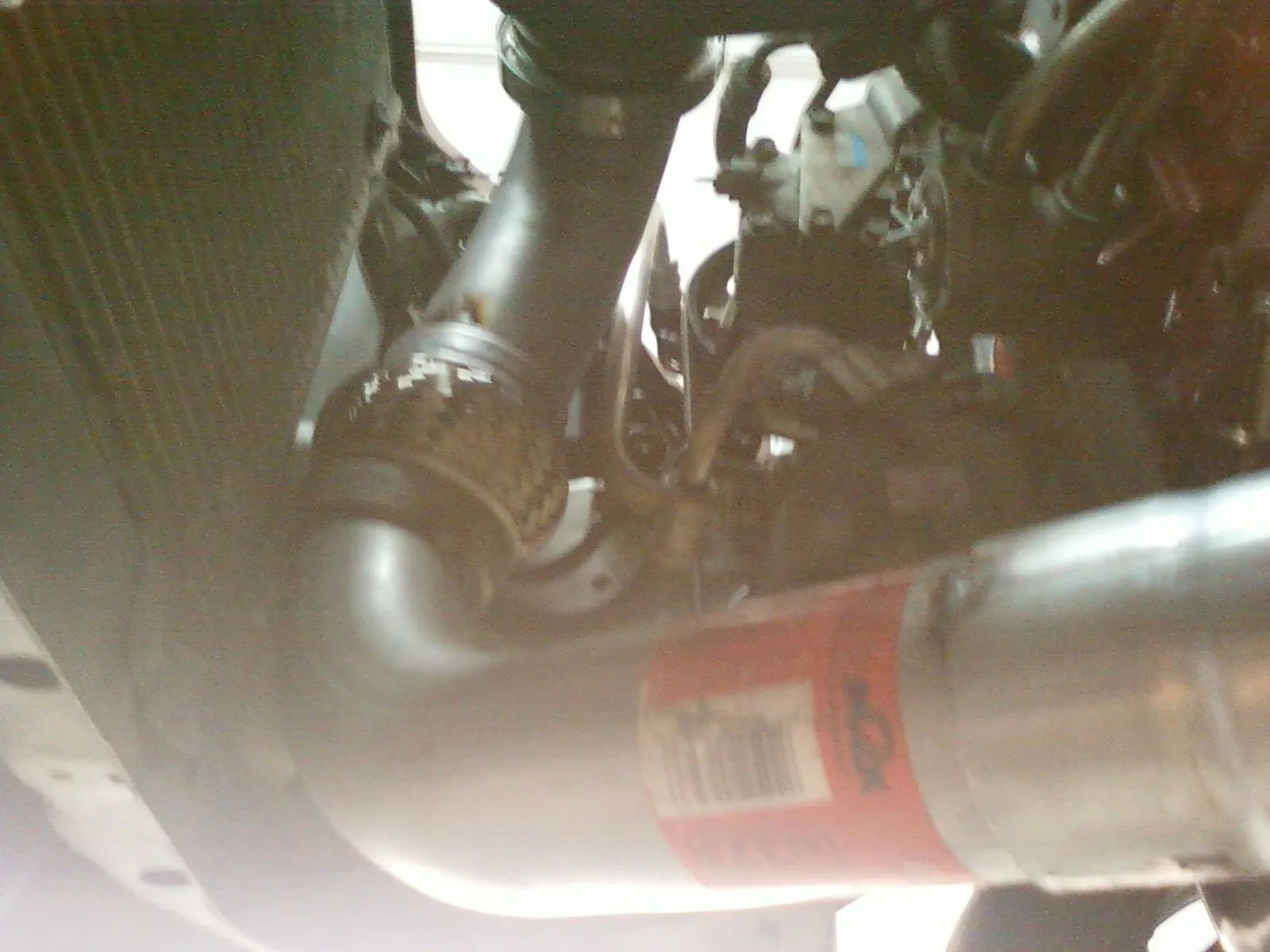

ok everyone sorry for not posting on here in awhile but the downpipe and radiator line is finished pics are up !! comments and opinions welcome!!
Make one for stock turbo flange and mass produce! That is my comment.
edit: NVM gt30 is t2 flanged isn't it? lol.
so i see no one's asked this question but what are you going to do about your oil feed and return line? since your external wastegate dump goes right over the top of your center section

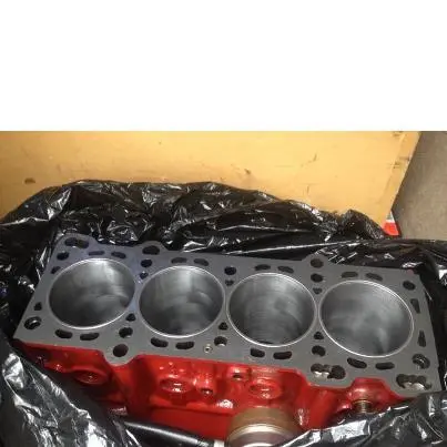

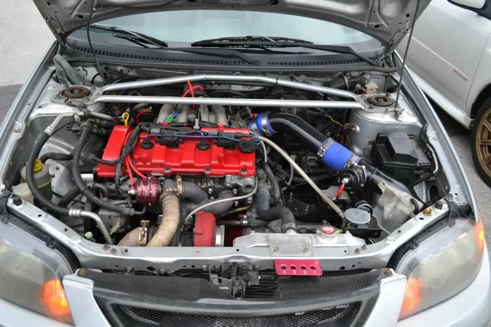

Hey everyone i know ive been a little lost and what not since school and work took over but here are some updates on the car i recently i blew the headgasket due to a waterpump failure :( BUT i decided to redo everything Asfar as Block ,pistons, Turbo ect.
The mods that i did to the block are .40 bore with A custom O-Ring Setup (will post pics)

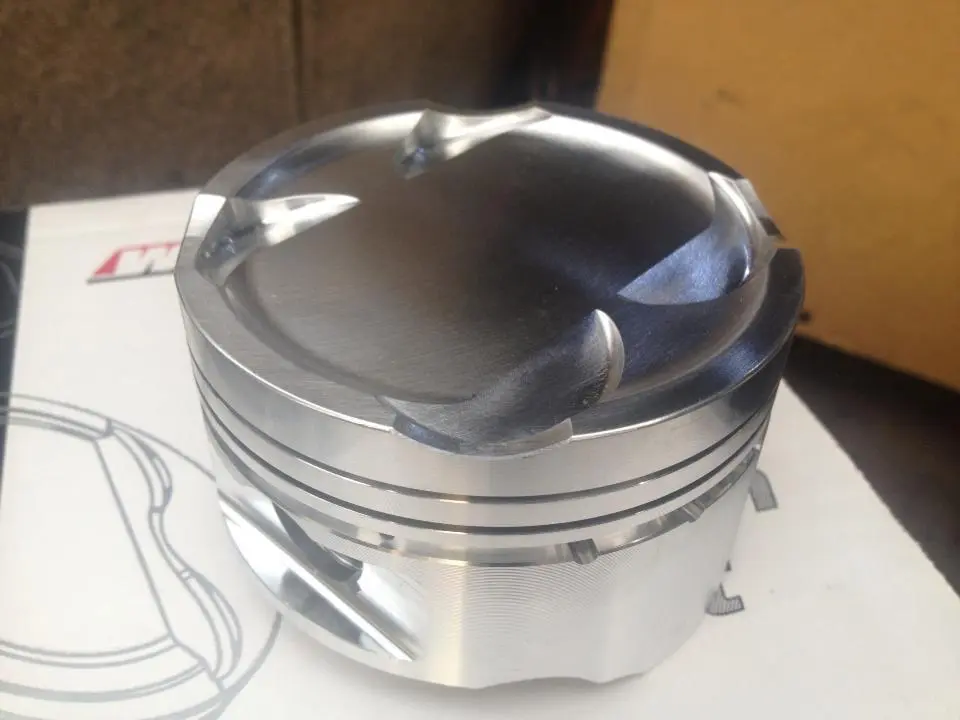

asfar as pistons i decided to do a custom compression 10:5:1 Wiseco Pistons. (will post pics)
I will be reusing the Pauter Rods Since they did hold up to the power the car was producing.
The turbo im going with now is a GTX3078r Dual BB Turbo.
Head : Custom Crower 278/282 Cams With supertech Valvetrain
