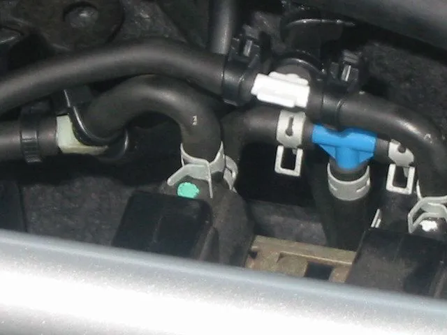

I have the autometer ultralite mechanical boost gauge and greddy profec b-spec 2. I hooked up to these vacuum lines and neither one is reading boost, only vacuum. Please help!

It looks like you tapped into the wrong vacuum source.. The ones using those 2 solenoids on the passenger side of the intake manifold have 1 way check valves on them.
You'll need to tap into the line that runs to the throttle body, or you can tap into the line running to the manifold side of the fpr solenoid.
Let me know if that fixes it.
