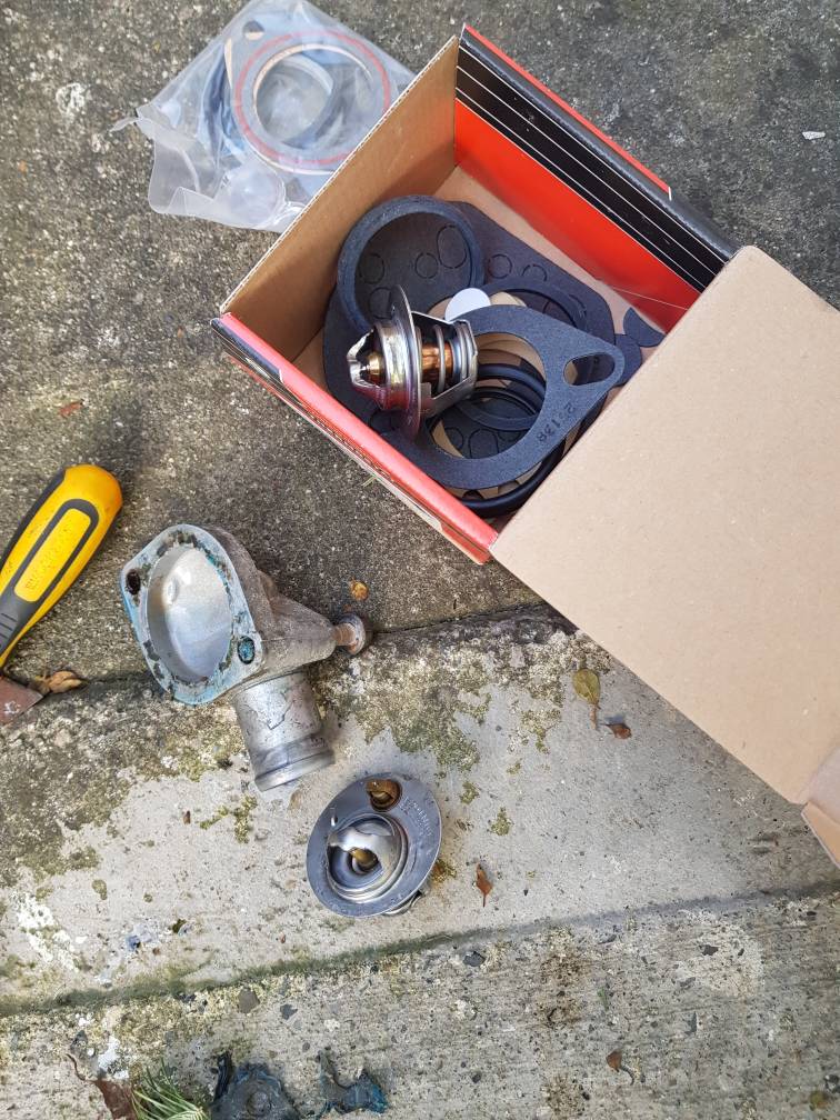

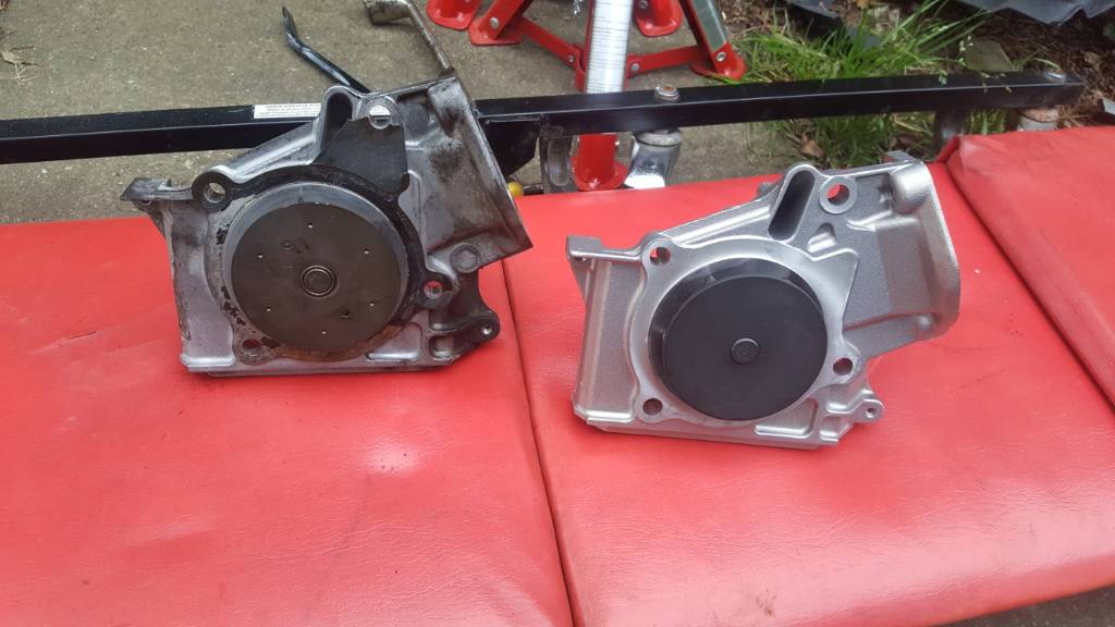

Check your dip stick if theres coolant on it its a head gasket problem, if not it could be a faulty water pump or faulty temp sensor if your replacing that you might aswell do the timing belt and full coolant flush aswell just to be safe. Start with the simple stuff before getting elbow deep in a riming belt replacement.
Ive 2 photos of the temp sensor that needed replacing on mine and the water pump.
