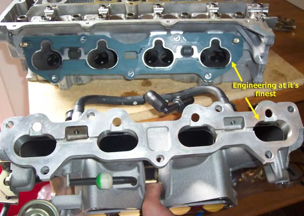

While you have your intake mani apart, port the extra lips near the flange that bolts to the head...
If you don't have an MP3, you have butterflies in the way there; You could fix that like I did! To be fair, I didn't remove my own butterflies, but I filled the holes where the butterflies passed through the intake, and port-matched the intake manifold to thet gasket with a slight taper. Helps quite a bit on the high end, I must say! Here's the pic of the manifold just before the final touch-up stage:
Yep. Trumpet style, but with a longer progression. I'll need to get the head gasket matched, too, at some point, but that's once I get a new head, and all that.

Pardon me; I need to get the head's ports matched to the gasket as well. =) I mangled the language a bit there. Hehe.
