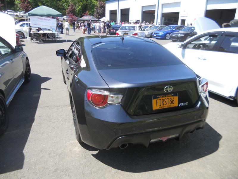

I saw a Fr-s at a car meet last saturday, and you can build your own Br-z now. Brz has been released as far as i know, i didnt think the fr-s was until mid summer but there was one there. it was definitely it too! amazing looking but i agree, they have much more potential!

Cool, I haven't seen either of the Toyobaru twins in person yet. They seem nice and small from pics and are supposed to be uber light. Could be really fun. I have to go drive one when they become more available.
