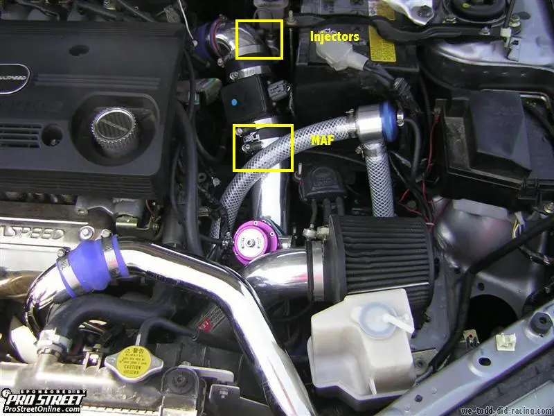

would this be ok ? (see modified pics)
my BOV seems to be at the same place. id have to fit the MAF and my 2 extra injectors in there ... so would that be ok ? or i have to redo that pipe and put the BOV further away from the TB to make sure the maf and injectors are ok ?

yes but i think all 3 things will sit a bit closer to each other un my case. your injectors seems to be a couple inches away from each other. i dont think i'll be able to give them that much space

I moved my MAF a while ago and the car is running great. Really smooth acceleration. My new setup will have the MAF back on the intake side... but now I have DSM's AFC. I am interested to see what the car runs like. After driving with the MAF on the pressure side so long, I should be able to notice a difference if there is in fact one. With the AFC I think my prior issues would be solved (the reason I moved the MAF), and I think the car will still run smooth. I will also be recirculating 100%, no BOV.
My setup can be viewed here... where some of these pictures came from.
http://www.msprotege.com/forum/showthread.php?t=105437
I dont think i can do the blow threw MAF, because my blow off valve is only about 8 or 9 inchs from where my pipe bends into my TB.......damn
