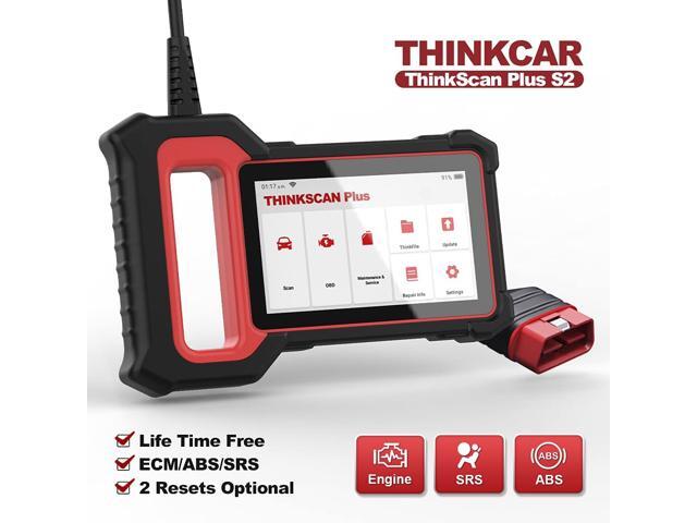

Looks like $198.60 on my computer on the US site.
Confirmed at 198.60:
find all the Thinkcar products here:
you can find PLENTY of sellers here:
129 being the cheapest as of this post:
some random dropship seller on newegg:
also an Amazon seller:
