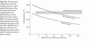

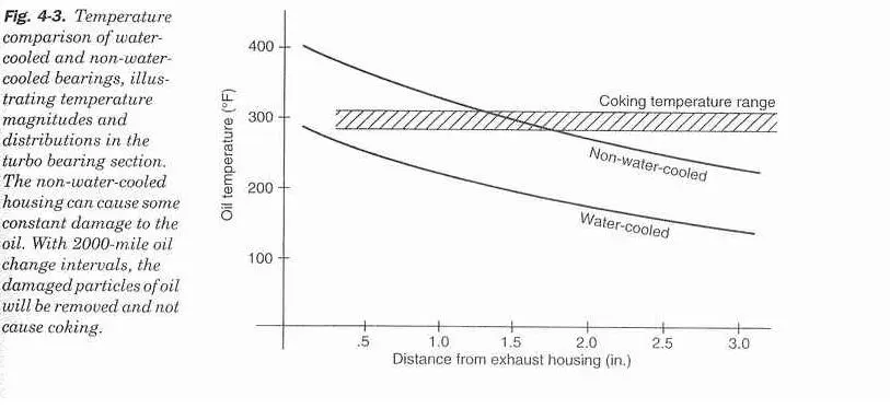

What do you make of this, from "Maximum Boost", by Corky Bell? My impression is that the turbo, under normal operation (normal daily use), doesn't get hot enough to coke.

Not sure what's meant by 'distance from exaust housing', but in the case of the MS6, isn't the turbo an integral part of the exaust manifold? That would put it pretty close to the heat, so why would I want to change my oil every 2000 miles to avoid a condtion that synthetic oil could eliminate?

I wish I knew the answer about the distance from the exhaust housing ....
So, if I look inside the oil cap all I see is timing chain and casting. It is spotlessly clean in there. Too bad it's not so easy to look into the turbo center housing .... I want to believe it is sufficiently cooled to prevent coking, especially since the car isn't driven like it's a race car.
