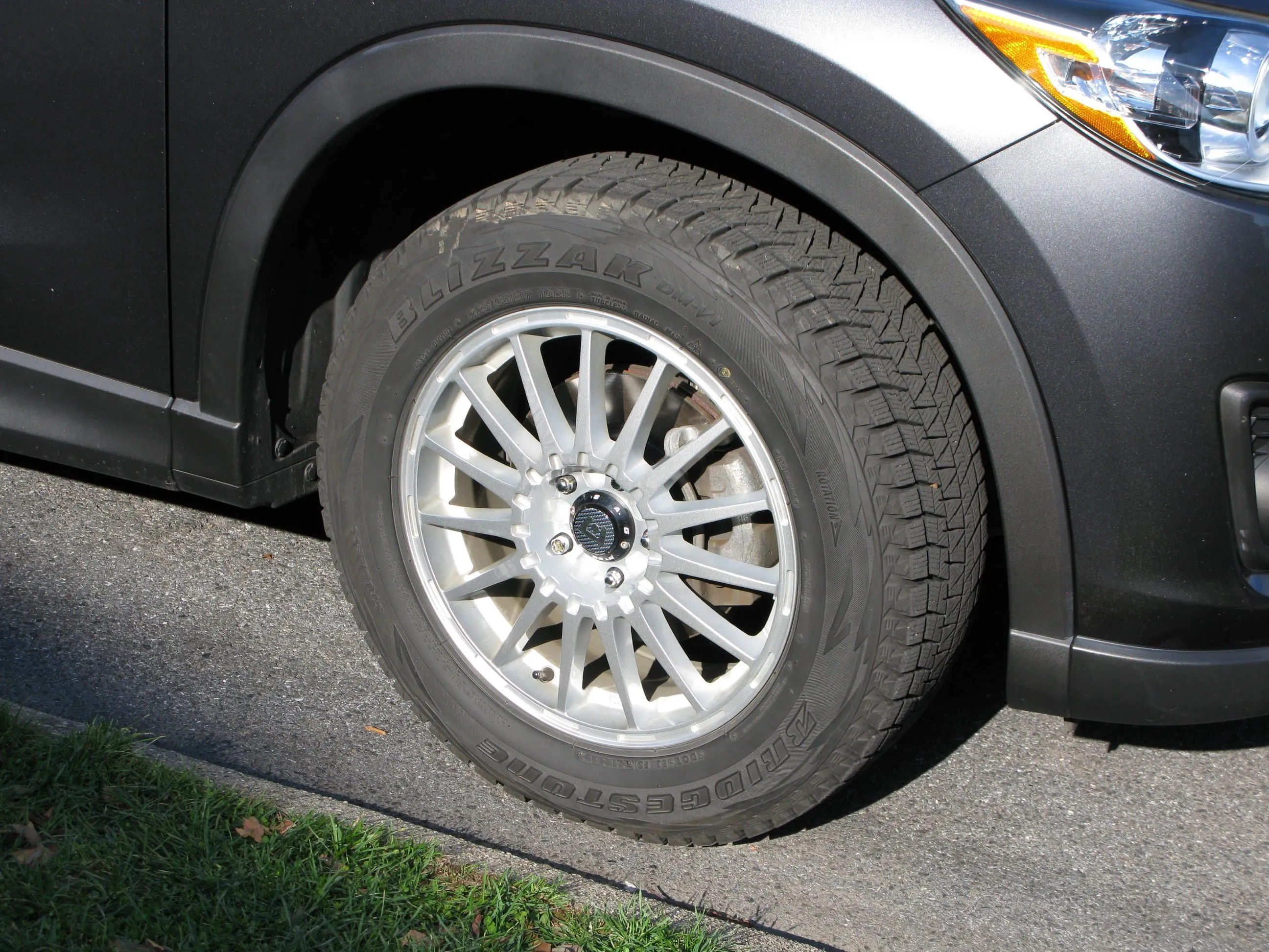

39 is good, have my DM-V1s on my 3rd season. Great choice on your part. Snow tires are like insurance, you hope they're not necessary, but you're sure glad they're on when it counts the most, during bad weather. IMG_2838.webp
Kedis, when I bought my 225/70R16's (X-Ice Xi2's) at Tire Rack last year, they recommended 38psi, so I think you're in the right ballpark.
One question on your info in post #11. Your link takes me to a 225/70R16 size but your chart is for a 215/70R16. Which did you get? Either way, enjoy your CX-5's new shoes.
I believe the owners manual says add 4 pounds for snows..
Kedis, I am sure you will like the tires. If I remember correctly, I kept the pressure at 39.
By the way, these are 225s so your speed will be pretty close: 65 speedometer is about 64.23 actual.
