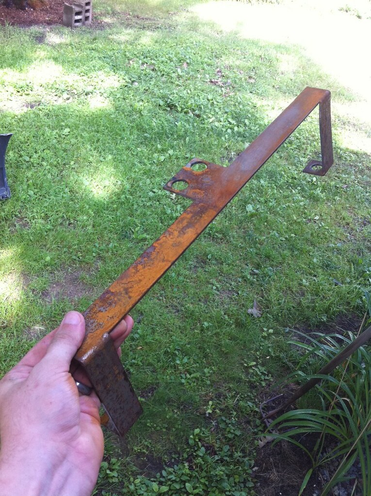

For those that haven't installed yet, it is highly recommended you paint the bracket...
I put my front mount on probably 2-3 weeks ago now but I noticed it rusting only after a week of it being on.
I took it off and painted it with 4 coats of flat black.
(Sorry I forgot to take the after picture as I was rushing to get it all back together before rain)

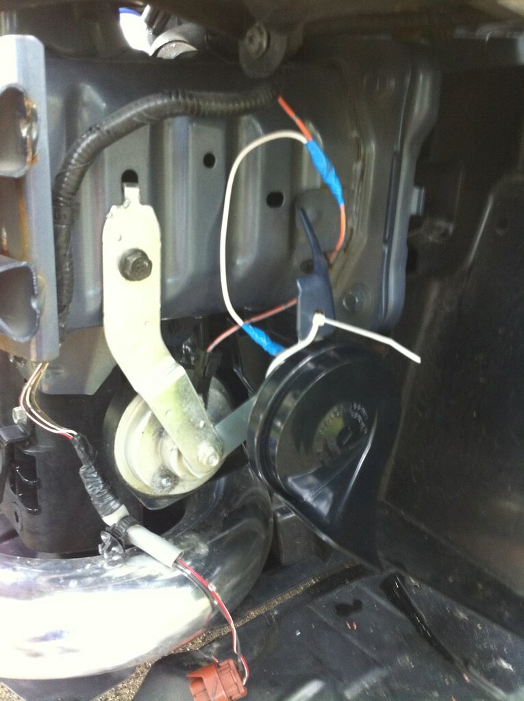

And those that were having the rubbing issues with the lines that you have to move (power steering?) to put a hot pipe there, this is what I did to make sure it wasn't rubbing.
It is just zip tied through the bolt hole in the bracket to a hole in the radiator support.
Also installed a low tone horn!
