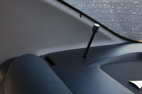

success installing the damper knob extensions! i must thank mspeedP5 for the inspiration...

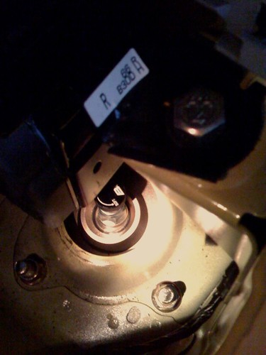

here's the seat belt housing before the install. clearly blocking the knob at the top of the damper.

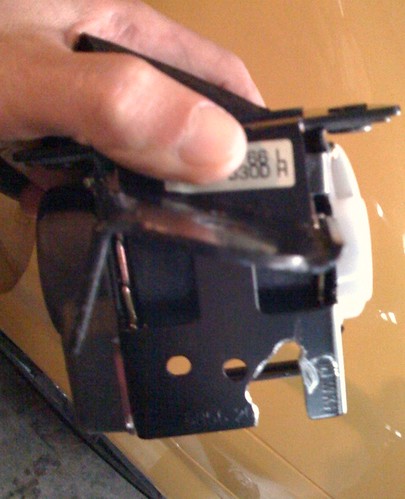

i removed the housing and, using a dremel tool with a circular blade attachment, cut a sort of triangular piece out of the back of the housing... as seen at the bottom of the picture. i actually widened it a bit more before the install. this is a shot of the first one, which was a little sloppy. the second one was much cleaner after i had some practice butchering the first! but it's function over form here since no one will ever see it once installed. i also don't think that removing this size piece of the seat belt housing damages the integrity of the housing or compromises the safety of the seat belt at all.

i then attached the extensions to the knobs and reinstalled the seat belt housings. i drilled a 5/8" hole about 3" from the side and about 4" from the front edge of the panel under the rear windshield, and threaded the extensions through as i put the panel back in place.
and we're done! now i can easily adjust the rear dampers for various driving conditions.

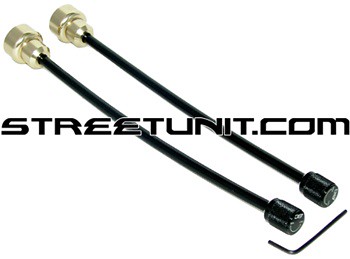

they are VERY simple. the bottom of the extension is just like a cap that goes over the damper knob with a screw in the side to tighten it on.
