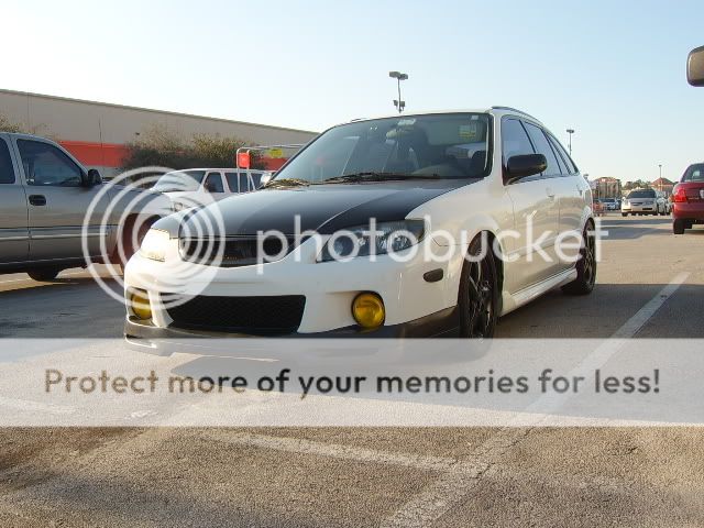

recent pics. another quarter inch drop in the back

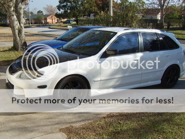

update: I dont here anymore clunking.. didnt do anything besides lower the back a lil more... o well. loveing them more everyday. good luck with the seat belt thing dude... i still havent put back all of the trunk trim..let me know how it works out incase it happens to me..o heres a pic of newly painted lip
need to be lower ;)

TWISFM, looking good, buddy! if there is no clunking, i'd leave it where it is. but yes, i know, we all want to go lower..... the drop out of the box was pretty nice, i must say. i'll post some photos soon.
