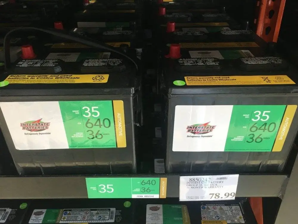

A different size battery could change things for you. The group 35 is pretty reasonable at Costco.

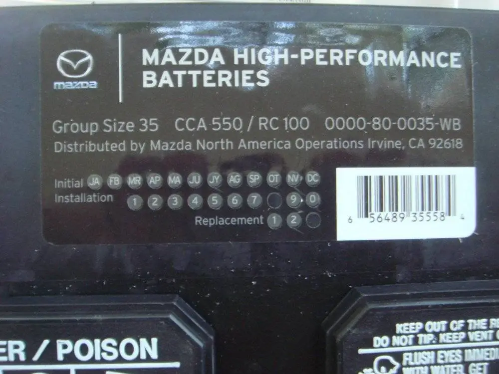

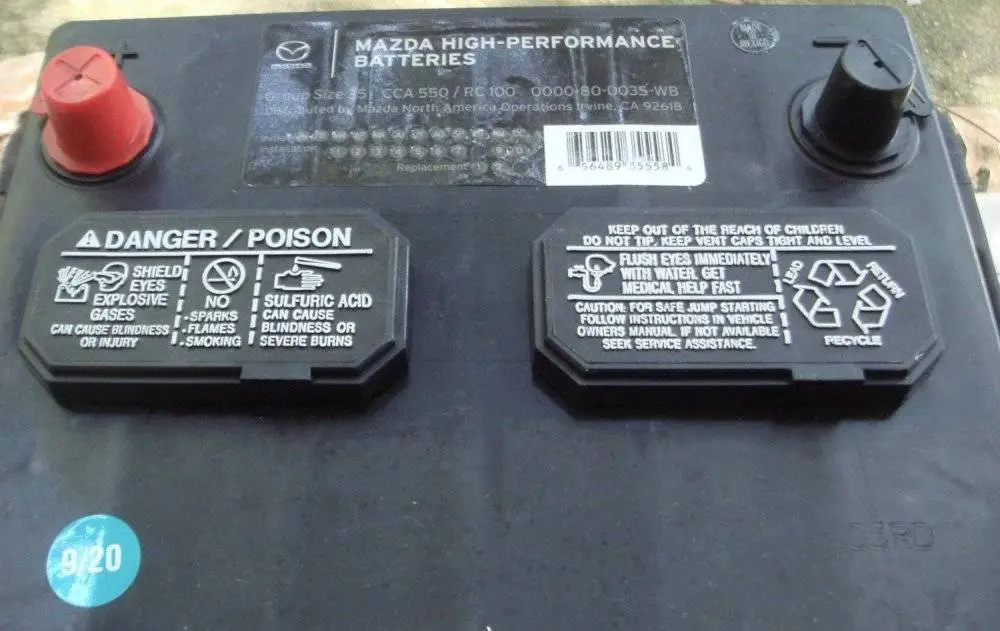

Correction: I checked the battery this morning, it is a Group 35 but it's rated at 540 CCA. That seems low. I guess the Group 35's come with different CCA ratings.
Another thing I noticed is there's a lot of white powder all along the tiedown strap. None near the posts. Is the powder dried battery acid? How is it leaching out?
I think the white corrosion is usually a reaction of the acid on lead terminals. I don't know what dried acid would look like.
Yes, Mazda OEM Group 35 battery made by Interstate has 550 CCA, while the Interstate Group 35 battery sold at Costco has 640 CCA.
The white residue on metal battery tie-down is caused by the battery acid leaking out from the cell caps. The acid overflow usually means either the electrolyte level in battery cells are too high, or the battery got overcharged due to the weak or defective battery, or unstable alternator.
I certainly would want to get that OEM battery replaced if I were you, even just because the leaky acid which has corroded the battery tie-down. A good lead-acid battery should not leak and corrode terminals and the battery holder.
