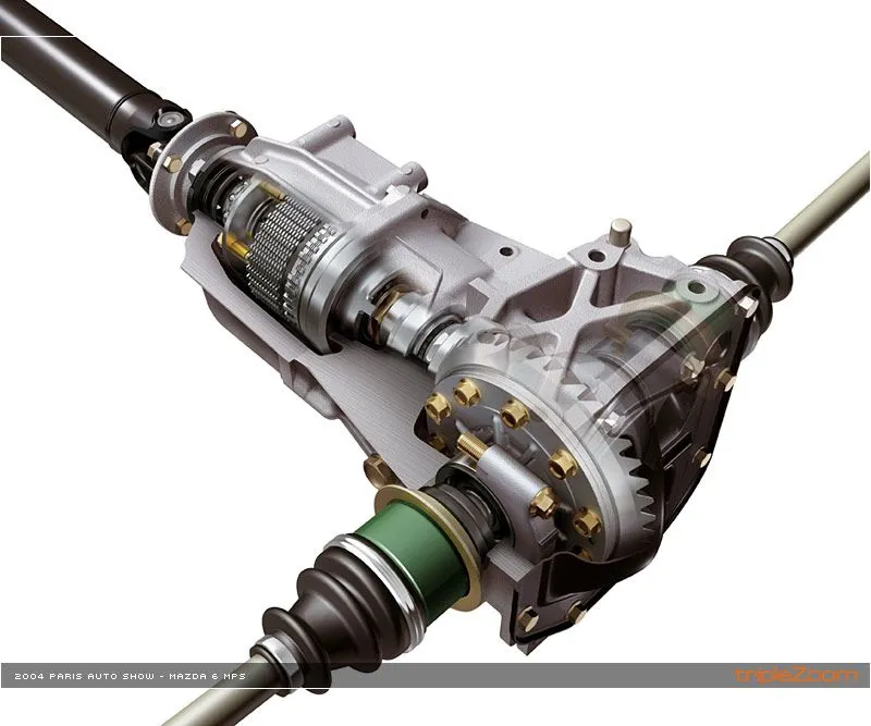

Here's a pic of the ms6 magnetic clutch pack:
awsome where did you find that pic? I wanted to use something else lighter; but after i came to my senses i realized this would be much simpler than a center diff setup. so we need a drive shaft the power sending unit that bolts to the speed 6's and the speed 3's tranny (fingers crossed).I still need to confim what machining parts would be needed. Lastly a way to trick the rear diff into being 50/50, or close to it permanantly.

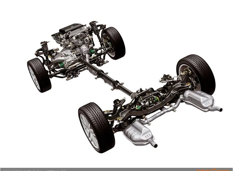

And, found another ms6 awd pic. If you are looking for ms6/ms3 info online, remember to also search for mazda 3/6 MPS because that is the name in the rest of the world, except japan.

Yes, it is a separate unit. But who wants to try and make a custom wire harness and retrofit all the sensors mazda put on the ms6 just to control the awd. Can it be done? Yeah, but it will be very labor intensive and a lot of trial and error. Too much sensor to ecu feedback and calibrations for somebody to do it in their garage imo.
